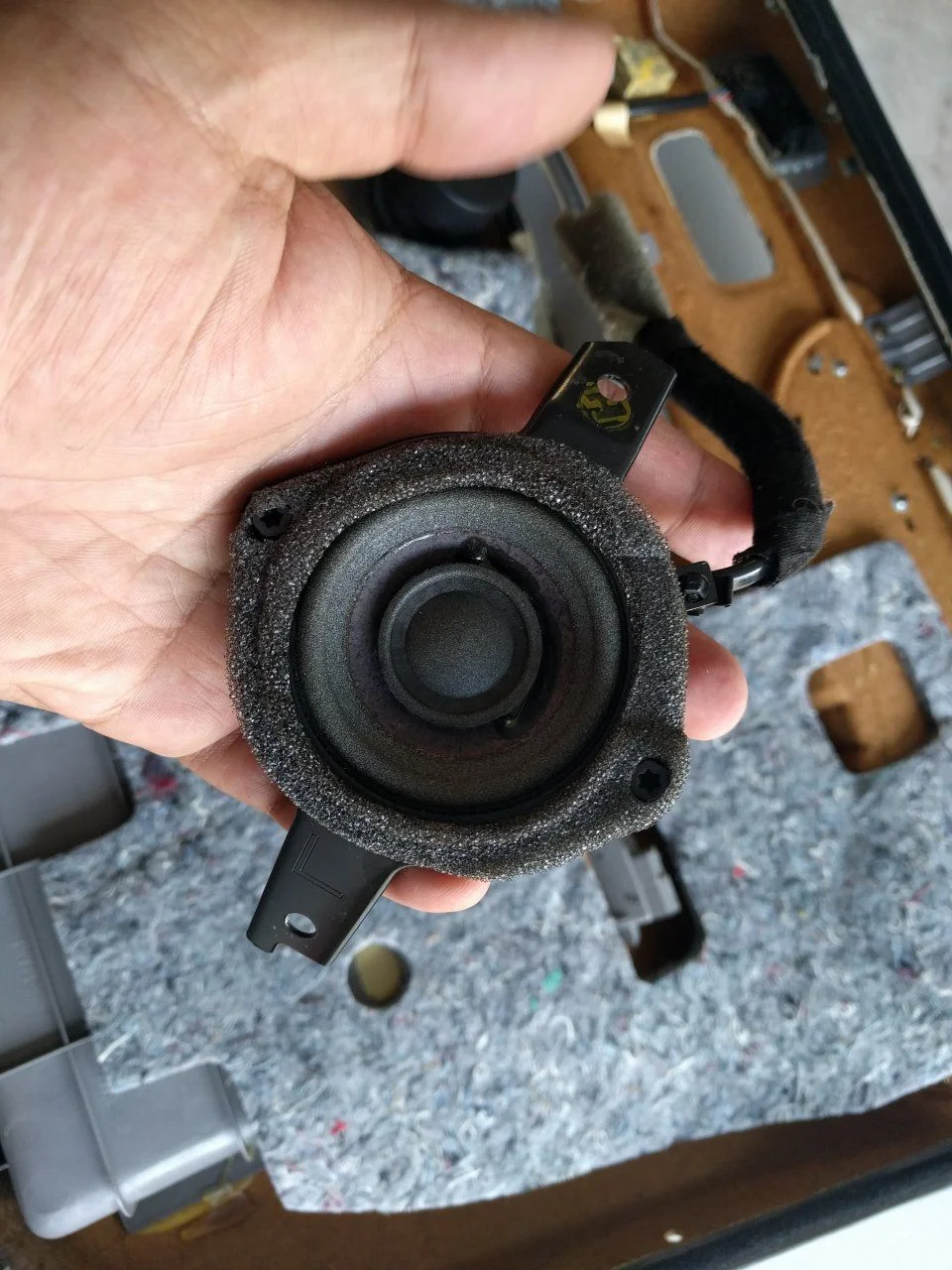

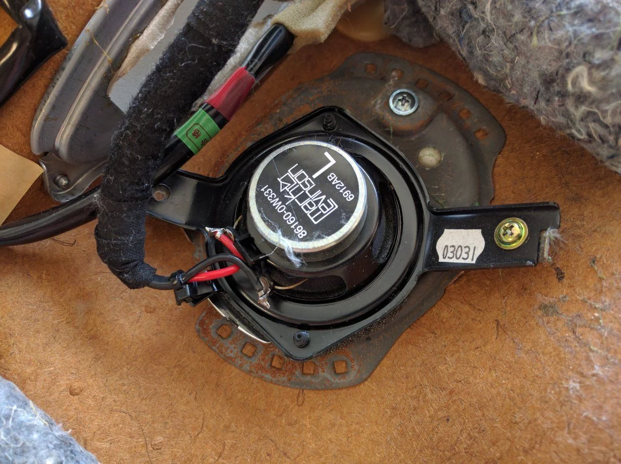

For those who've replaced speakers in your 11 speaker ML systems what did you use for the 3in front door mids?
Parts Express have a few suitable one-ways that will fit but I haven't ordered anything from them yet.
To date I've replaced the front door 6in and tweeters (no external cross over required, soldered directly to OE cables) and replaced the rear door 4in/tweeter combo with 6.25in three-ways for a significant improvement over the mixed bag of blown originals. I may just refoam the sub.

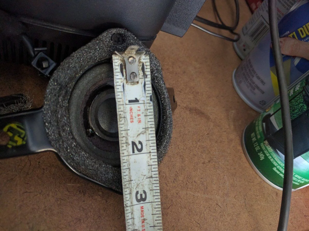

@PADDO The door ML mid range door speakers are 2.25 " speakers ( why? I do not know) I have some replacements on order and will need to construct a strap/fastener to hold them firmly in place.
I'll post up with install and final verdict once they arrive. It is mostly me being obsessive of replacing ALL the old sets of speakers.
