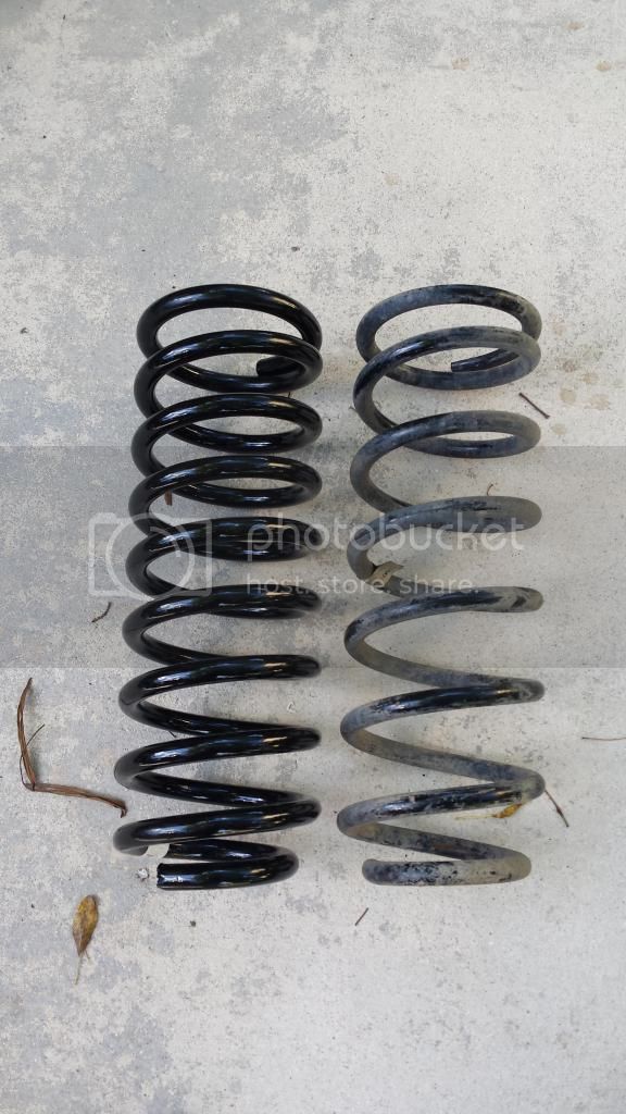

Comparison between the 850J front spring and the Dobinson front spring:

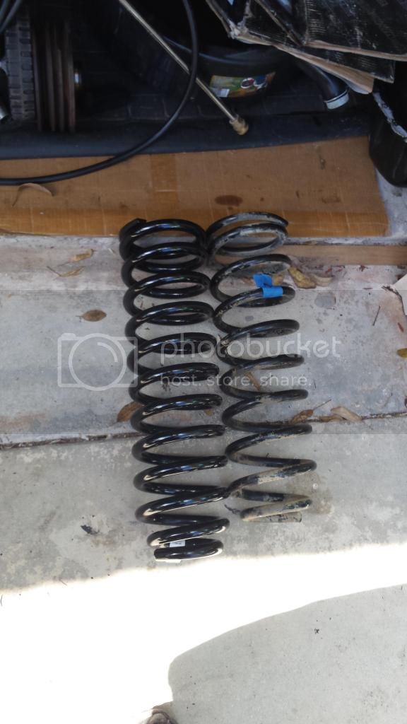

Comparison between the 863J rear spring and the Dobinson rear spring.

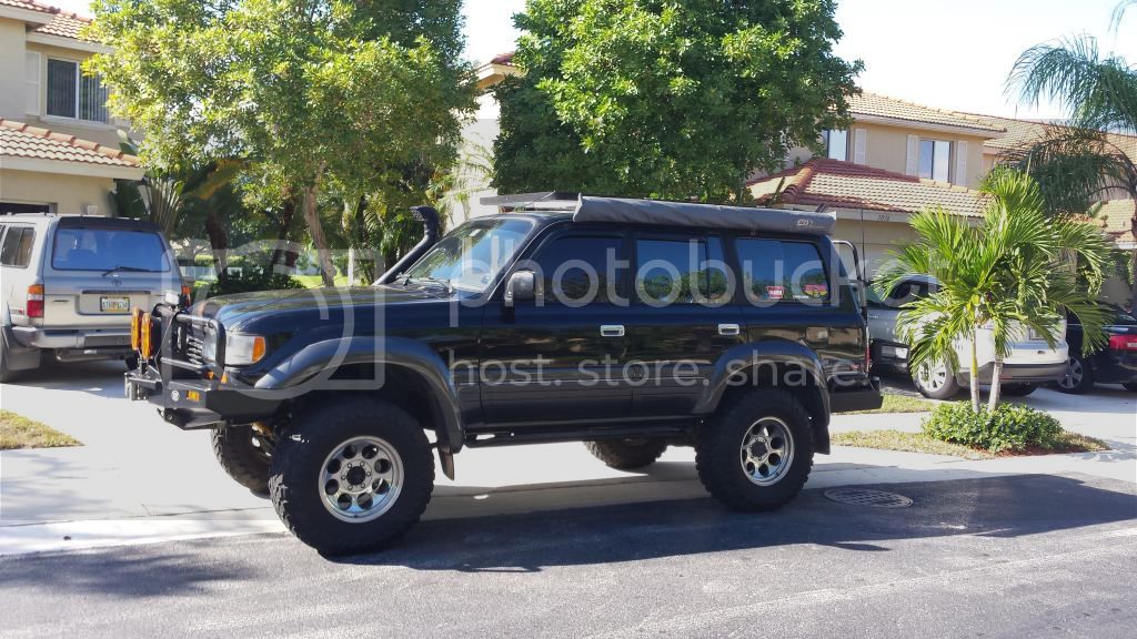

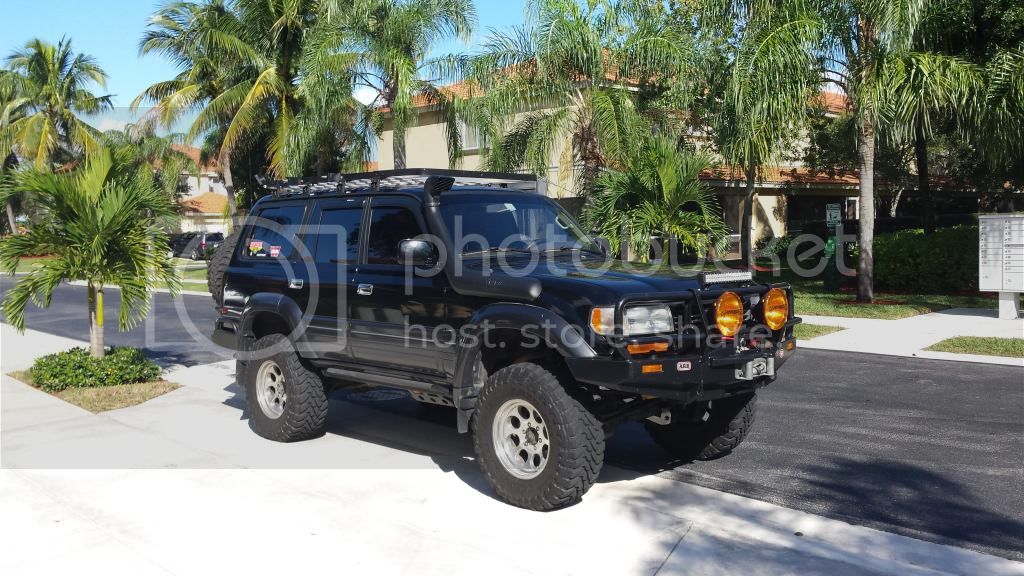

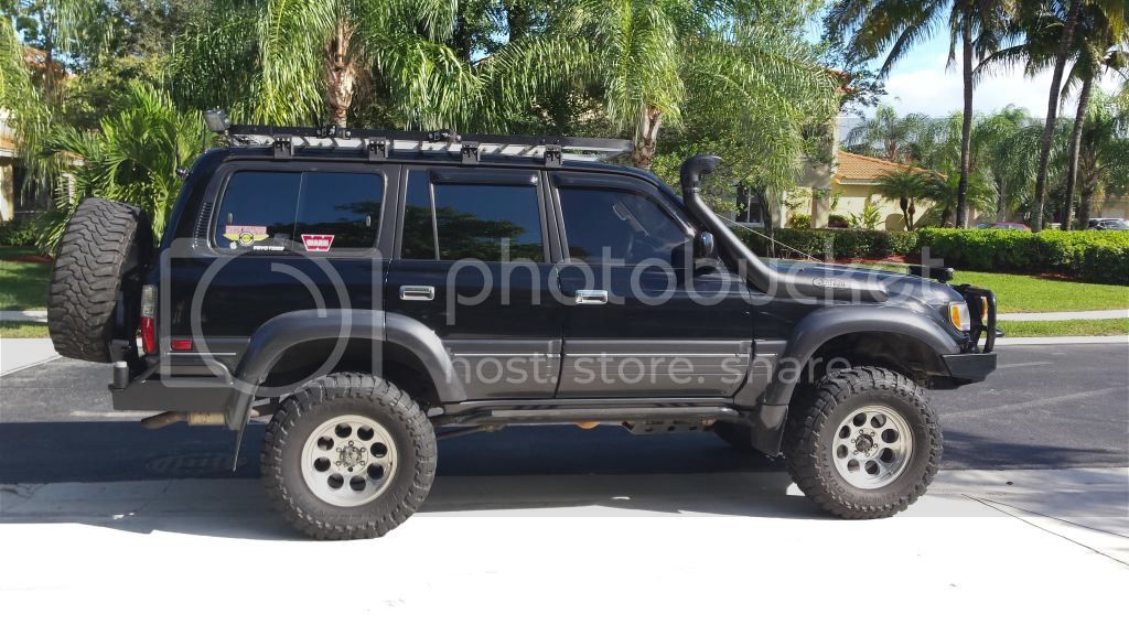

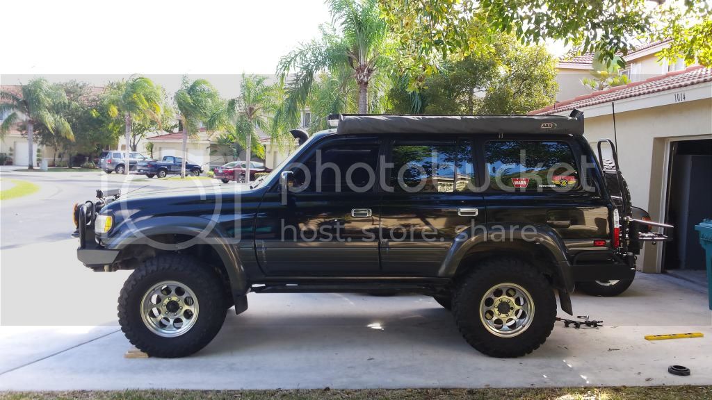

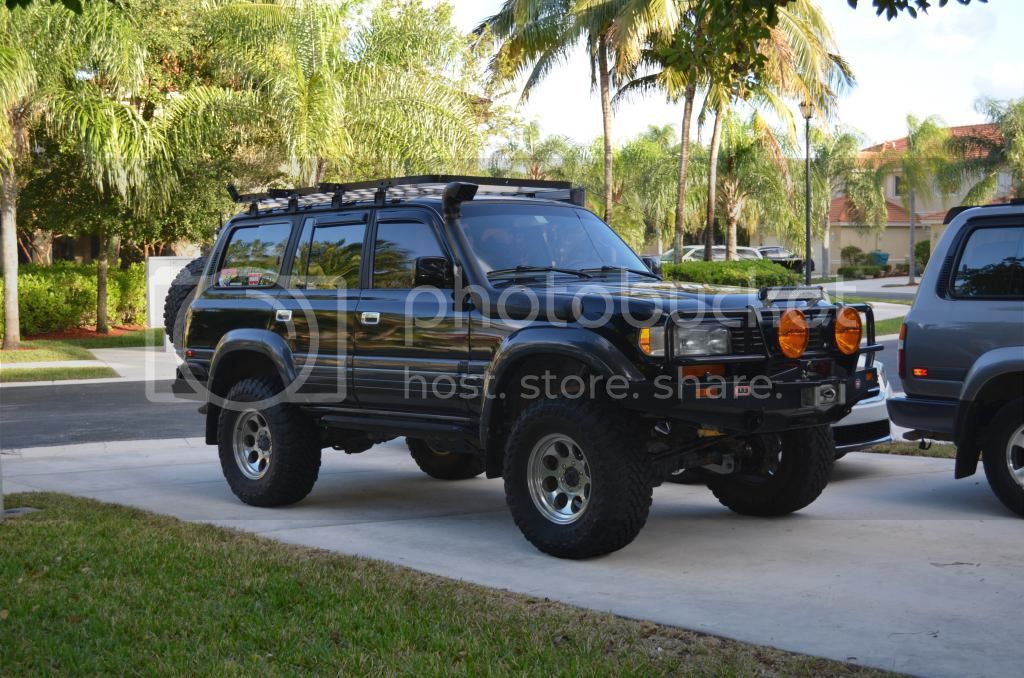

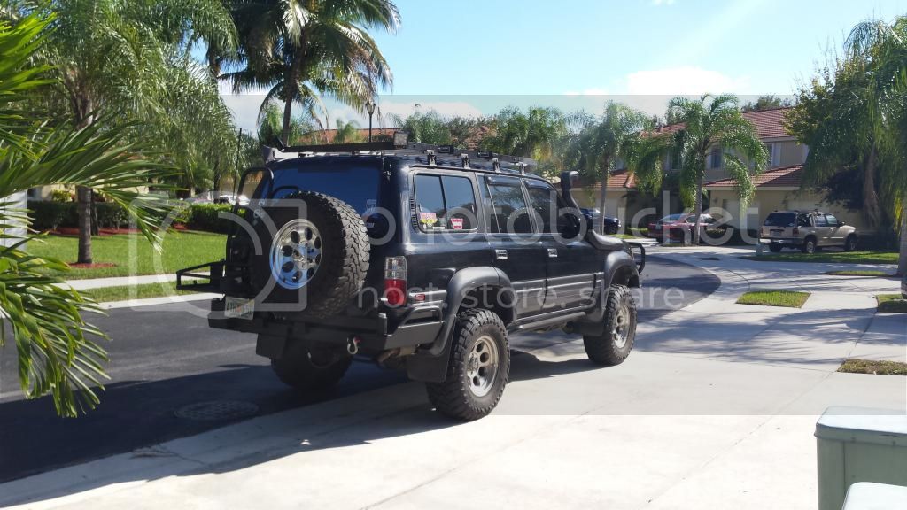

Here are the before and after shots of my rig. This lift added around 1.5" all around on top of my J spring setup with 1" spacer in the front.

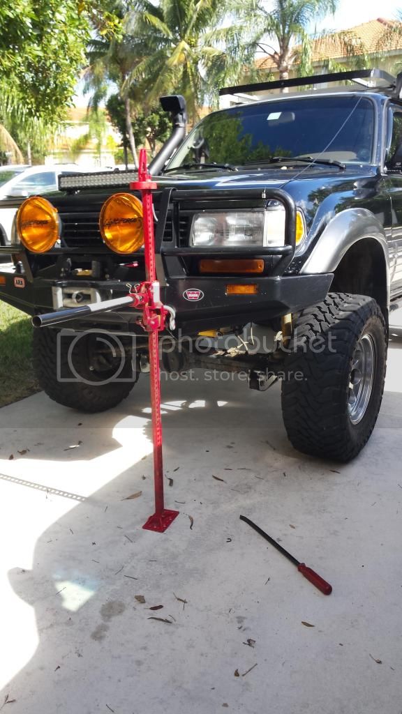

Before pictures:
No Gear
With Camping gear no rear bumper
After Pictures

Here are some specs between OME J Spring and the Dobinson spring.
Front
OME850J Dobinson
515mm Free height 555mm
220lbs/in spring rate 275lbs/in
Rear
OME863J Dobinson
505mm Free height 525mm
265lbs/in spring rate 275lbs/in
Looks great. The stance is perfect. Looks a tiny bit higher in the front. The springs rates seem to beefier for the added weight of armor/gear

BTW, that first pic is pretty scary:skull:...hoping the jackstands were pulled out of the picture right before it was taken? Hate to lose any Mudders, FWIW

great stance .. same spring rate and with that stance means your rear it's heavier than your front ..
You would be right. With the rear storage, fridge, rear bumper fullsize spare, roof rack and rtt. And then all the gear when I go wheeling
