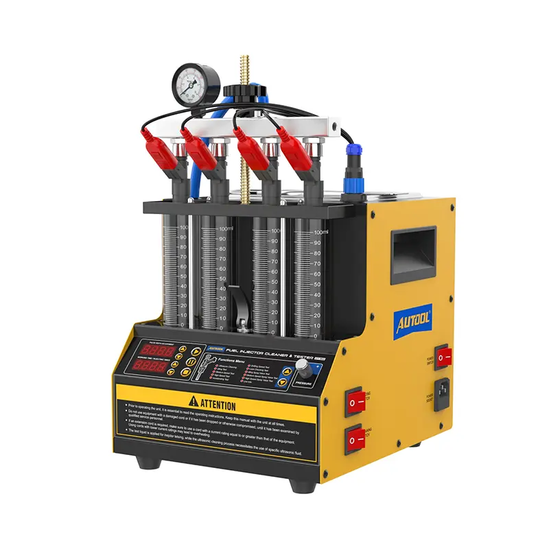

Did mine a year or two ago... got this as suggested on this forum
definitely check wires and replace connectors
Has ultrasonic cleaner, testing modes, you can see them operate at different speeds and measure volumes.
And most certainly check wires and replace connector housings. Then sell the machine if you really think you won't do this again on another cruiser.
