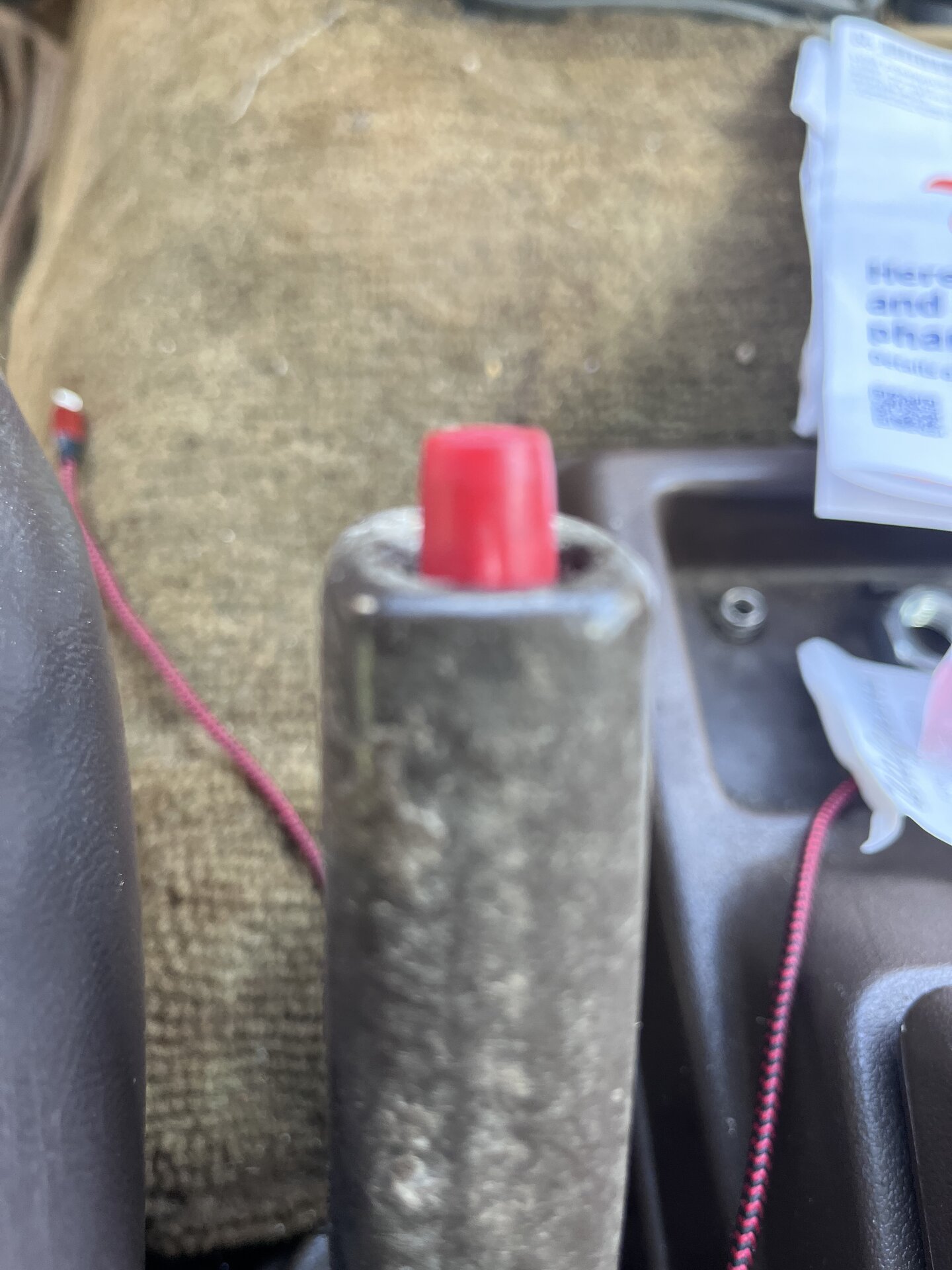

Kid at discount tine was convinced he was in a Fast and Furious movie, and snapped off the button on my parking brake lever.

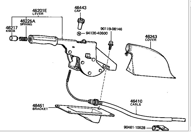

(listed as Knob - 46217 below)
It's snapped off down inside the handle exposing the threads.
I think i have a replacement sourced(Part is discontinued), but I'm wondering if there are any clever tricks to get the rest of the old out out?

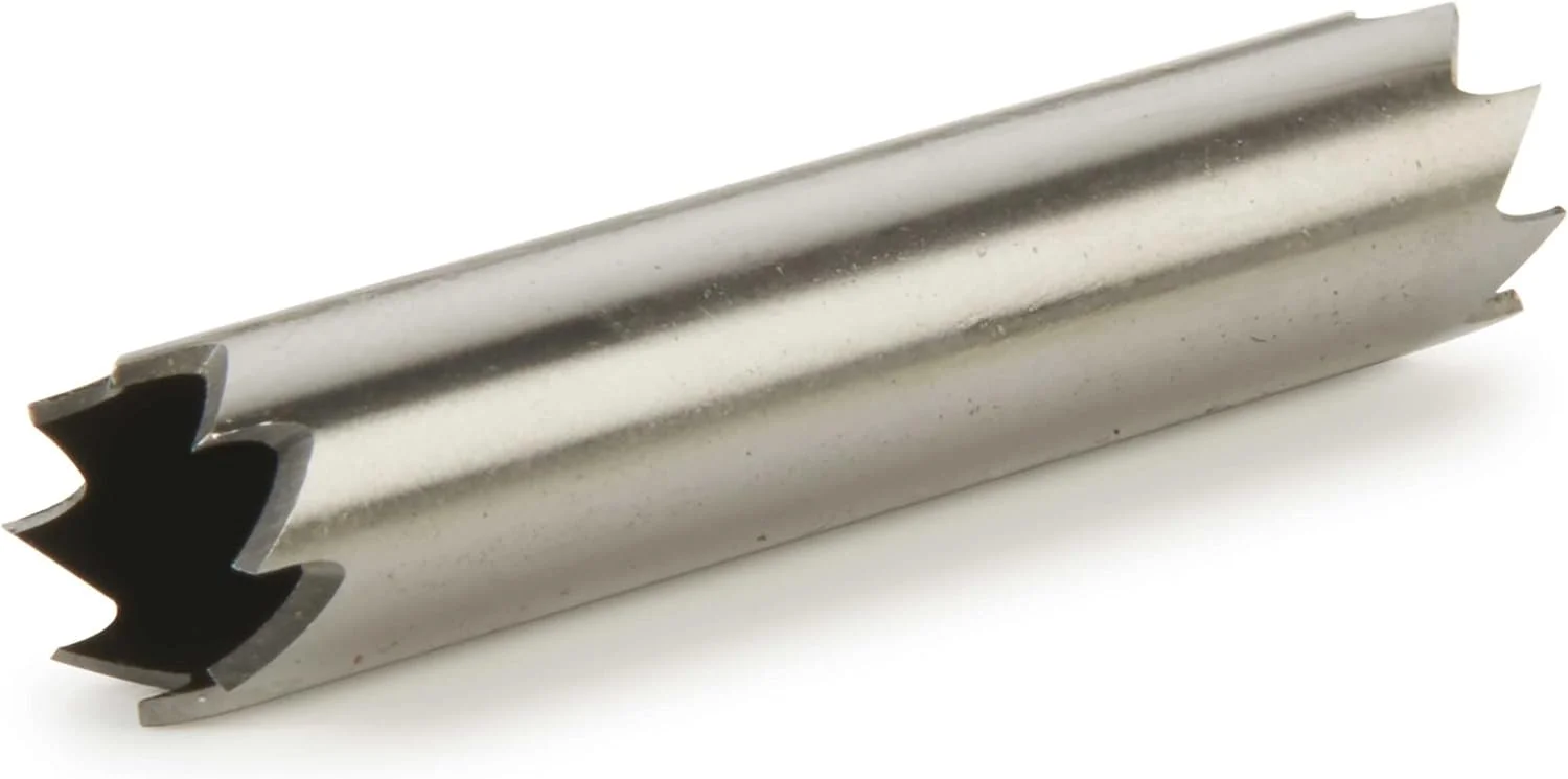

My thoughts were a broken screw or tap extractor jammed in and run in reverse,
Worst case heat the tips up hot and melt it into the plastic, and try again. I tried to find a left hand turn cutter like this, but failed, That seems like it would be perfect for this situation...

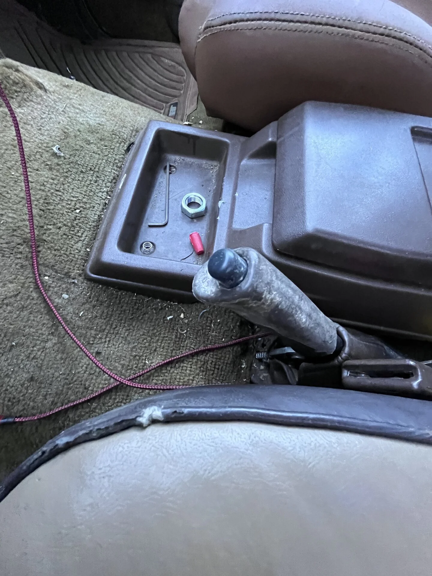

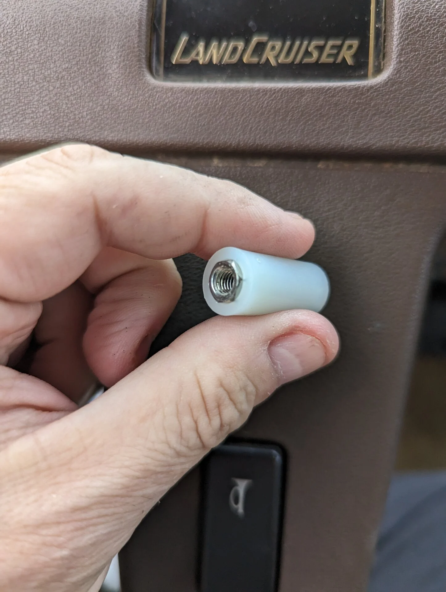

I picked it out with a small screwdriver, the remaining part of the button had shattered.
Turns out it was holding the, spring in place, which is critical for the lever to lock holding the brake on.

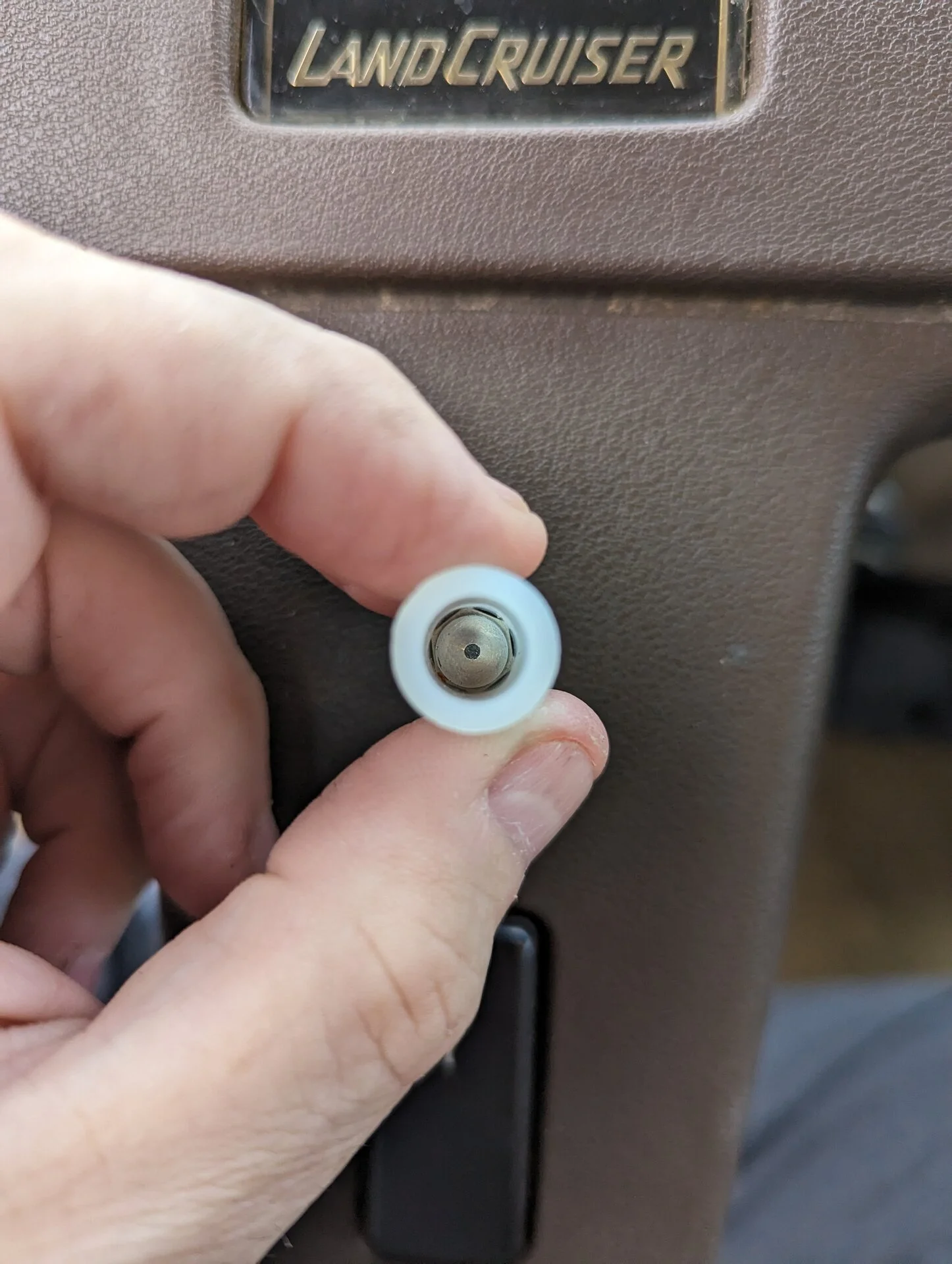

I made a temporary replacement button at home depot, using an m5 acorn nut, and a nylon spacer that friction fit over the nut
it screwed in and allowed me to park on hills.

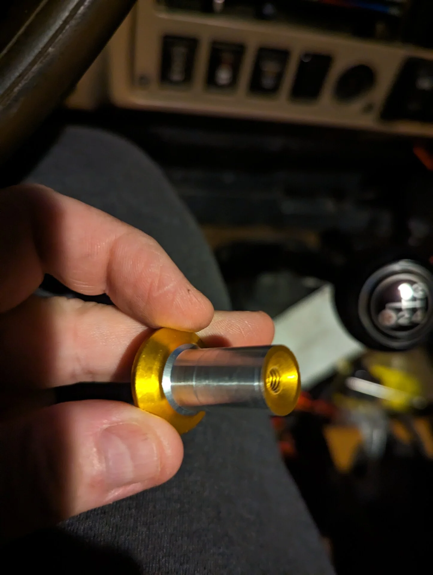

I bought one of the aluminum drifting buttons on amazon.
Button
They were cheap so I took a gamble, turns out the thread was right but the diameter of the sflhaft was too big.
so I chucked it in my HF late and turned it down to fit.
I had to turn down alot more length than I expected, basically the whole shaft.
I'd love to report what I turned it too, but to be honest I eyeballed it.
It fits, and I have a functioning brake button.

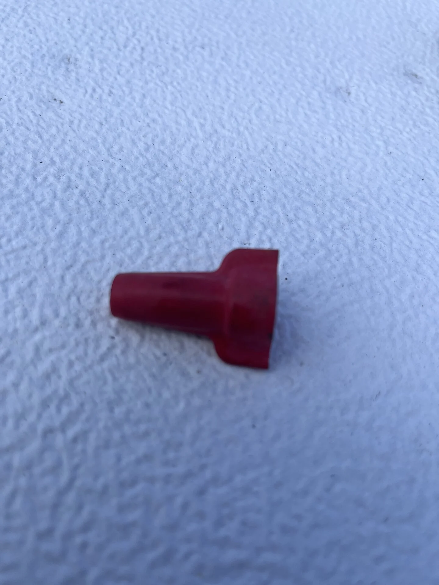

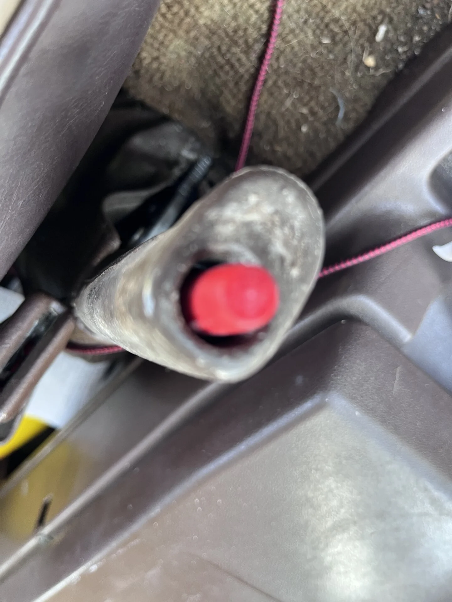

I like your solution. Same thing happened to my 60 a few years back…. I’ve been wanting to go to the pick n pull to see if I can source a button from an old Toyota. In the meantime, I’ve been using a trimmed wire nut …
