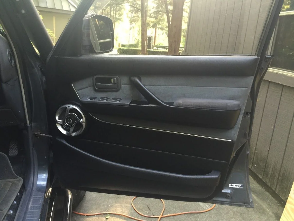

I removed the shag carpet from the bottom of the doors. I will tell you this. Its not fun at all. That piece of carpet was put down with contact cement. I used everything from paint stripper to turpentine to acetone. The amount of elbow grease required is insane. But then again, I am a dumbass that does not know what chemicals to use :hillbilly:
Was it worth it? HELL YEAH!!!
full

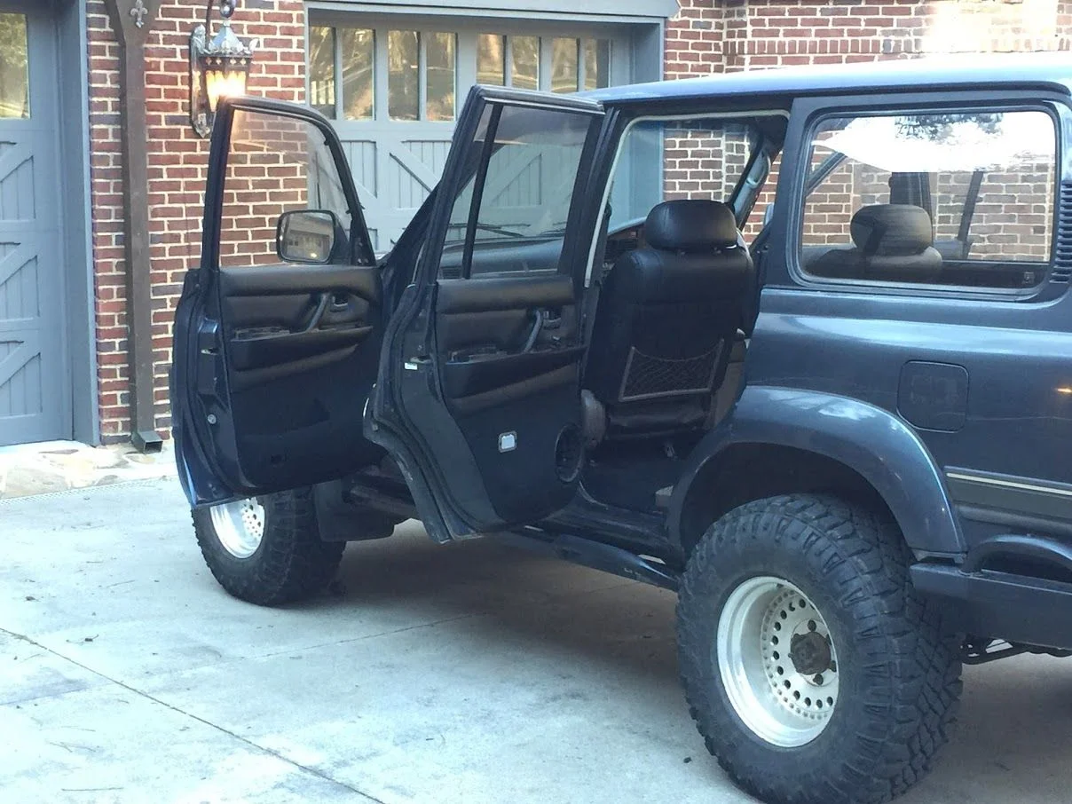

For some reason after all that work I decided to go with custom door cards so those were abandoned. Here the new ones:
full

the front cards were made using masonite and the rear ones were oem cards that were still in good shape. On top of that I used the green flower foam to shape followed by epoxy to harden. Then covered in cloths and pleathers with varying upholstery batting. Use the old cards as a template and use punches to make the holes for the various clips. You will be surprised how easy it actually is to make new cards.
