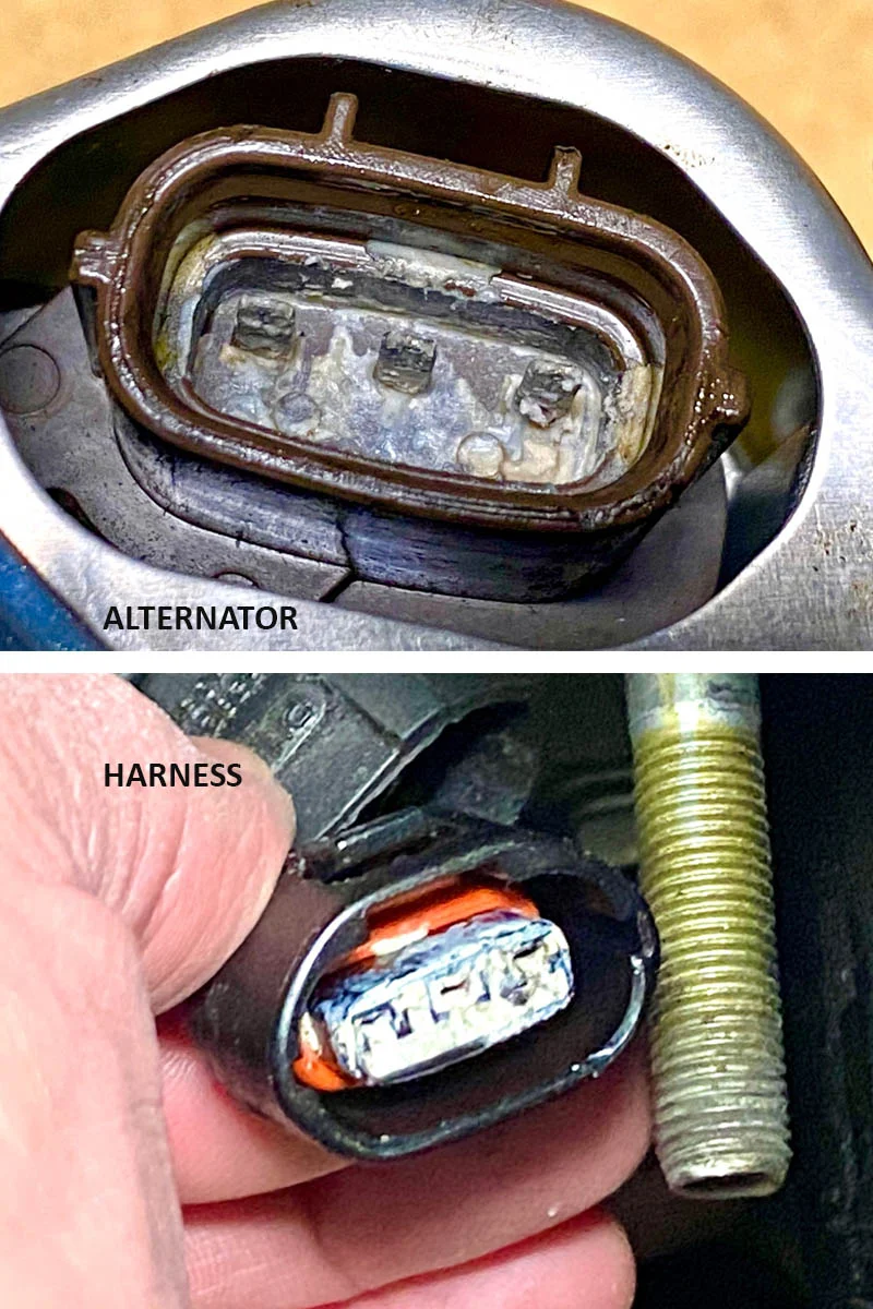

Pulled the replacement reman alternator this afternoon and noticed a white paste-like substance on both the alt/harness. My original alt. has very little white paste-like inside and I don't recall seeing any on the harness clip after removal/inspection and prior to installing the replacement reman alt.
I was thinking this was lithium grease but very little was present upon removal of original alt. and none on the harness connection. Could it be PS fluid and/or oil leaking through?

Just unpacked the "new" reman alt. and noticed the female alt. connector for the male harness wire is filled with the white paste...didn't see that the first round...ugh. Dielectric grease for those who know nothing about automotive electrical issues like me. o_O

I don't remember white grease on mine. Though I would have used some clear CRC or Permatex dielectric grease. I use dielectric grease on all engine compartment and weather-facing electrical plugs. Seems to help keep away electrical gremlins.
My old alternator had white grease in the connector and plug and the reman I got also had a spot or two of white grease in the plug

I've not noticed alternators coming with female connection coated with white lithium grease. I'll look closer at next one. But if I see one, I'd be very suspect it's a returned alternator. Every so often, even form Toyota. I'll get a part that someone returned, which may be their old used one in stuck in the new box. If was new returned electrical part, they may have shorted it.

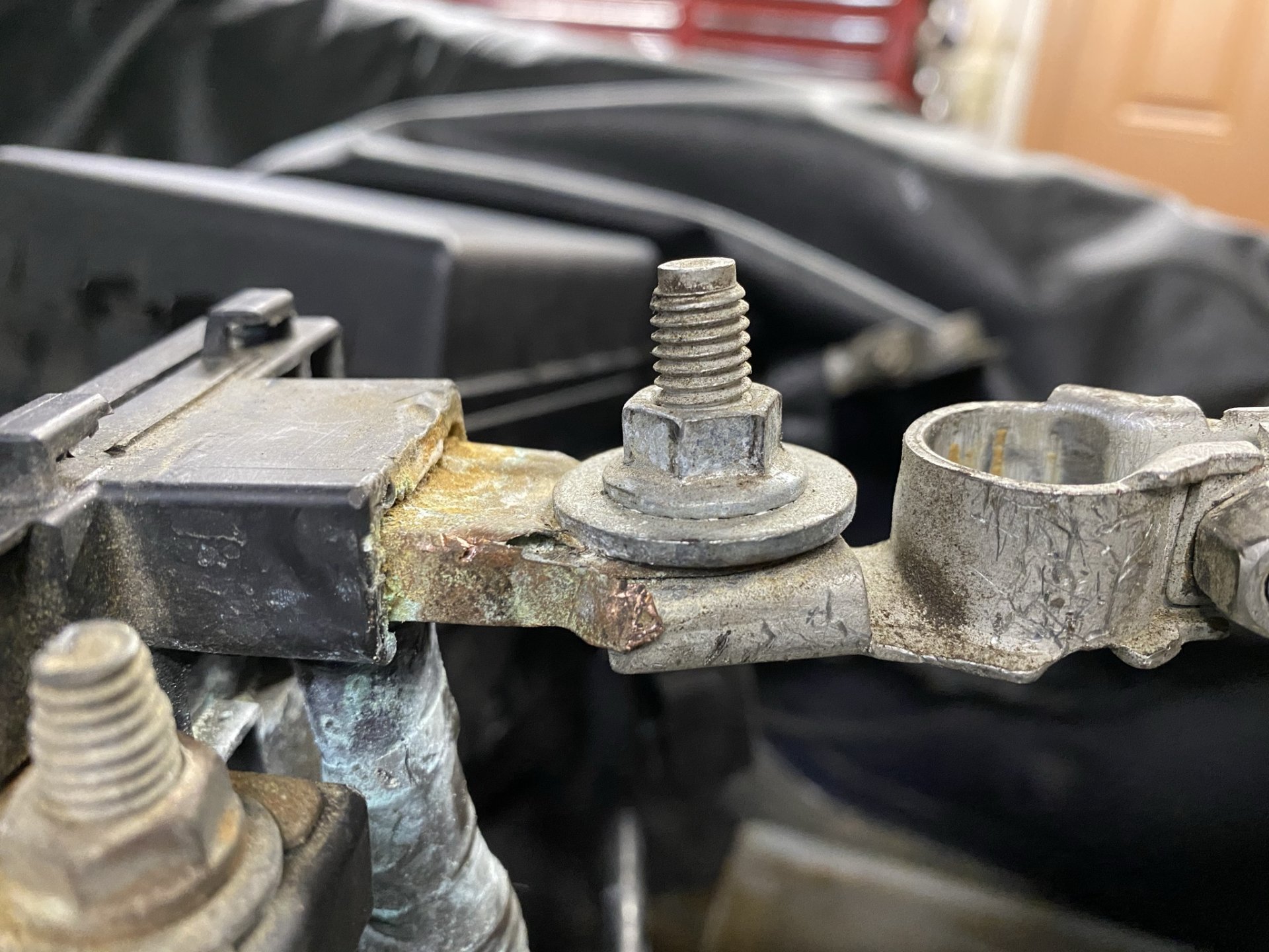

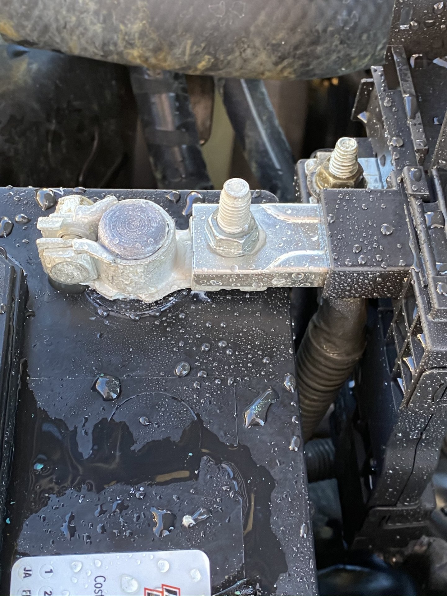

Here's new OEM positive clamps & main wire block. What they should look like.
