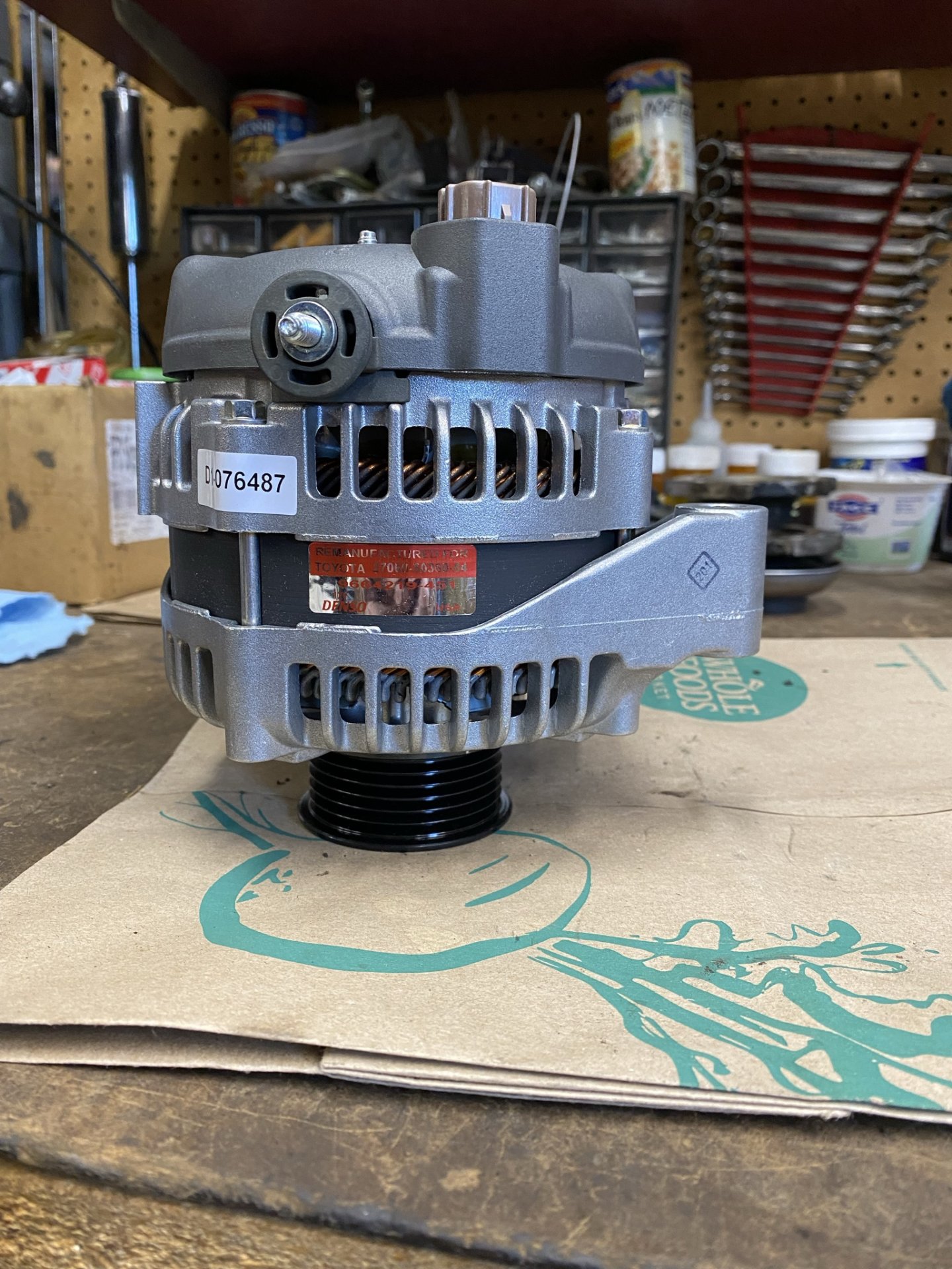

Here's the last one I replaced with a Toyota Denso reman, the old had no markings/PN #. No grease on either.

Are you buying Toyota Dense (best), Denso (second best) or something else?
My old alternator (source unknown) from PO had some white grease. I remember the PO saying the old alternator was newly rebuilt.
The brushes look newer than 21 yo. Maybe it was re-brushed?
I don't recall seeing a light blue paint finish on the Denso from my 1999 Tacoma.
I don't remember seeing white grease on the Denso rebuilt from Rock Auto. I can't see it in the picture. I would have inserted some CRC dielectric as a matter of course during installation.
Since the covering was bare metal, I polished and sprayed them with clear acrylic (used for aluminum wheels with heat) to keep it from tarnishing. It helps to keep mud and dirt from sticking allows easier water cleanup.
The difference in outer cover between this and the old alternator was interesting.
