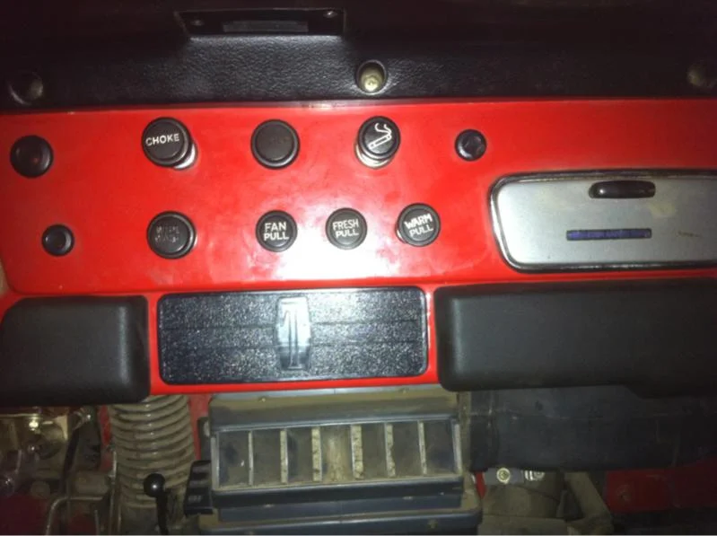

Got a few small things done this weekend. Got a blanking plate for the radio -- it's a minor thing but nice to cover over the hole. Also put in new spark plugs and adjusted the timing. Was at 14*; I'm pretty sure whoever set it last didn't know that the BB is 7*. Was running fine, but I reset it to 12* for now and checked the points (fine). Still need to mess with the carb, but I've first got to figure out what carb I have. It's an Aisan, and new/rebuilt by the PO, but I don't know which model or year. Will post pics when I get a moment.
