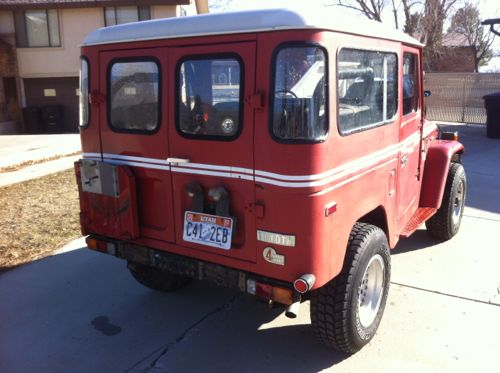

After that deal fell through I found this '76 out of Sacrament, CA. A bit faded, but looked all there and unmolested. I'm somewhat of an originality guy, so finding one with little-to-no rust and no modifications was key and not all that easy. Still, after an inspection by fellow MUDer pighead I had found my truck. Made the deal and flew out a couple weeks later with a good friend to drive it the 700 miles back to Utah. Tough old truck.
https://forum.ih8mud.com/40-55-series-tech/535661-now-i-mean-new-proud-owner-76-fj40.html
My vision for this truck is to make it as if it was a 5 year old truck -- so a few dings and dents, the odd small modification or two, but essentially a solid, reliable rig for cruising the desert. The planned specs are:

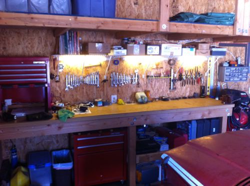

I'll be at this little workbench a bunch over the winter. It's not much, but I've worked on a couple British sports cars (Bugeye Sprite and MGB) and some bikes in this garage so it's workable. A second garage is planned but as yet unfunded.

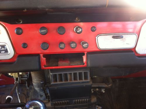

I also found out that there is a light above all the pull knobs in the dash. Who knew? The '76 I had before was missing all of its dash pad so I never even guessed there was a light there. A trip to the parts store for a few bulbs got things working better. LEDs for the internal lights are planned as well.

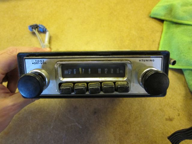

Next up was yanking the AM radio from the dash -- and hoping that the opening was not hacked up. Very pleased to see that the opening was still stock, with just the little tabs cut down a bit. I'm just planning on a radio blank there so this was a nice find.

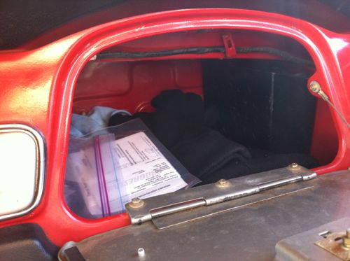

Glove box, with original speaker still mounted against the right side.

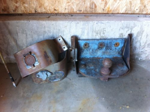

Once that was out I moved around to the back and pulled the old bumperettes and hitch, and cleaned up the wiring where they had patched in the trailer lights. So far that's been the only modification I've found to the stock wiring -- very nice indeed!
Old bits gone:
Nice clean rear end:

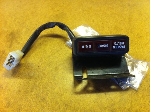

To make room to get to the back of the headlight switch I temporarily pulled the little warning-light bracket that's present on the '76. The seatbelt light was working, but the brake light wasn't and no idea on the EGR light. For now it will stay off as it was a simple disconnect from the factory harness. Seatbelt buzzer still works -- at least until I can find the buzzer and unplug it. :D
So far everything works with the following exceptions:
* Hot air knob doesn't work the valve (valve works, but cable won't push it back closed only pulls it open)
* Light bulb for the headlight switch needs to be replaced
* Dome light works but switch is mostly broken off and cover is missing, needs to be replaced.
* Windshield washer doesn't work (was disconnected, whole thing is on my bench right now)
* Rear heater has hot coolant but fan doesn't come on
Functionally that's what I've found so far. Paint's quite oxidized but that can wait until it's a bit warmer. Few spots need some touch up, and there are a few *very small* rust spots I need to address in the spring.

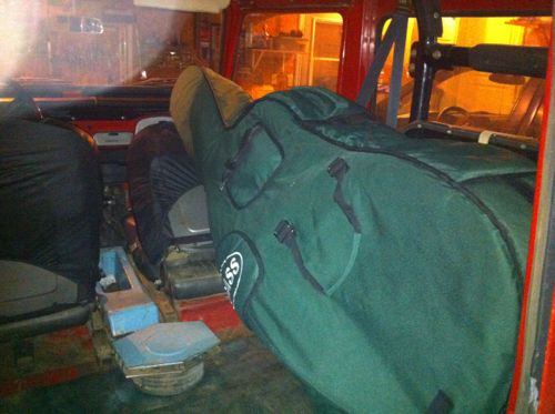

And in case you were wondering, an upright bass fits in an FJ40. Just release the front passenger seatback and fold it forward. Needs some padding and support underneath, but it does fit in there. Good thing too, as I've got gigs coming up and need the money to buy new Cruiser parts!

Just a heads-up, on my '82, the dash brake light doubles as an electrical fault light. If the same is true for the earlier models, you'll want it hooked up so you'll know if your alternator is failing. Looks great!
I'll have to check the wiring diagrams and see if they are the same. My brake light wasn't working anyways -- but it would be nice to have one that was working. I'll probably just put the stupid thing back on once I'm done working up behind it.

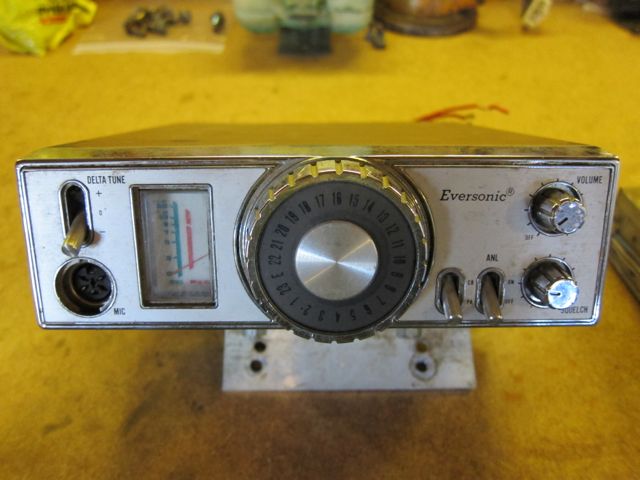

Nice! Always wondered where the OE speaker was - did you pull a vintage CB or the factory AM radio? If CB, is it a Toyota CB?
It's on the outside of the glovebox on a '78, between the box and the cowl way up there. Not sure about 77 or when they switched.

Radio and CB were period but not Toyota as far as I know. Will post pictures when I get a moment. I've got a friend who's big into electronics (he does aircraft electronics) so I may have him go through the CB and see if it's salvageable.
I don't think there is any "check engine light" function in the earlier 40s warning lights - at least none that I can tell from the wiring diagram. Your lights may be out just due to the bulbs being burnt out.
Tried swapping the bulbs around and didn't see any change -- will dive in soon and test all three to make sure that the bulbs are all good, then it's on to the switches elsewhere. I'd really like to have all these little things working properly.

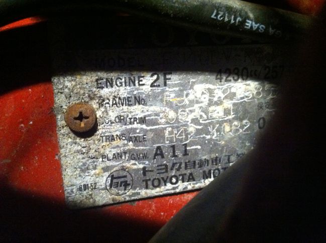

A few numbers
A few numbers of interest for this truck.
Built: 1/76
Frame: FJ40215853
Model: FJ40LV KCJA
Trim: 309 LE11
Trans/Axle: H42 K082

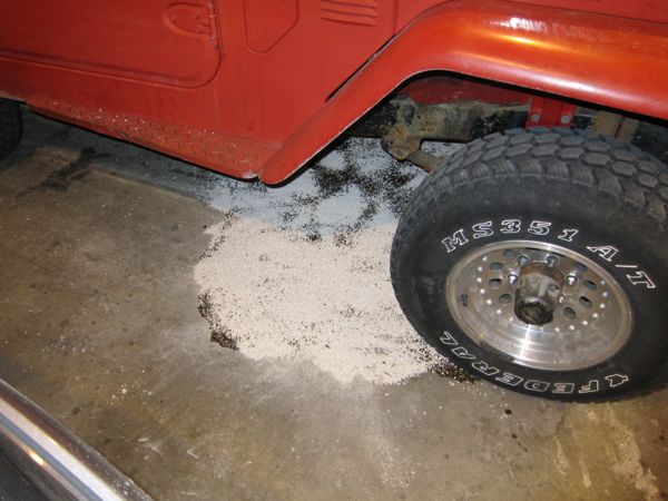

Spent the evening doing a basic service on the truck. Oil change and check both diffs, transmission, and transfer case. Diffs and gear boxes all had plenty of lube in them so I left them alone for now -- it'll be a summer project to do a drain-and-replace, but for now I just wanted to make sure they weren't empty.
Oil change went fine other than a bit of a mishap with the drain pan I was using. *Some* of the oil made it into the pan. I'll be smarter next time. :)
Also wound up draining and refilling the radiator. Used my tester and it looked like the mix was a bit light on the glycol side (tested only to 0 F) so a bit of fresh coolant was in order. Gets down into the negative teens here in the winter and I really don't want to crack a block. All is well now. Long night, but I feel better knowing I've looked through all the fluids.
