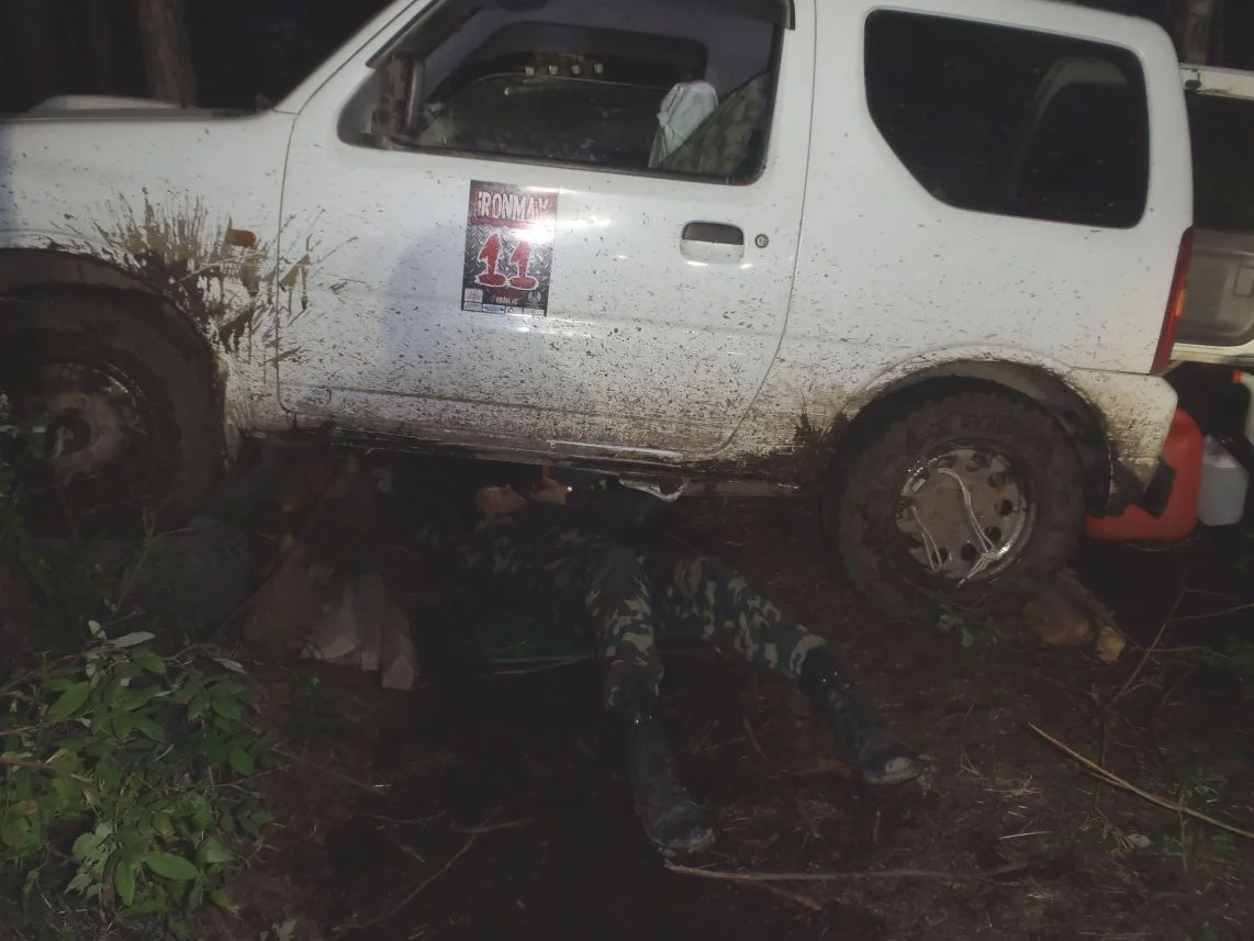

We hear from the radio - jimny is in destress!!!

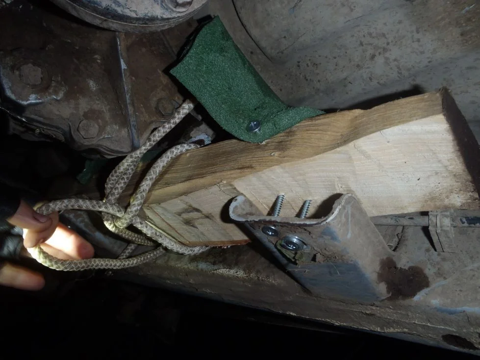

Investigetion showed that the cross beam of transfer case was broken due to stump.
One hour of thinking and half an hour of making a "Pinokio" from our firewood. We have to bind front drive shuft to the chasis to hold transfer case in right position. So we became only rear 2 weel drive.
