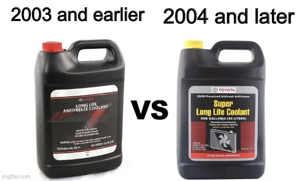

Red or pink coolant? (Answer: 03 and earlier - Red; 04 and newer - Pink)

03 and earlier takes red, 04 and later takes pink.

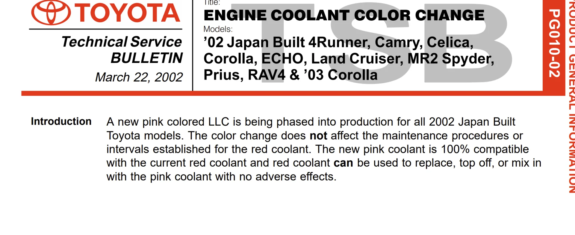

Thanks-- so the pink is does not allow for longer change-out intervals than the red per this TSB?
I thought the pink advertised that it had a much longer changeout interval than the red. If it does not, then I wonder why the change from red to pink.
Still good to know they will mix.

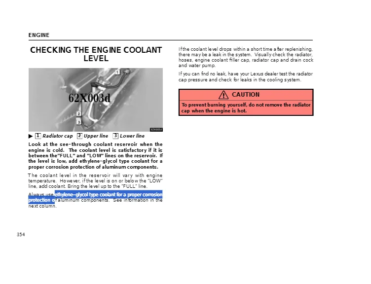

Check your owners manual to confirm. I checked online and for your 03LX470 it does indeed say to use the red ( dilluted to 50/50 with distilled water), super long life coolant ethylene-glycol based coolant for proper corrosion protection of aluminum components.

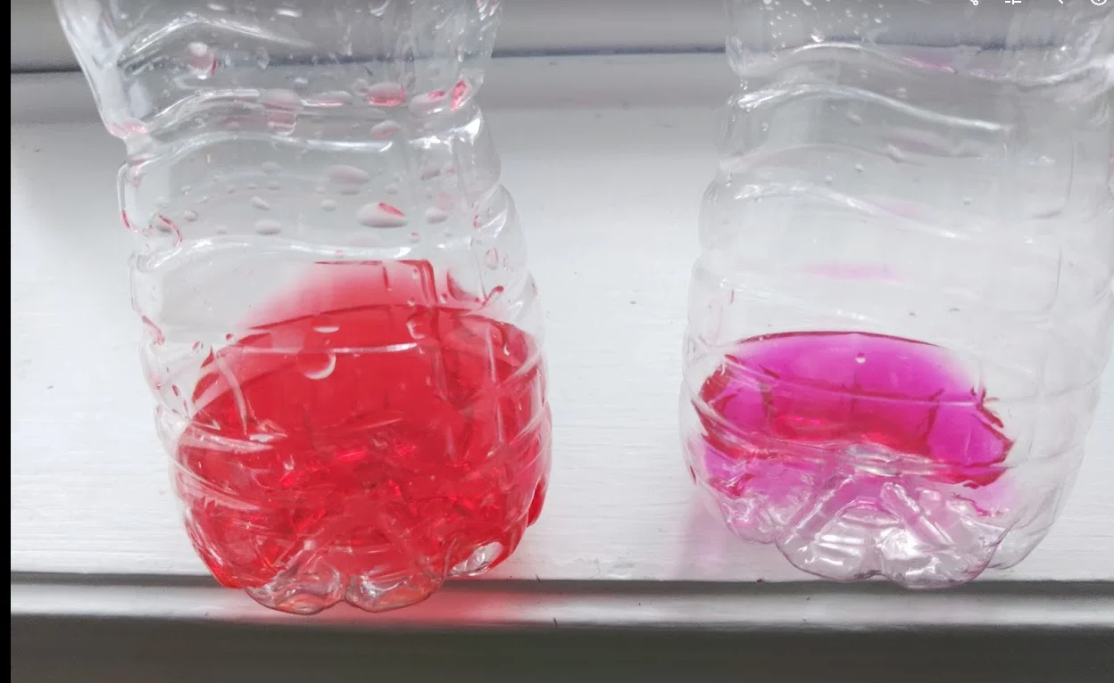

Pink VS Red for reference. Toyota filled me up with pink but then after educating them they took it out and put the red back in. This happens every time i go in, so I get a double flush for the cost of one. Way to go Toyota
