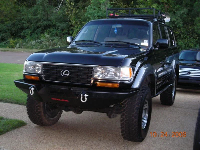

Red line's 80 front bumper prototype
The bumper looks ok to me, but the bars need to be more level/parallel to the bumper, like the first mockup. But I think it could be mounted closer in, cutting the front grill to mount the winch more into the body line.

the outer hoops connecting to the stinger make the cruiser look kinda sad. Other than that, I like it.

Looking good - though I'm not completely convinced on the outer hoops either. Have you turned on the lights to see if there's any effect on the pattern.
Also, what's the mounting look like?
The outer hoops do give it a little bit of a droopy eye look. IMHO they would look better if they were parallel to the bumper.
I know it has been addressed before, but it does look a little low in the front, in particular I think the wings could be shaven a bit even if it requires a/c dryer relocation.

OK, good, this is the response we need, We will do some more messin around and take in consideration of opinions!!
Keep them coming:D
Ill post up some more pics as we go!!

I agree....more clearance, that would be what could get me to sell my ARB and go with something else. Also the corner hoops need to come up at the corner rather than down (like the pic toolsrus posted). The stinger could be bigger so that it protects the radiator in a roll.
The tubing simply needs to be bent to follow the outline of the lights and grill (to enhance the styling of the front end according to my personal hair stylist) and not obstruct the lights or cooling .The center hoop (stinger) should be tall enough and angled enough to protect the radiator (and knock over those pesky shopping carts). I want the main shell to be tight and high but dont want to mess with the ac so I would settle for a skid plate plate that bolts on until I get around to relocating it. In a nut shell, The short bus with a stinger and headlight protection with a bolt on ac drier skid.

I REALLY like prototype #2, that looks very nice. It could be modified however the owner wants! Looks very stout, nice work.
Looks good without the tube. If the tubes were not so massive it would look better. I don't like how the center tubes are lower than the outer tubes. How is the approach angle on it? This will be something to think about if you are trying to sell to Rockers like myself.

Looking really good .. have and idea how much weight on it . ? love to see more pics of it if you have .
Do you happen to have a pic that shows how it looks from looking straight at the front of the rig and from the side?
