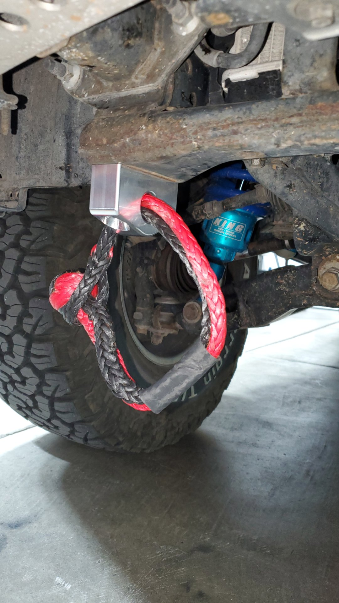

I received my black front recovery points from @turbo8 today. I love how low profile they are and the black allows them to blend in with the surroundings and not stick out like a sore thumb like some other recovery points on the market.
Upon removing my factory tow points I had to hit the area with a wire wheel to remove the light surface rust/corrosion left over from the factory hardware and then I applied a few coats of Rustoleum black. The new recovery points come with new hardware to which I applied loctite. A great product from a great member offering new products for our 200's.

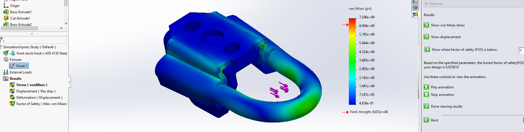

So I was pretty confident with the factory front tow hooks until I bent one, not from a pull but hitting it off-roading. Which made me go down the rabbit hole.
I ran a FEA on them. I'm not sure on the steel used for them, but I hope they were made from something like 4130. The results are they probably will start to fail around 7000lbs.

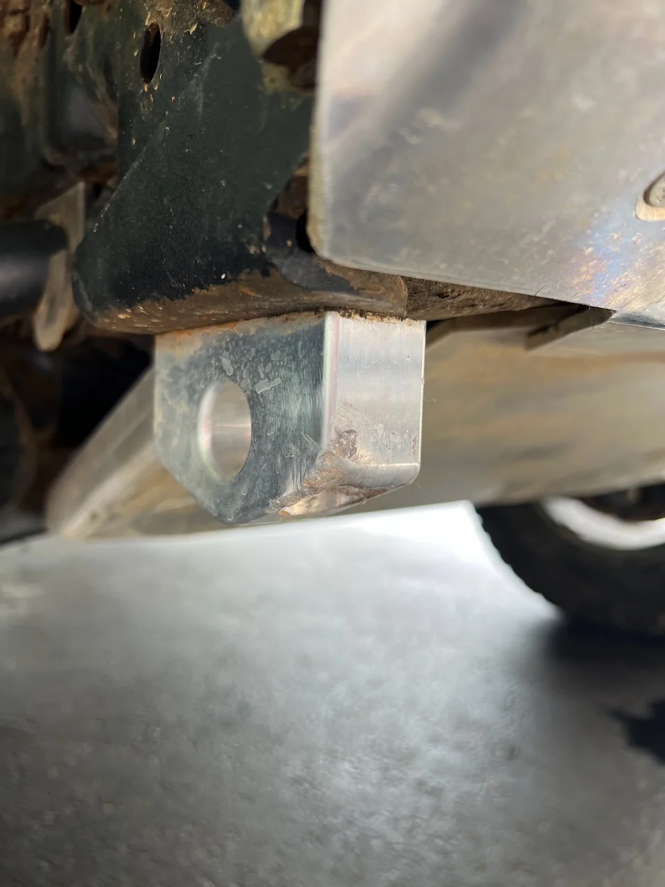

That is why I made some new recovery points. Which are rated for 10,000lbs with a good safety factor. These also gives more clearance while off-roading and have radius edges so soft shakles can be used.
Nice part. Why 6061 rather than steel?
Thanks, If they were machined out of steel they would actually cost more, around 50% more.

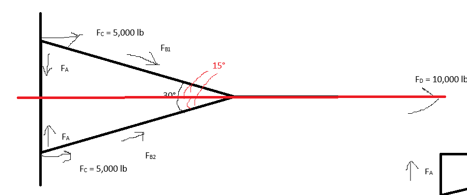

I assume it would be higher but not exactly double. If you connected to both points and pulled from the middle how would the partial side loading affect the rating?
Okay so kinda answering my own question, I think that it really should not be a concern. Assuming a 10,000lb winch pulling its max force, which is then used in a bridle setup, so there is a 5,000lbs pulling force directly forward on each recovery point. So this leads to only having an inward pulling force. represented as Fa of 1,300lbs. This is assuming a 10ft tree saver as well, which would give you this ideal 30 deg.

Well, a 45-degree pull of 10,000 lb would be 7000 in both x and y. It's not until 15 degrees (from the front of the vehicle) that you get pretty close to the rating, at 9,600. I mean look ARB doesn't give any ratings, so even having this info from you is super great.
