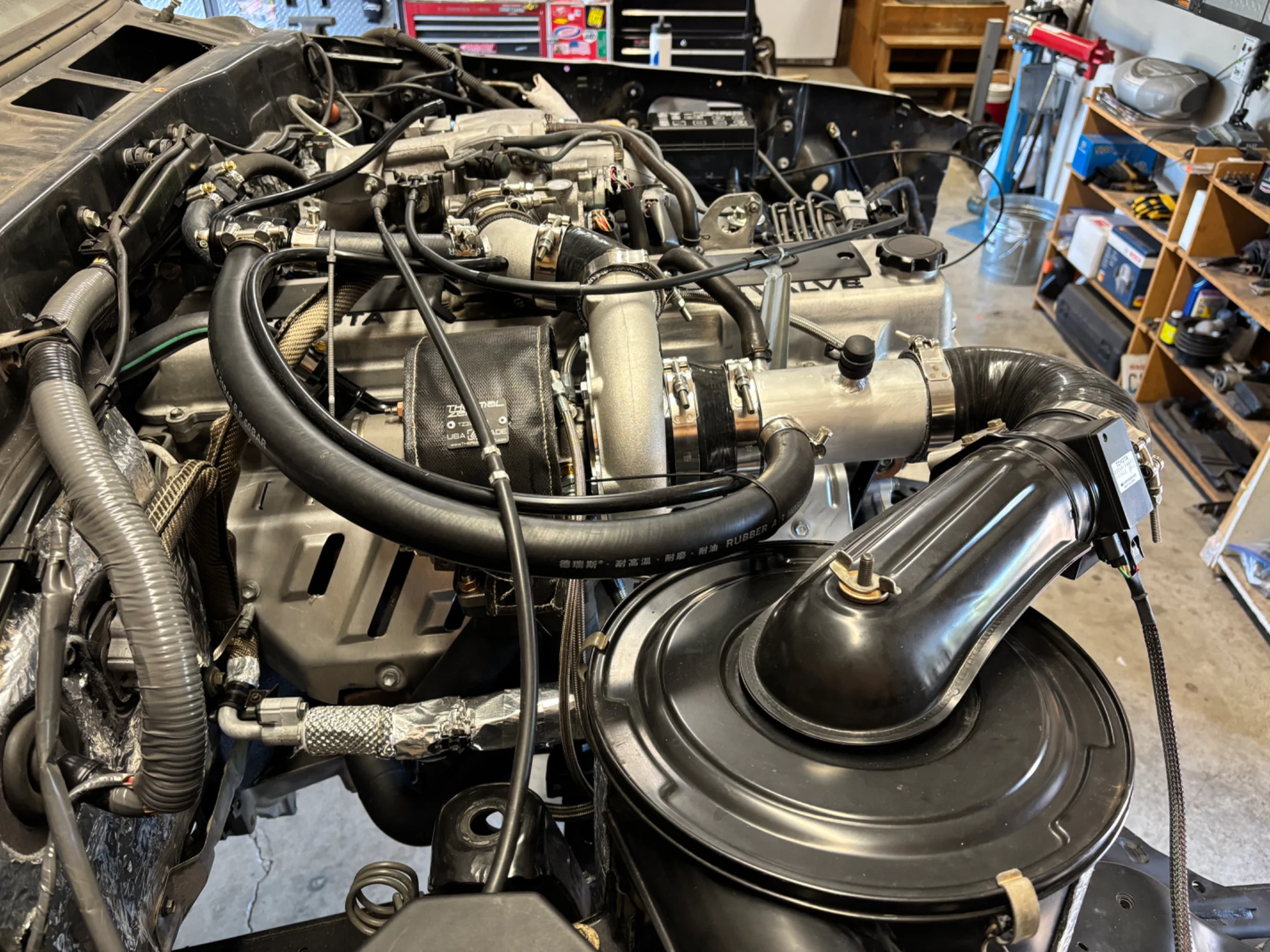

Coming along. The turbo kit install is all but finished.

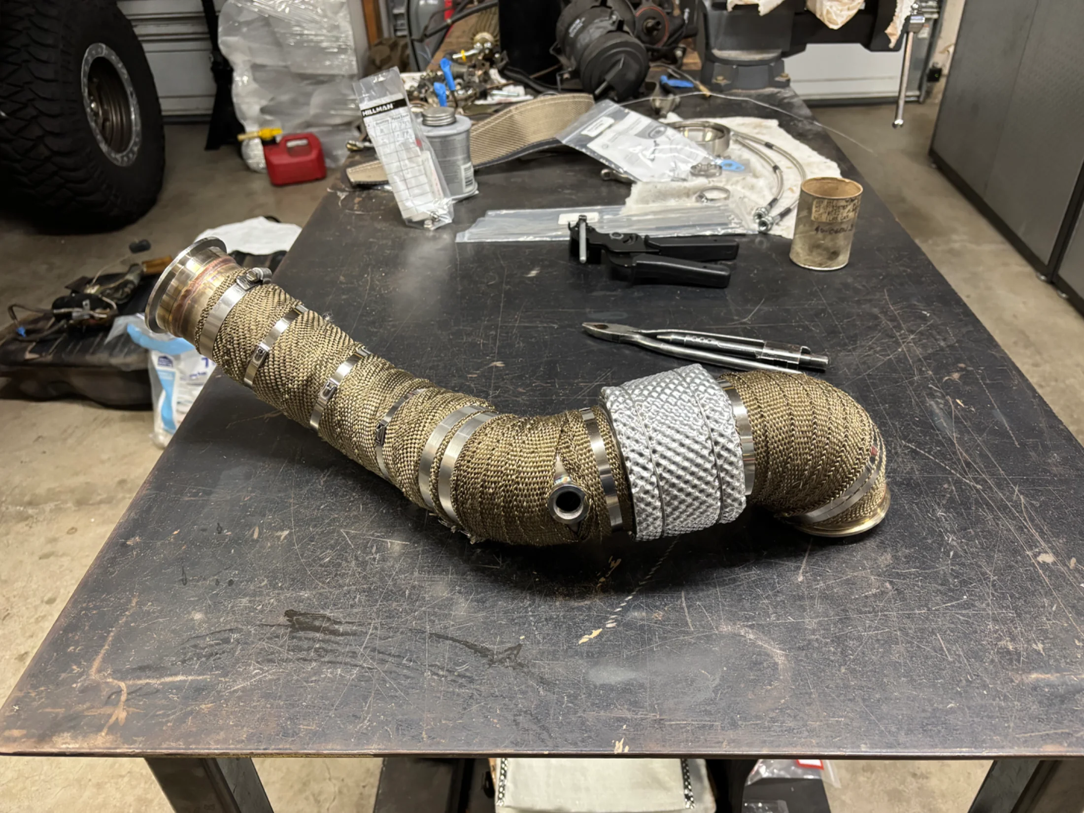

This is absolutely the last example of my idea of down pipe heat wrap! I’ve been through more than I posted. This was the most difficult step of the turbo kit install for me.
Time to geter done ;)

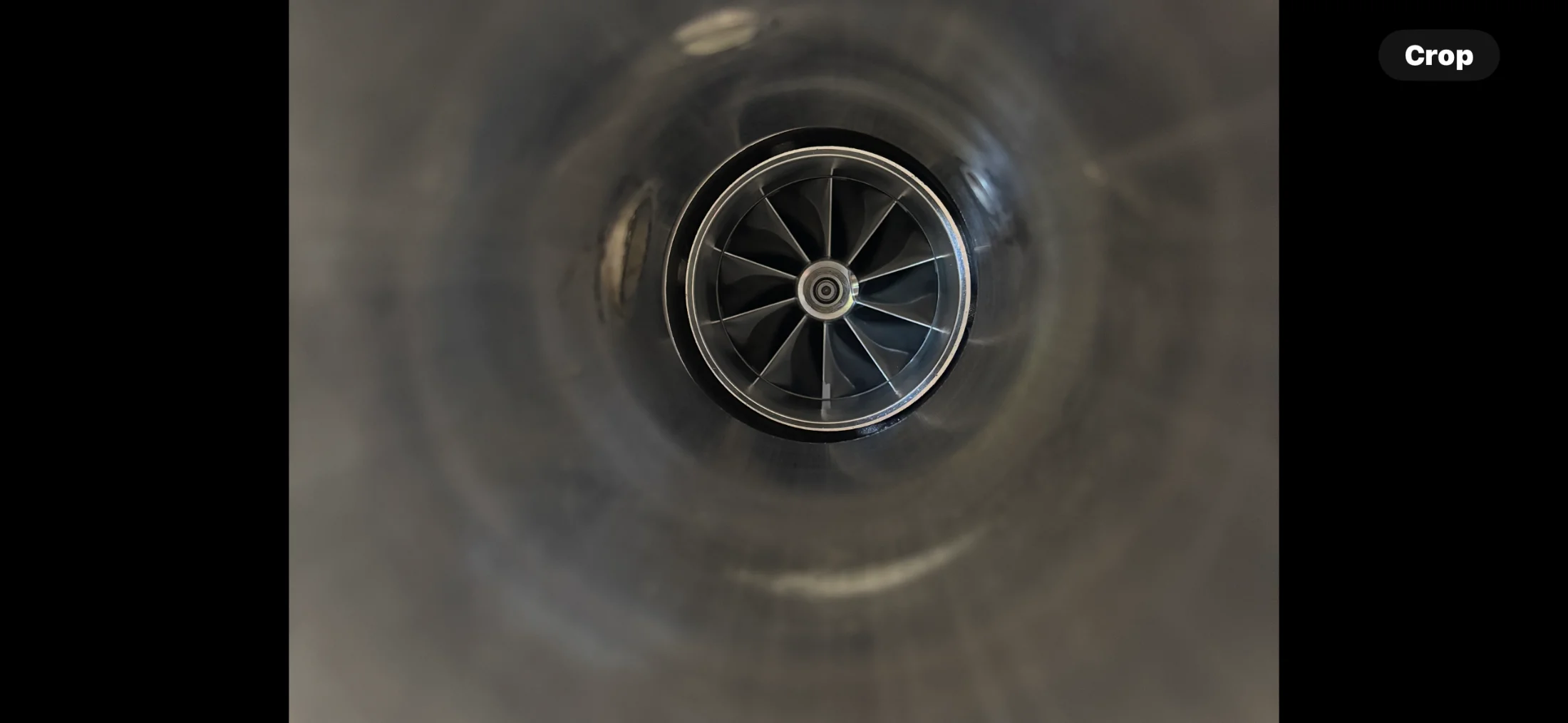

Fan clutch fun! This is a brand new Aisin clutch. If this is how much oil they put in it I have to ask myself if 45ml is too much. I won’t mod the timing but go in with 20k oil. Well, ok, I’ll check the timing but I don’t think.
opening the clutch early is a good thing. It’s timed with the thermostat ideally.

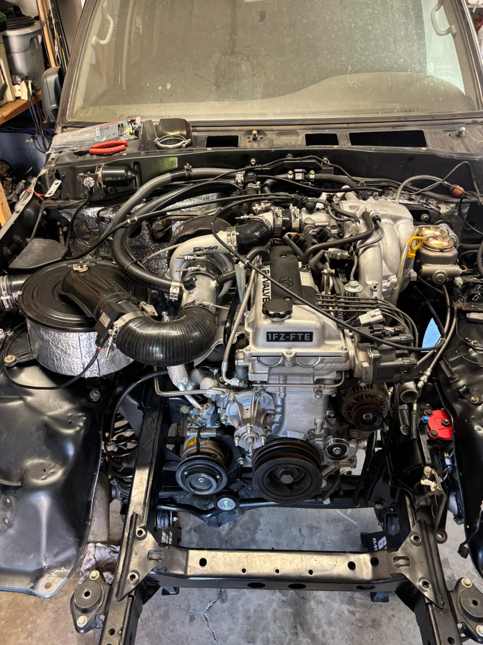

Finally landed on some Cruiser time. New belts and fan install. The power steering cooler sits precariously above its future and permanent home.
After all this work I hope it runs !!

I just saw the 1FZ-FTE pun sticker, very cool. T for Turbo.
That engine compartment is prestine. Almost to clean...like museum clean...almost a shame to get it dirty.

I’m off work for 20 days so the last three days were a full on attack all day deal. I’ve been doing brake lines and other tedious tasks that show little visual progress but do provide the knowledge that I’m getting past tasks I was not looking forward to.
The modifications are what makes it tedious trying to fit things in a whole new manner.
I have to say these Toyota hoses are of impressive quality and precise fit which means super tight to the point that a clamp may not be necessary.
