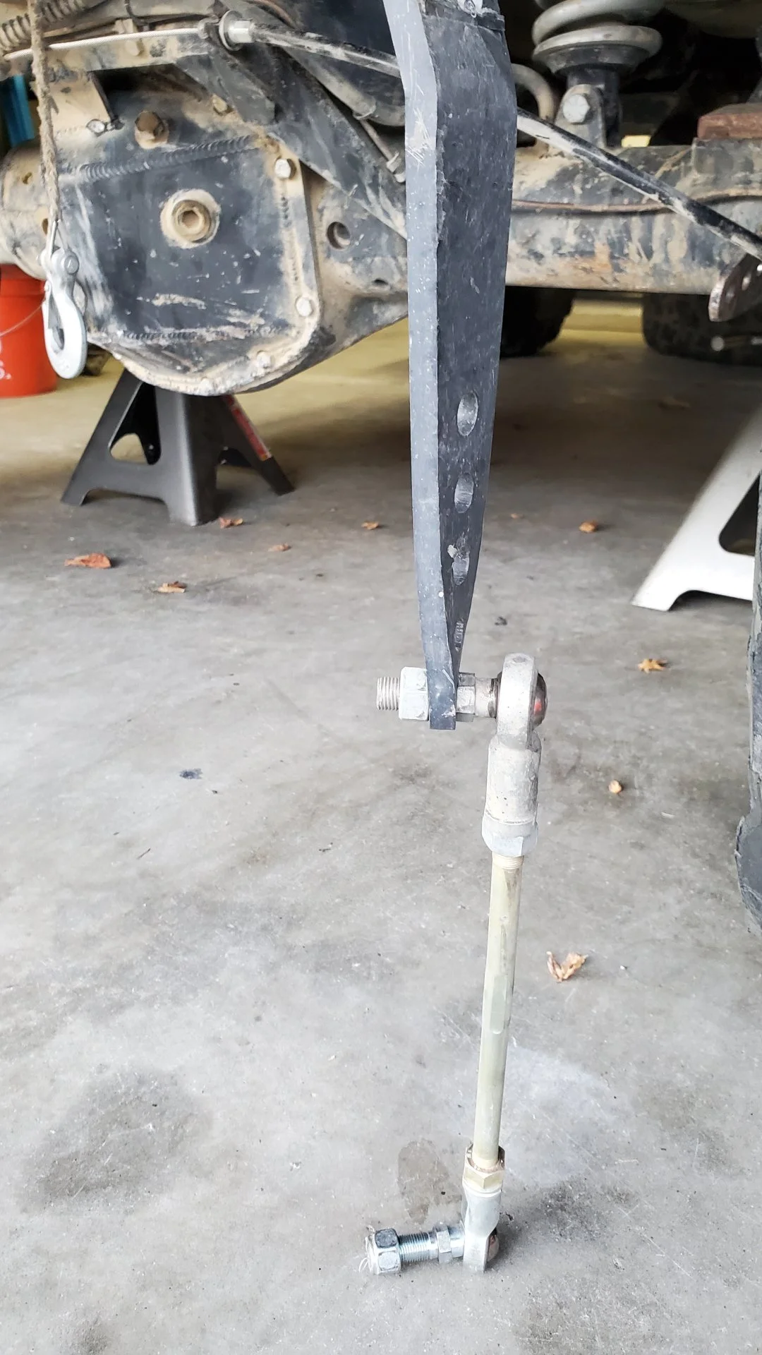

I finished up the last details of the AntiRock rear sway bar last night. It’s a tight fit and took a lot of measuring and consideration. For this one I’d like to give credit to those who went before me and figured most of it out @Broski @spyduh @jcardona1 @nukegoat.

One reason I went with the ends I did was less leverage on the attach point. Hopefully they make a difference.
It might but I'd beef it anyway
They twist, like so:
I see, thanks. That makes perfect sense to me, given the cantilevered bolt style linkage, causing a torque around the arm centerline. I think @baldilocks design is an improvement for that, although I always like a double shear design, whenever possible. @baldilocks design is also a cantilever, but symmetrical and centered on the arm centerline, so it depends the brute strength of that welded bolt thingy at the end.
Yeah I mean this is how Currie sells them... So.. uhh bad on them
I can’t take credit for the design that puts the pivot point on the center line of the arm. I got the idea from @Broski. It was done more for packaging than anything else.
That arm in the photo showing the bend must be 1/2” thick???
