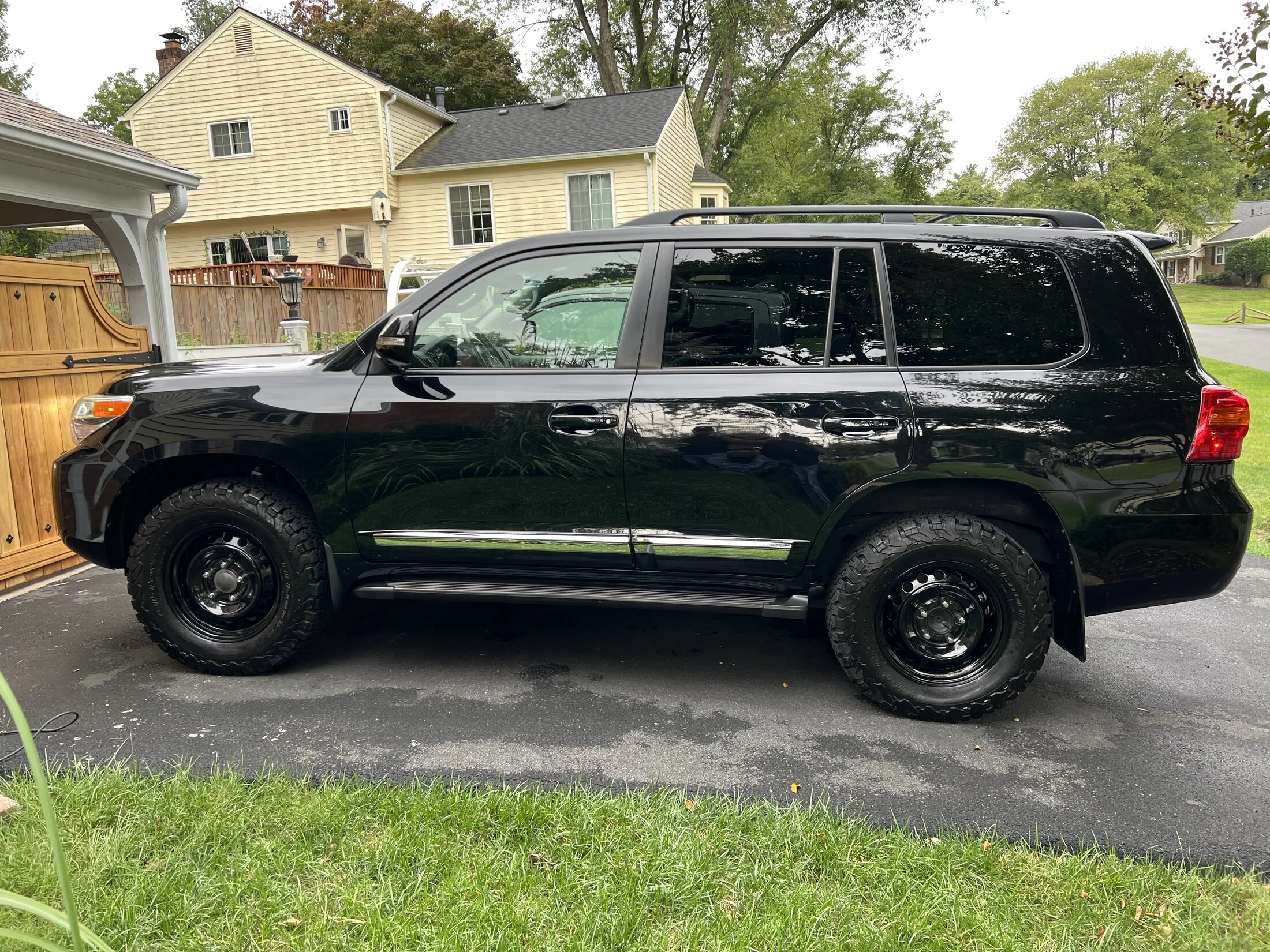

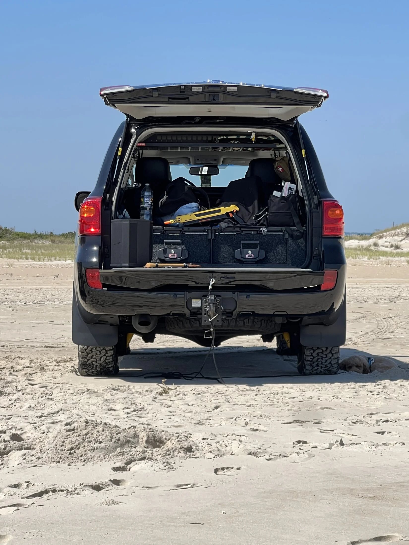

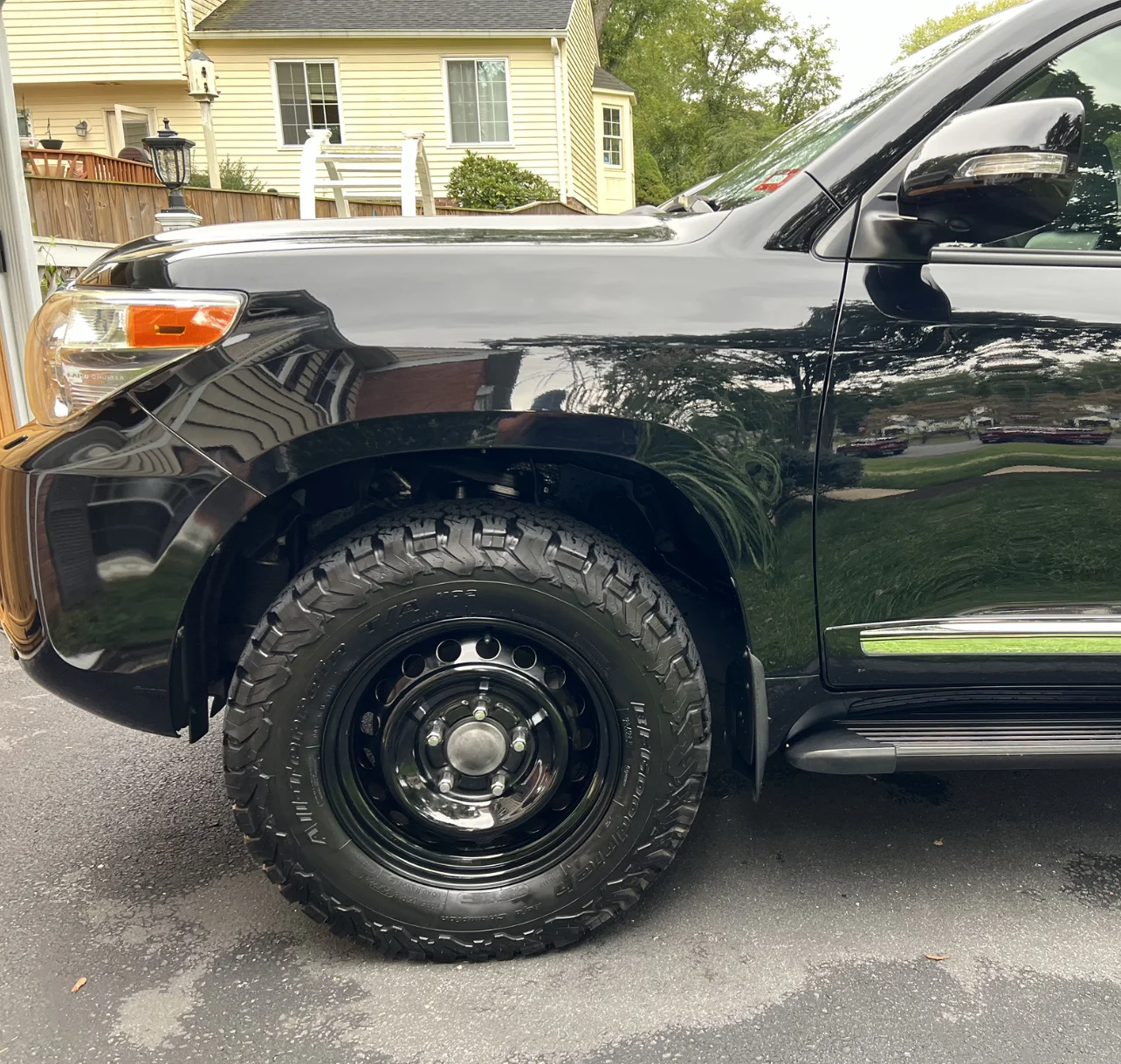

i also didn't need a taller lift. i went with the ome 2704 front springs, 2721 rear springs and nitro charger shocks. gave me about 1.5" up front and and almost 2" in the rear.
i did it at 100k miles, the suspension was pretty rusty so i also replaced the front lower control arms as the bushings were worn and the cam bolts seized. i also run the bfg ko2 285 65 r18. love my setup which is 95% on road and 5% beach and simple fire trails.

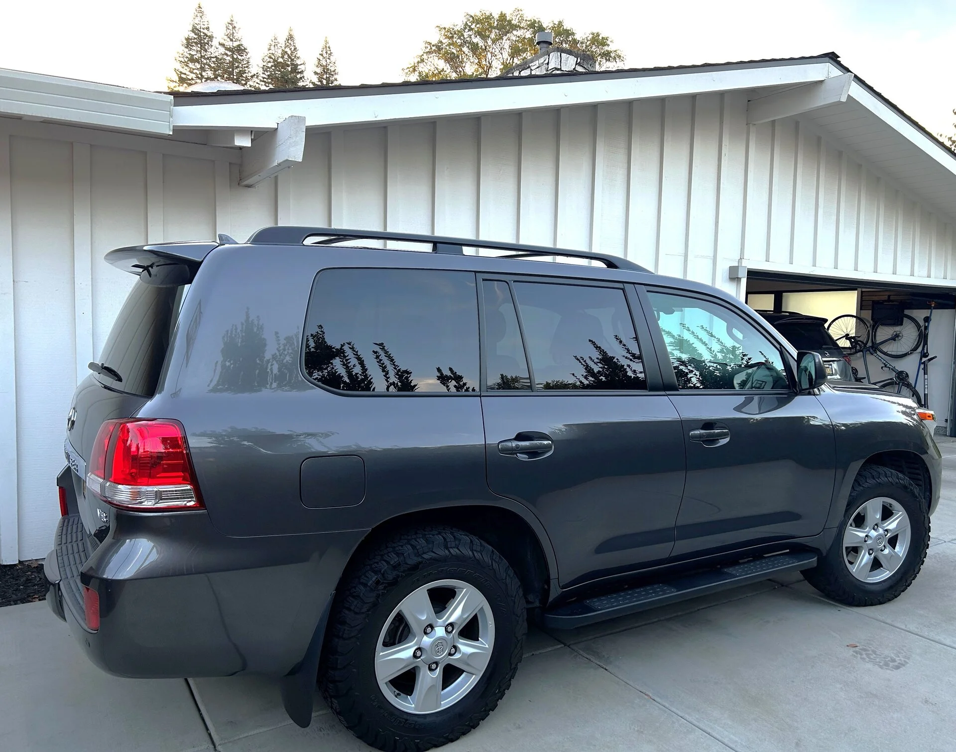

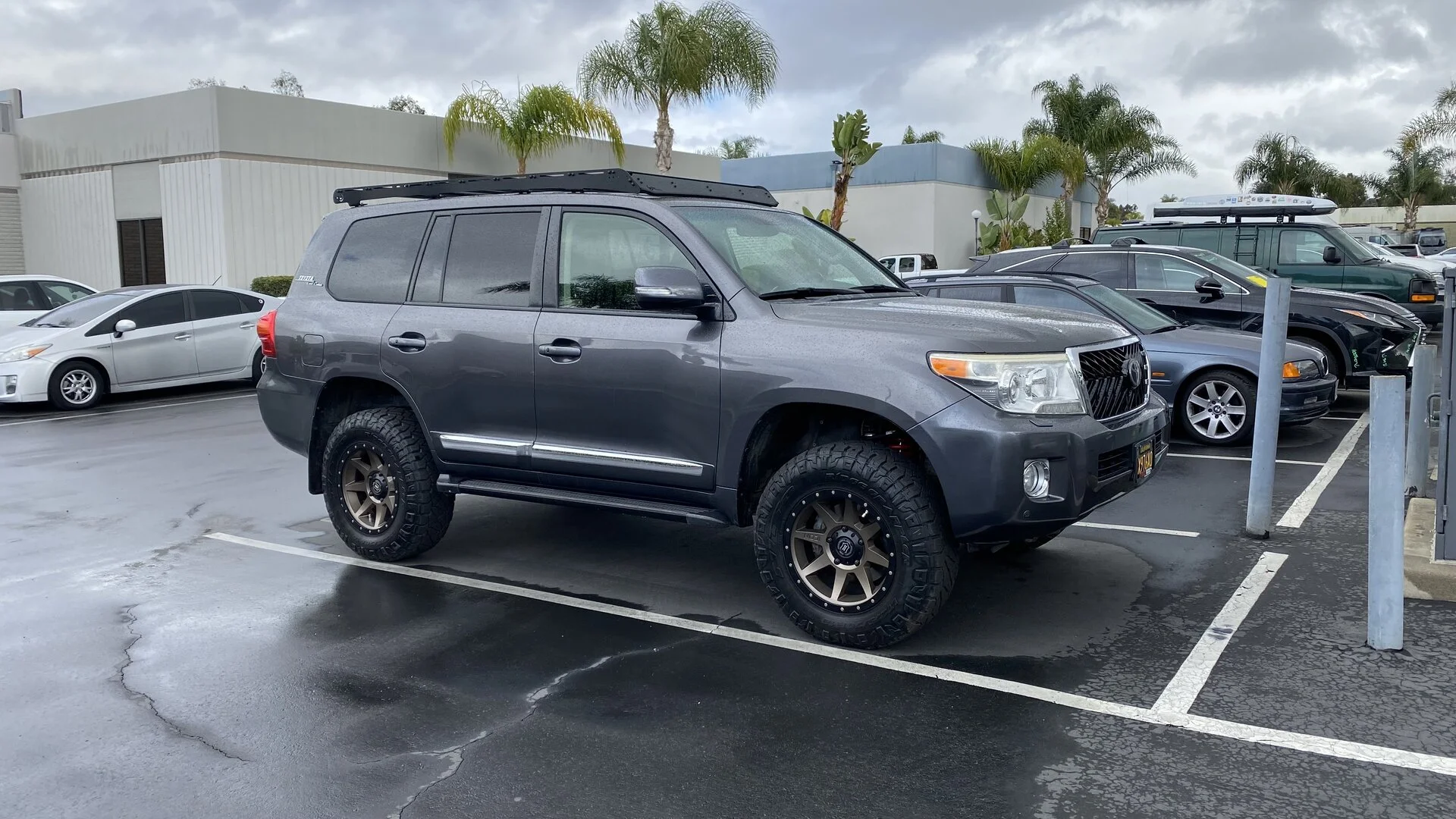

I had similar goals and complaints with the stock suspension as you do. Couldn’t be happier with mine on and off-road.
Here‘s a pic after install. Running 275/70/18s with OME UCAs.

@BVE yours look fantastic. Could you provide some details on how much you lifted front and rear?

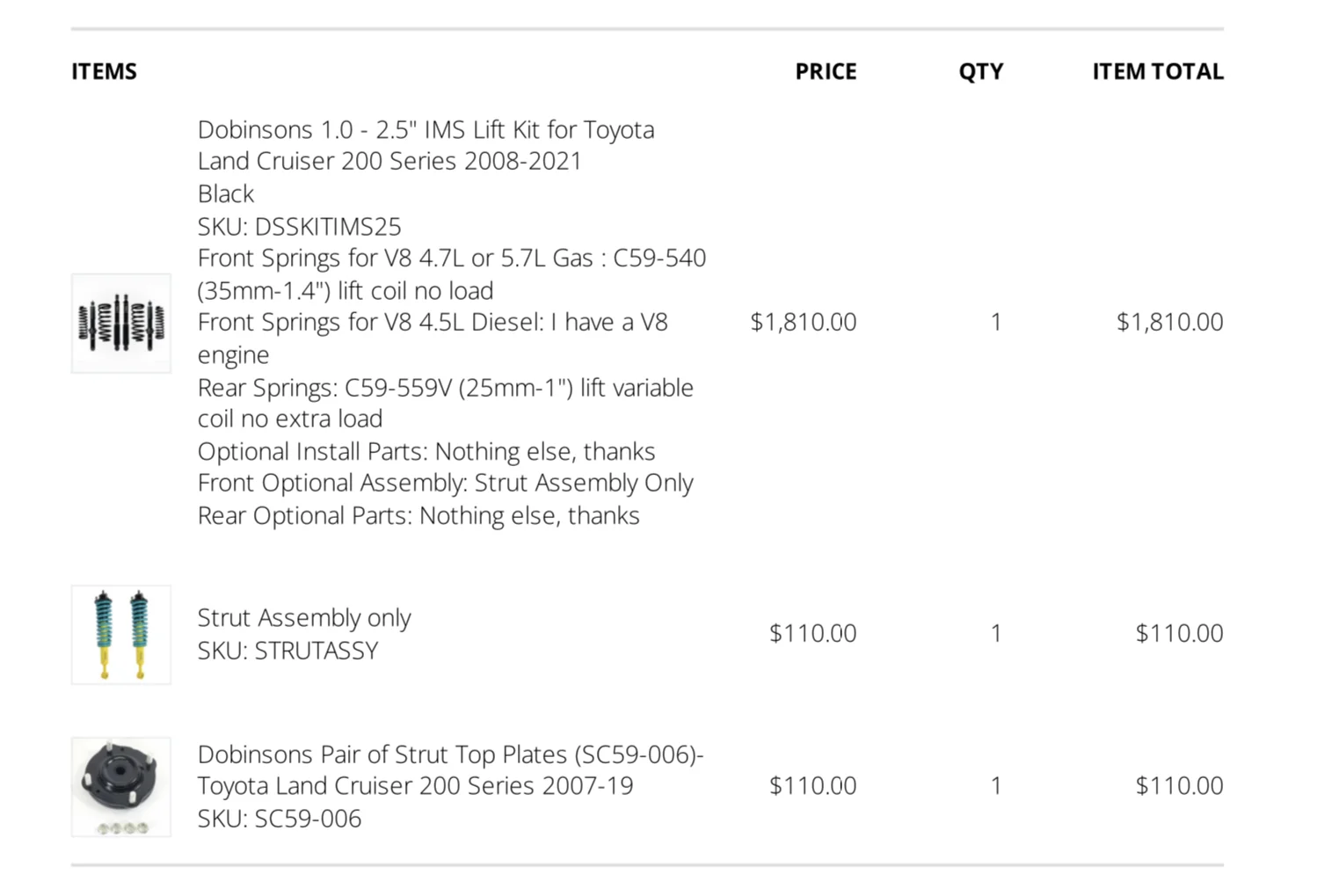

Here is my order sheet:
I got about 2 inches front and back so I still have a slight rake. So as always, more lift than advertised. Get UCAs with whatever you end up getting is my advice.
Thank you for that. So to clarify you ordered the 1 inch lift for the back, but you got more?
You ordered 1.4 inches on the front but you got 2 inches?
Do you have a side photo of yours? From the angle you posted, almost looks perfect and no rake.
I'm real happy with my stock springs, Toyota front spacer, Koni 88s with 360 degree turn up front, Koni 90s in rear with 180 degree turn in back. New lower control arms and upper ball joints, new sway bar links and new tie rod ends. had the alighnment done. Did most everything else. 196,00 miles and it handles better than my brothers LX600. Most of my driving is on the streets, with some dirt trails going to fishing spots on the rivers. I'm not doing the Baja or rocks. There are better options for that type of driving. My cruiser is a road trip vehicle for hunting trips that gets off the road but not severely. When getting shock/struts you get what you pay for. The guys at Cruiser Outfitters are great at recomending the right products for how you drive.
Do you have any pics by chance?

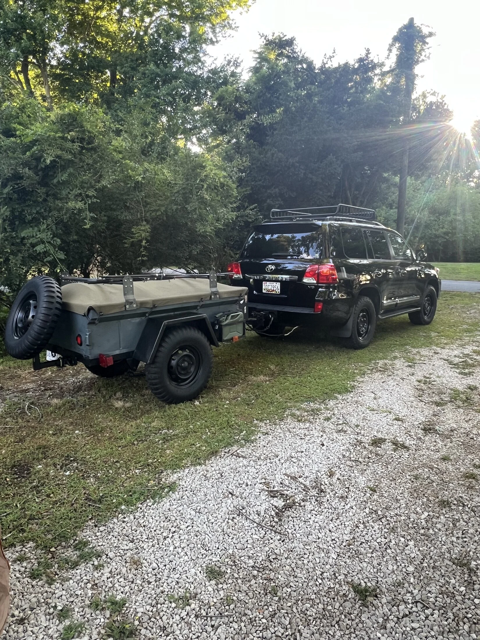

gives me just a little more rake than level but i need that rake for when i tow my trailer
