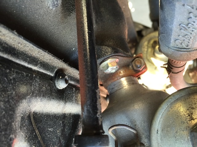

Four months later.....I received new to me (used) rocker assembly from marksoffroad, which I disassembled, cleaned, inspected, and only needed to replace the o rings, thank you mark! Installed reground lifters (thanks Delta cam!), pushrods, and the rocker assembly. Adjusted valves cold, verified oil to rockers with a drill in dizzy slot, then a new battery and a little fuel.....fired right up with choke, idled smooth for less than a minute, then I shut her off.
