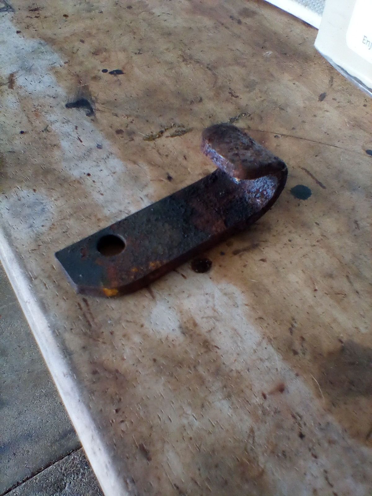

I'm going to pull the motor, and put it on a stand so that it's easier to check the bearings and clearances. Does this hook look legit? I found it in my parts stash. Did not use it the first time i pulled the motor out. Appears to fit the rear driver side of the head, but only one bolt hole, seems shady.
Another question for the gurus.....any problem leaving the water pump, t-stat, and manifolds on while I pull the motor and then after its pulled, when on the stand and inverted 180. I drained the oil, I'm sure there is still some in the nooks and crannies. I will open the coolant block drain and try to keep this as clean as possible. I'm not sure if inverting the engine will push oil or coolant somewhere I don't want it to go.

I'm going to pull the motor, and put it on a stand so that it's easier to check the bearings and clearances. Does this hook look legit? I found it in my parts stash. Did not use it the first time i pulled the motor out. Appears to fit the rear driver side of the head, but only one bolt hole, seems shady. View attachment 3067769
Yes, that is the rear drivers side engine hook, and no problem leaving the other items in place.
As @firemanj92 said, the hook is legitimate for your year engine .
I would pull the thermostat and replace. Had a bad experience 30 years ago with a new thermostat that stuck after only two hours of air exposure.
I don’t give my customers an option; the only thing worse than draining the cooling system is doing it twice because of a thermostat you COULD have changed but didn’t. :banghead:
