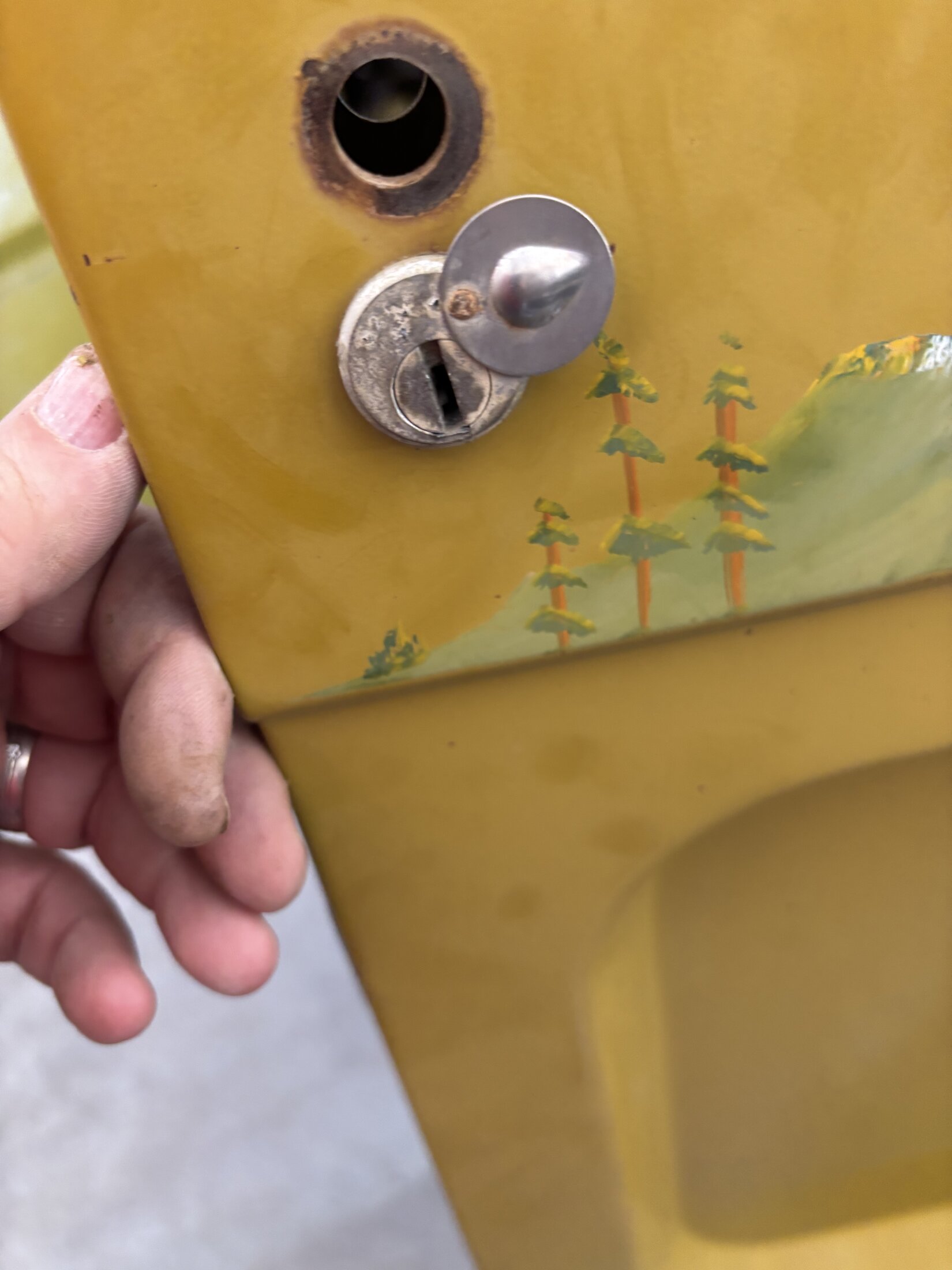

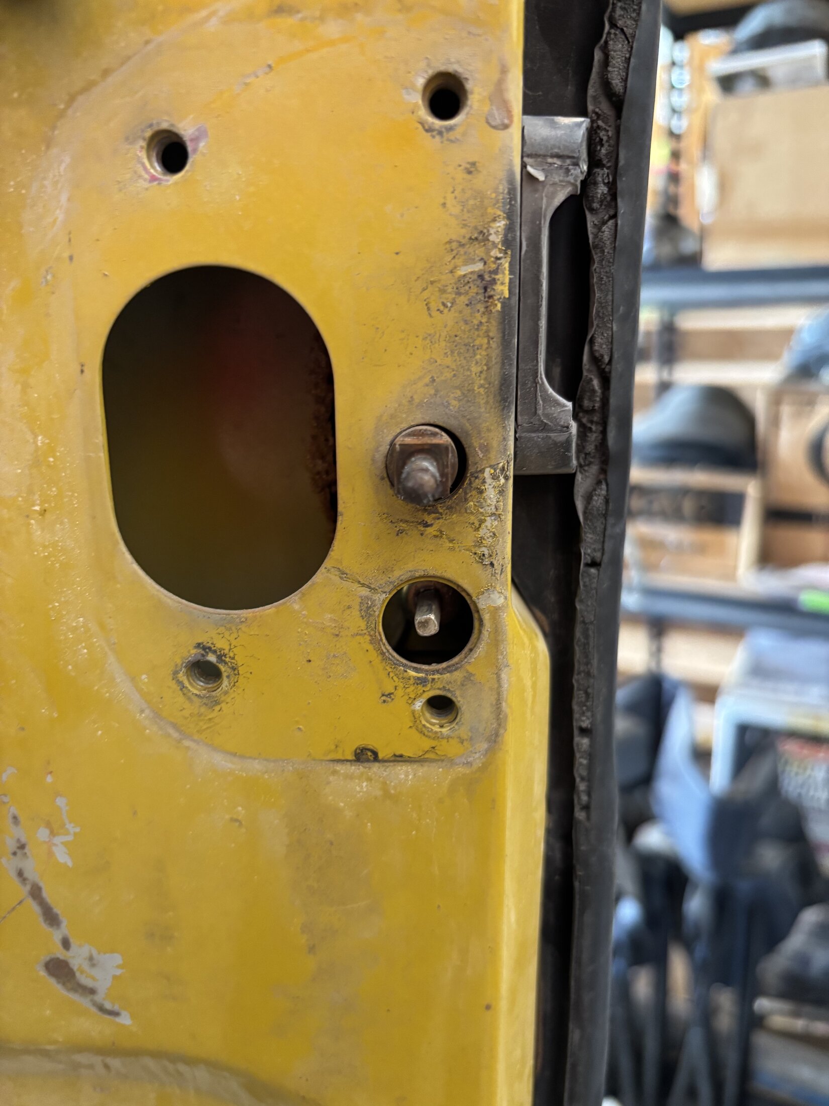

Went out and replaced the rear lock on the ambulance donor and found the threads were wiped on the door handle and had to pry out on the plate to put pressure on the nut. Have another one coming from CCOT and had a good price.
Removed the door regulator
Before removing the lock
Installed the new lock and had to use the old spring clip because I dropped the new one.
New lock installed

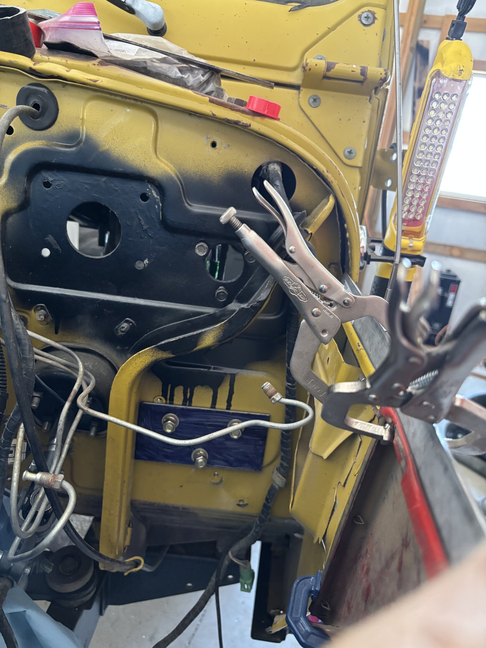

I put the DS apron on to see what kind of room I have and started looking for a place to mount the Cummins fuel filter. Then straightened the old bracket that I don't remember what it was for and prepped to mount the fuel filter on the fire wall
Apron in place
Cut a piece of flat bar and laid out bolt holes to bolt to the fire wall.
Drilled the other two holes in the firewall for M10 bolts
Bolted the flat bar to the firewall

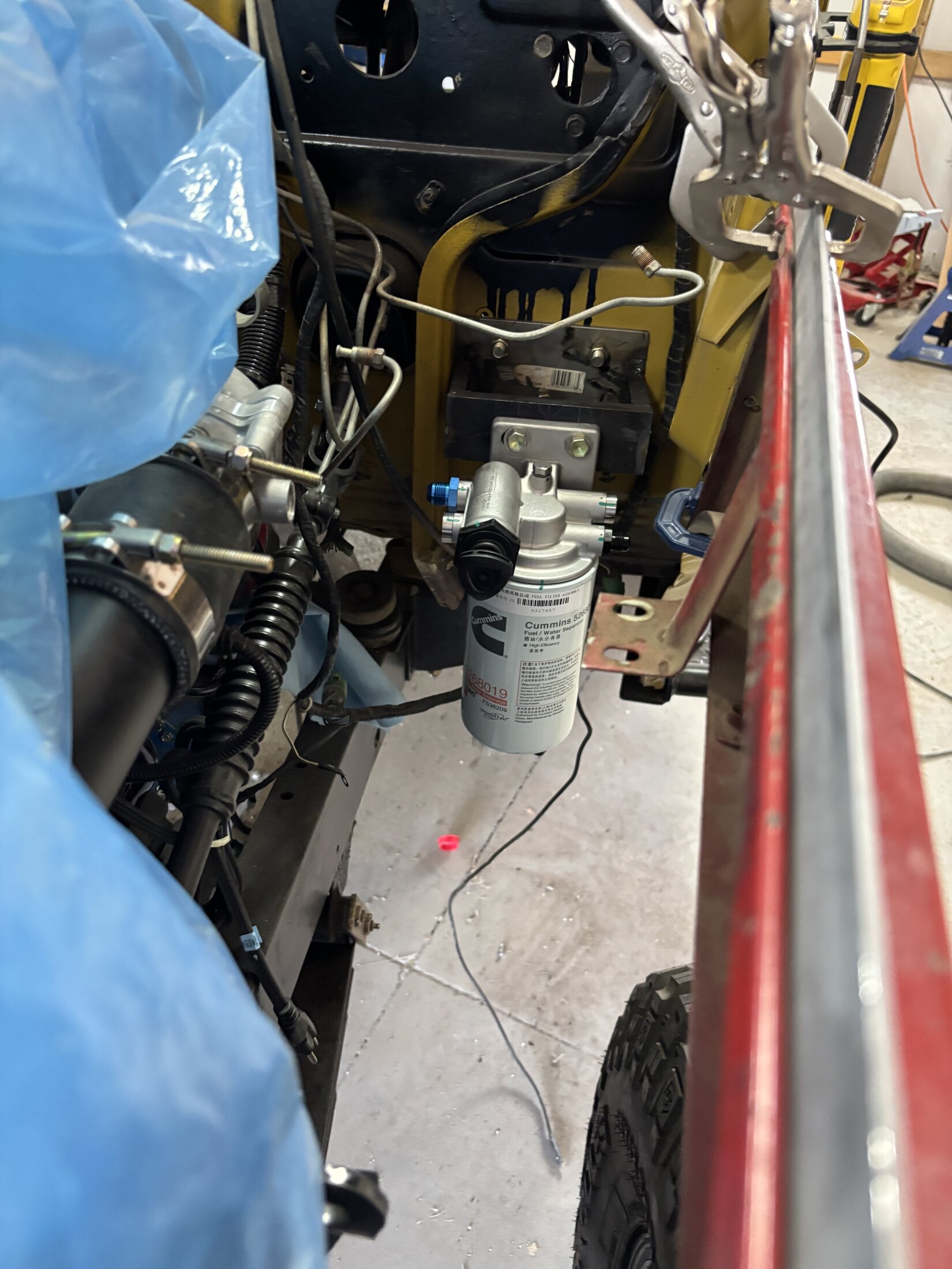

Laid out some 2"x1/2" flat bar to bolt the fuel filter head too then cut with a chop saw
Used some C- channel to weld the flat bars together and have the stand off to get around the stiffener on the firewall and bolted the filler to the bracket.
Once the fenders are done will have inner fenders fabricated to provide clearance to drop the filter and protect for anything coming from the tires.
Took the filter and mount off to grind some more on the welds then shot with paint. While the paint dried I went to ACE and got fender washers to use on the inside of the fire wall. Then put it all back together.

Did you move your voltage regulator? (Or does that not apply on a Diesel?)
The voltage regulator is internal to the provided alternator that Cummins installed.
The package for the R2.8 included, the alternator, PS pump, and vac pump.
The new rear L door handle was delivered from CCOT and while I was on a dump run picked up a M6-1 nut and a 1/4" flat washer and a lock washer. Came back and replaced the handle. While I had it open I knocked off the powdered rust inside and shot with some paint before assembling.
