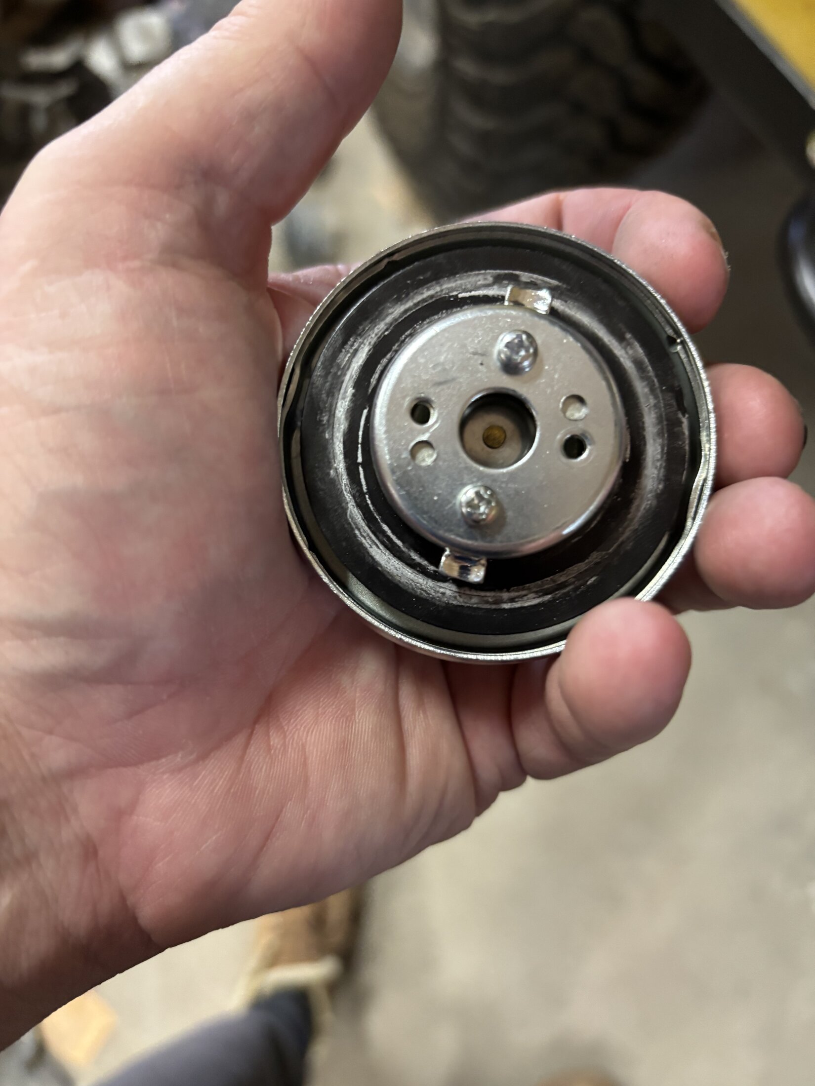

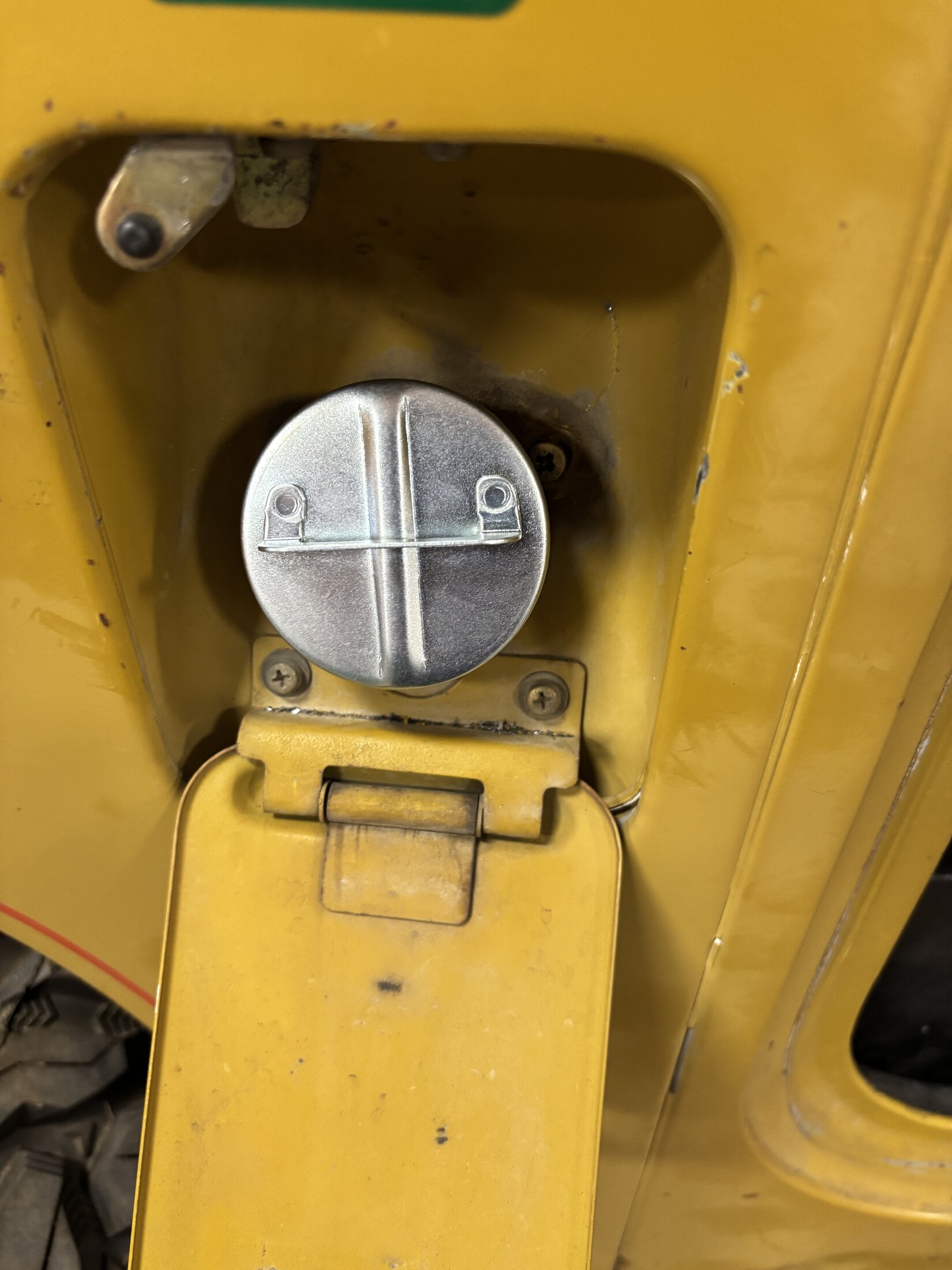

I forgot to fix the fuel cap so went back out and found that it is adjustable. So I took the two screws out and removed the piece with ears and put in the vise and drill out all the small holes to size so the screws would fit.
Rotated the piece and tightened the screws and installed the cap

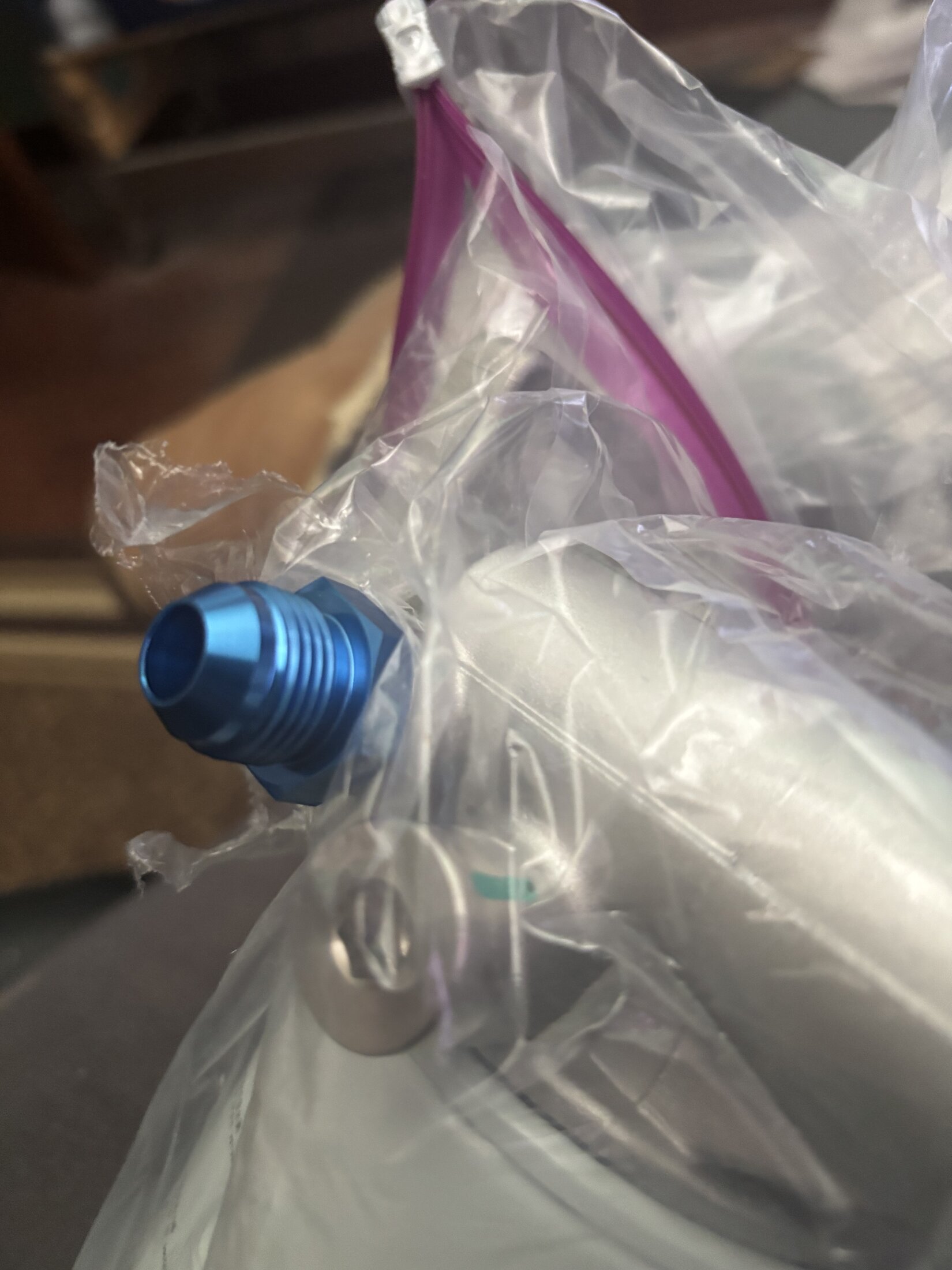

I got fittings delivered today.

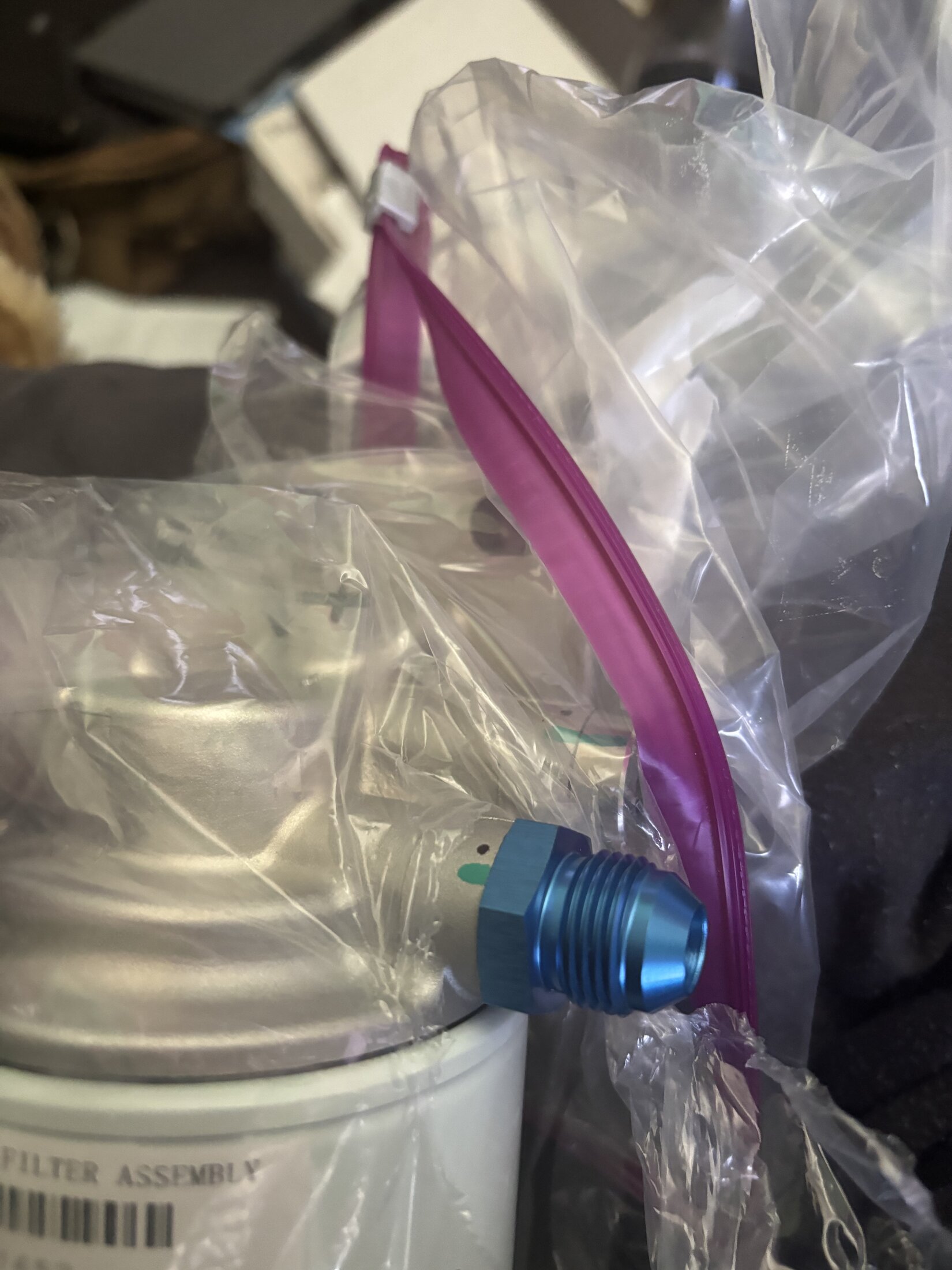

Removed the fittings provided with the fuel filter head and kept the O-rings and reused them with the new M14x-8AN fittings and installed in the head.
I measured the thread diameter and checked the thread pitch and compared to chart found on line to come up with the metric side, then searched for AN fittings that would work for my project.
Hose barb fittings
New fitting with O-ring fitted
Installed the new fittings in the filter head

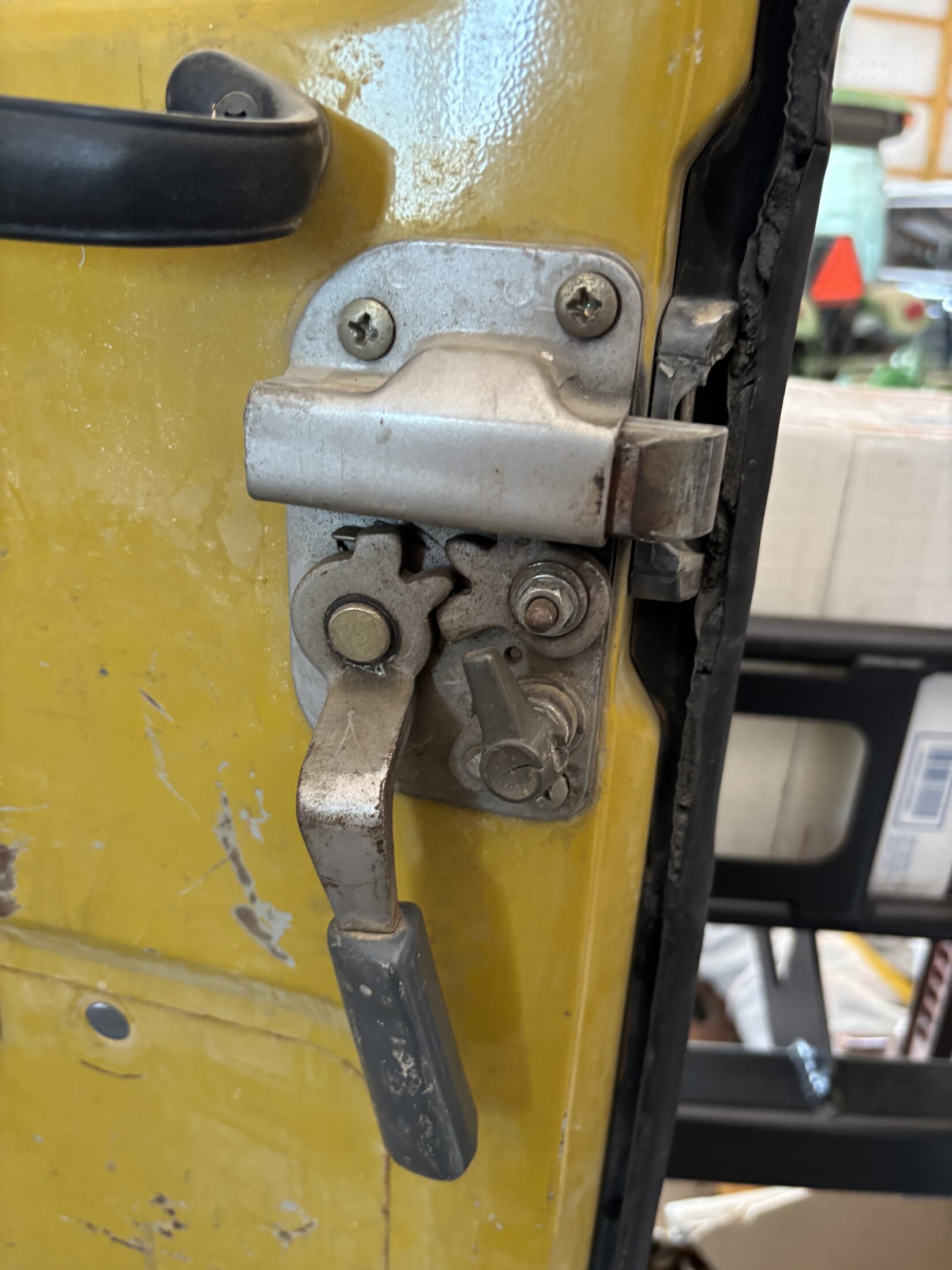

Tried to take the rear door latch off to replace the lock and the nut behind the lock lever wont come off just spins so I just put it back together so I don't loose the parts.
Open to suggestions on how the remove the latch to get to the spring clip holding the lock to the exterior of the door. I saw that the seals are all dried out and need to be replaced.

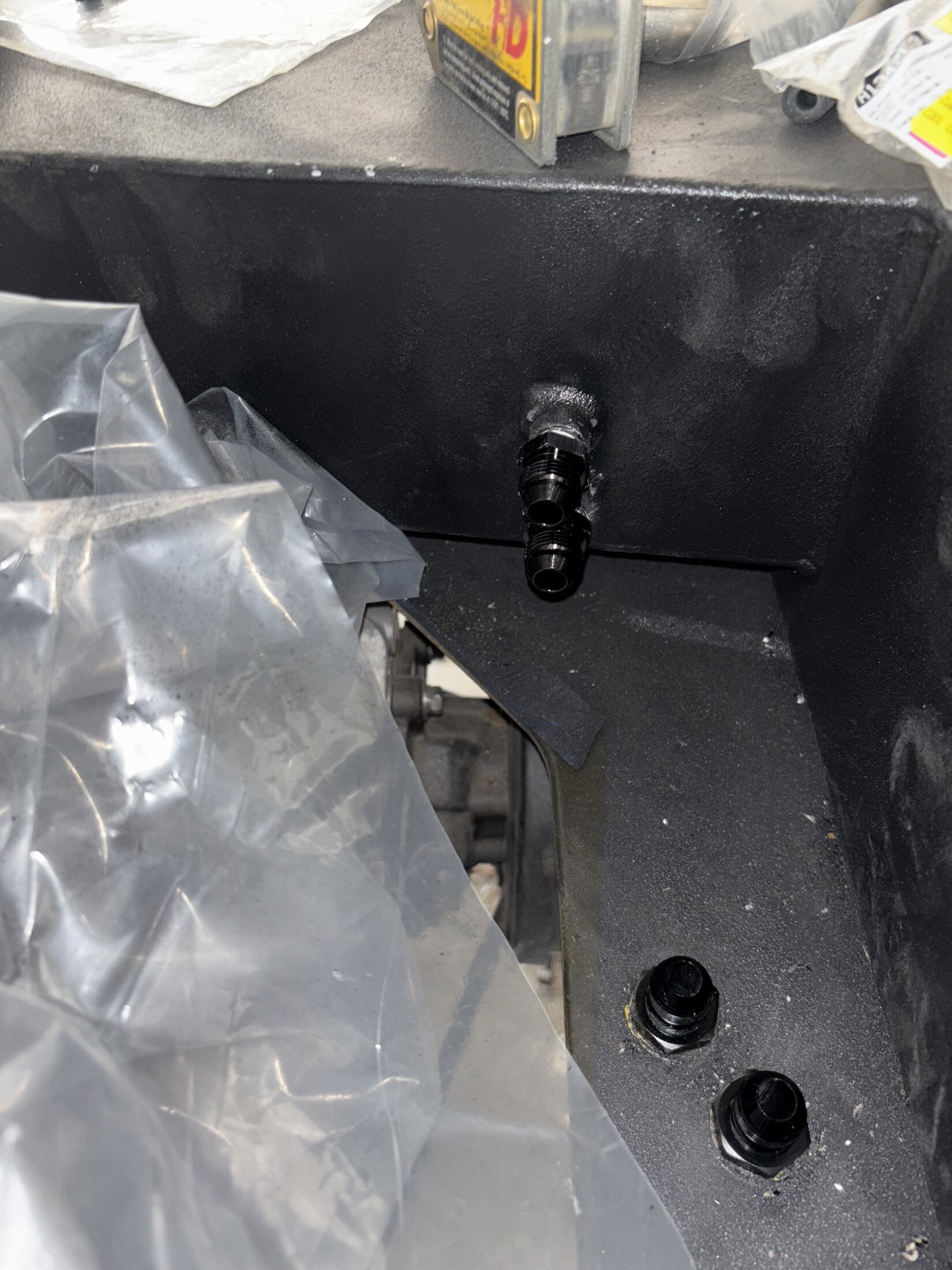

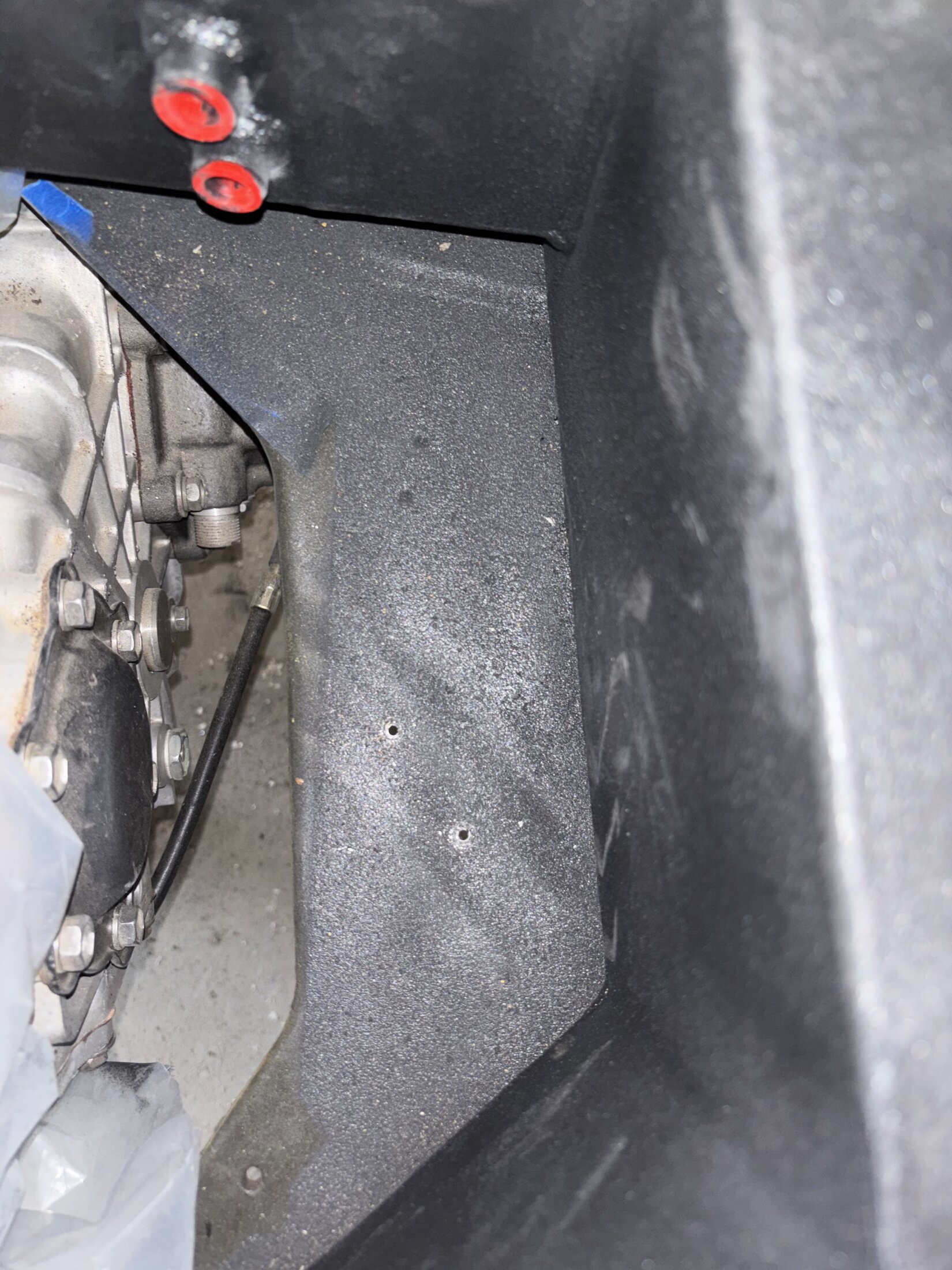

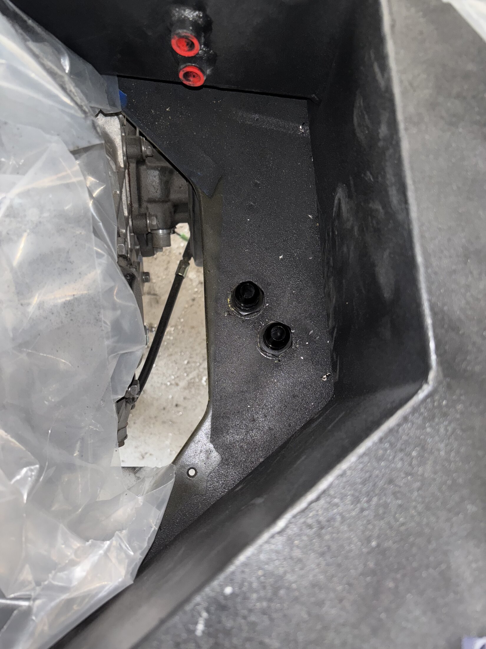

Drilled holes in the floor for the fuel lines and installed bulkhead fittings. Drilled pilot holes then punched them out to 3/4" for the fittings.
Installed the -8 AN bulkhead 90 fittings in the floor. Installed the -8 AN x 1/4" NPT fittings in the suction and return in the tank. Then masked them off until I start cutting and make up the hoses.
