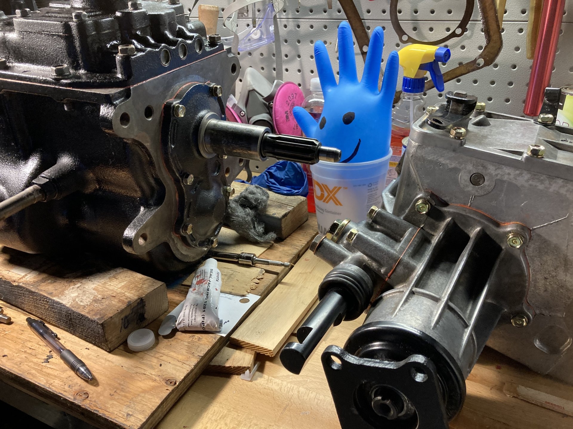

Rebuild of 4-Speed and Transfer Case
Did the jaws work? Worried about how thin they had to be to get in there.
I haven't pulled them yet. I am waiting for the Knipex plyers show up so I can get the last snap ring removed. FedEx tracking shows they will be delivered today.
One bearing on the input shaft is driven out by using a punch and it moved easily, but until the counter shaft bearings are pulled the input shaft won't come out.

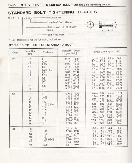

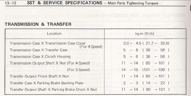

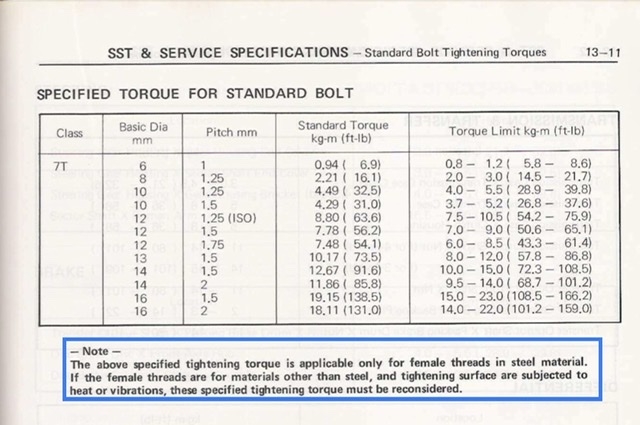

This is a great post. Thanks for walking us through it. Do you have the torque values for the tcase and transmission covers? I’m finishing up my 1979 4 speed/ tcase combo and have read conflicting information.
The number on the head of the bolt corresponds with a torque chart in the Repair Manual for the Chassie and Body.
Transmission and transfer case cover bolt torque=21.7-32.6 ft-lb
This is a great post. Thanks for walking us through it. Do you have the torque values for the tcase and transmission covers? I’m finish up my 1979 4 speed/ tcase combo and have read conflicting information.

try to find Toyota Land Cruiser Repair Manual for the Chassis and Body #99154.

The torque charts in chapter 13.
Posting torque settings from SST here. The below highlighted in blue says that the numbers on head correspond to torque settings in chart but only for steel. The transfer case is aluminum so the values must be reconsidered...

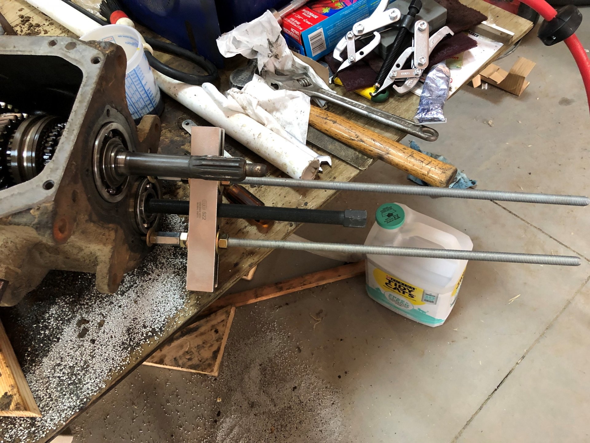

I think I can make up a all thread with a nut coupling and bolts that I can pull straight like it did separating the transfer case from the transmission. If not I will take to a shop to have the bearings pulled.
  1. I have thought out how to build a SST 09950-20014 with the puller I separated the transfer case because it pulls straight and is rigid and will be able to set it up with 2 hands. The 2-jaw set up was a Monkey and Football situation.
    I will get some
    • G-8 all threads
    • 4 nuts
    • 2 washers
    • 2 coupling nuts
    • 2 bolts that I will grind one side of the head off so it will go through the hole in the case on each side of the bearing race then rotate the bolt
    • 2 more nuts and two washers and once the bolt is rotated so the head is pulled up against the race inside the case torque the nuts against a washer and the case and race outside
    • Attach the all thread to the bolts with the nut couplings and then attach the puller bar and snug up the nuts on each side of the bar​
    • then I should be able to apply torque to the jacking bolt​

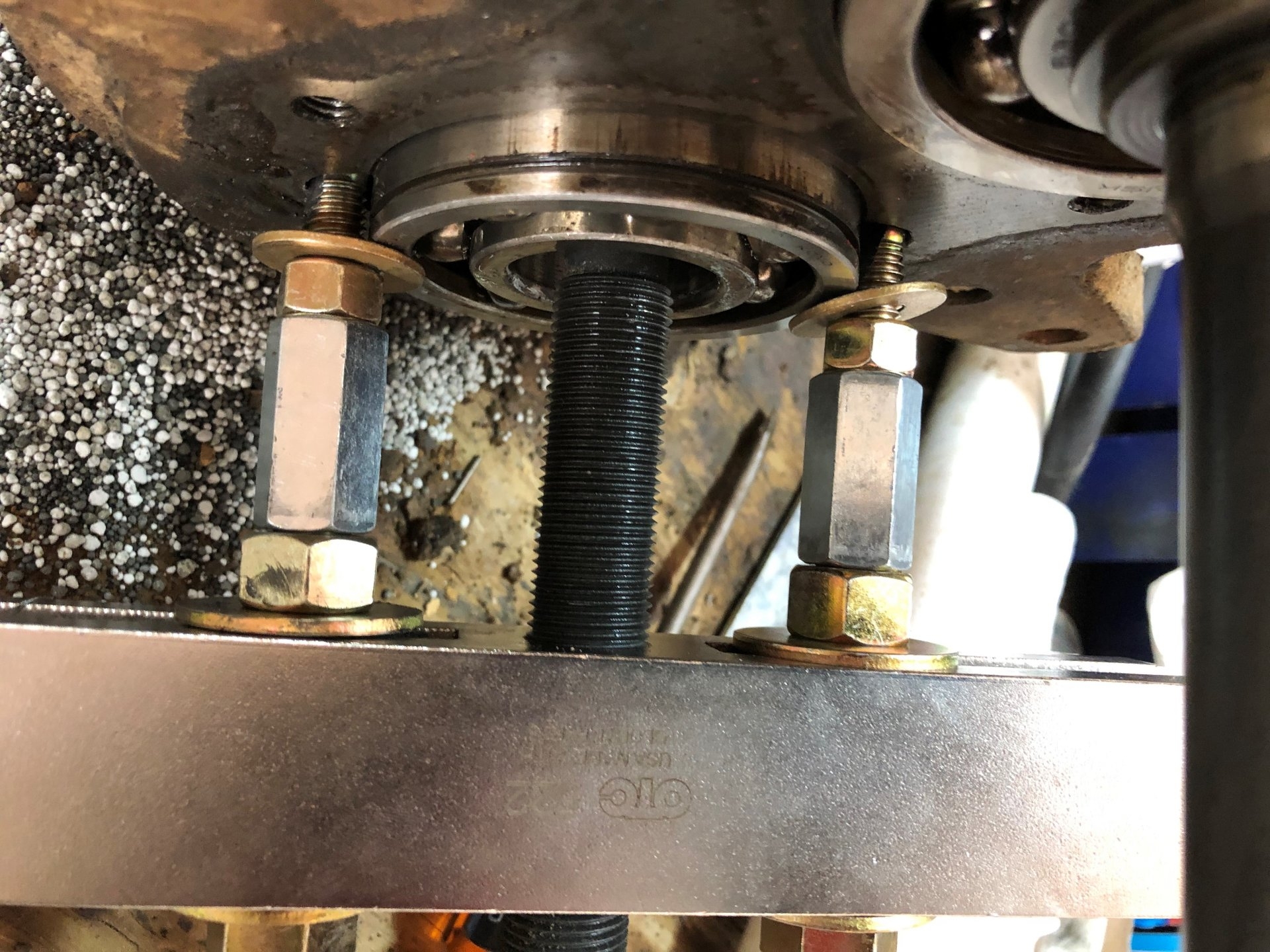

Worked on pulling bearings today with limited success.
I got some grade 8 hardware and two 1/2x3/8 coupling nuts and 3/8" nuts, a stick of 1/2" all thread with 1/2" nuts.
Spent the day doing a lot grinding to get the 3/8" bolt heads to go through the half-moon holes in the case and hook to the back side of the bearing races. I was able to get the counter shaft bearings removed except for the inner race on the output end but the outer race came out.
The input shaft came out once the counter shaft was out of the way and gears were out of mesh.
Had to grind on 3/8" bolts some more to work on the output shaft bearing, but by the time I got them both to fit through the half moon holes, one had lost its hardness from the heat of grinding and you not stay in place against the race and would rotate and slip off the back of the race.
Will get another 3/8" bolt and grind to get the profile to pull with.

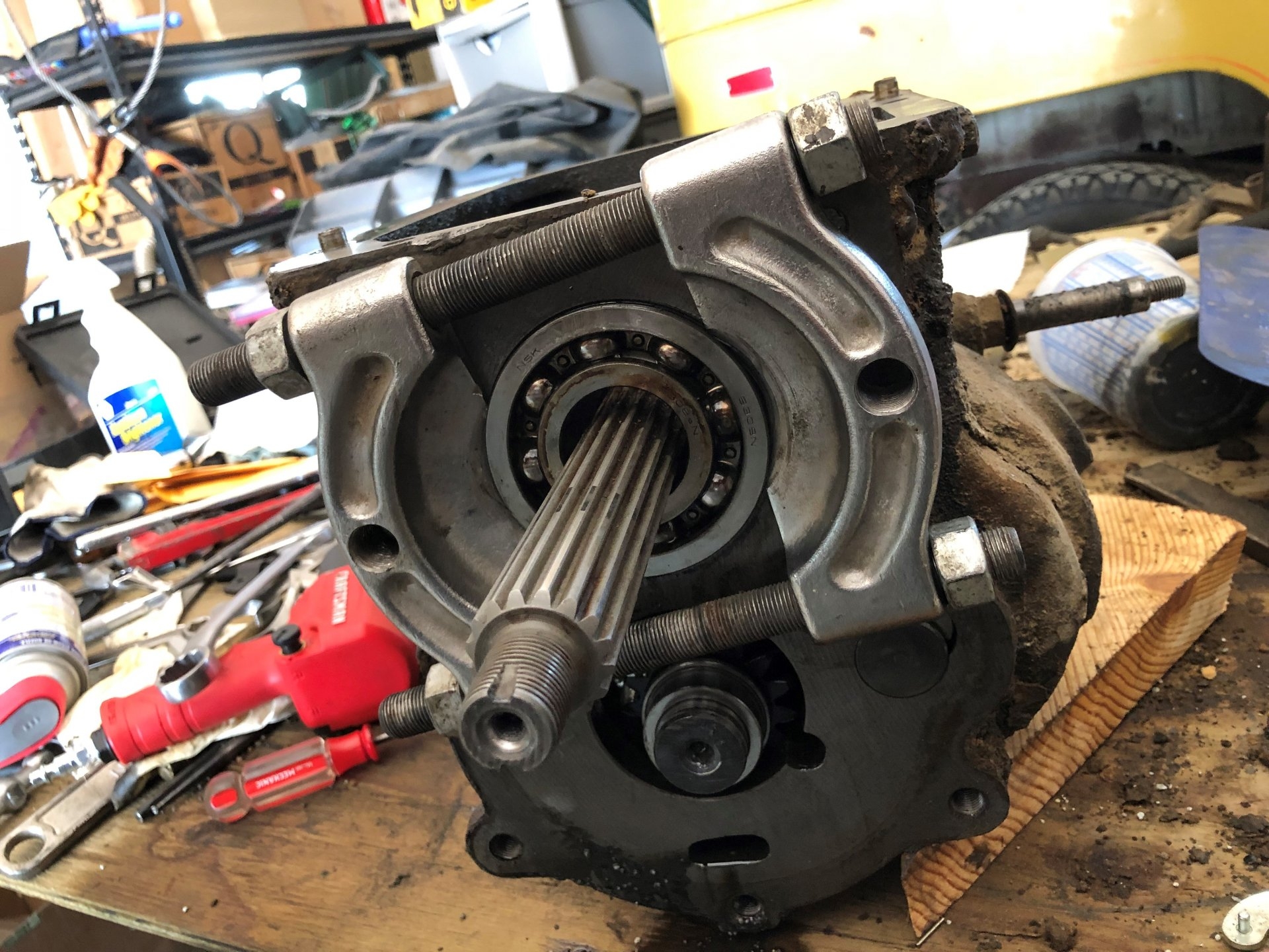

I have a clamshell puller loaned to me and I will get two jacking bolts and see if I can get the race to move in the bore of the case.
The Allen Head 5/8"-18 TPH arrived today from Granger by FedEx and went out and get them threaded into the clamshell puller and cranked on the by hand with a Allen wrench and got the bearing out of the casing bore.
I would like to thank Bob's Auto Equipment shop in Riverton, Wyoming for loaning the pullers to get this bearing removed.
