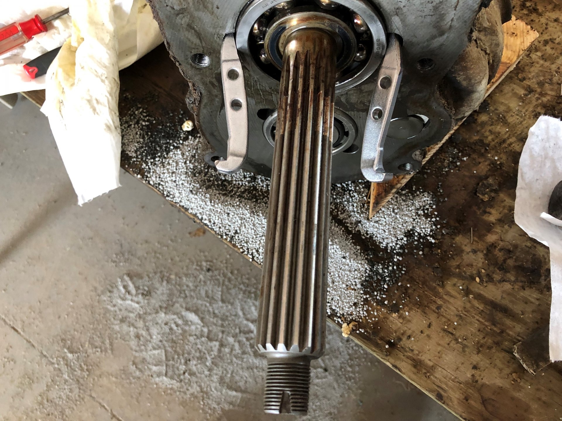

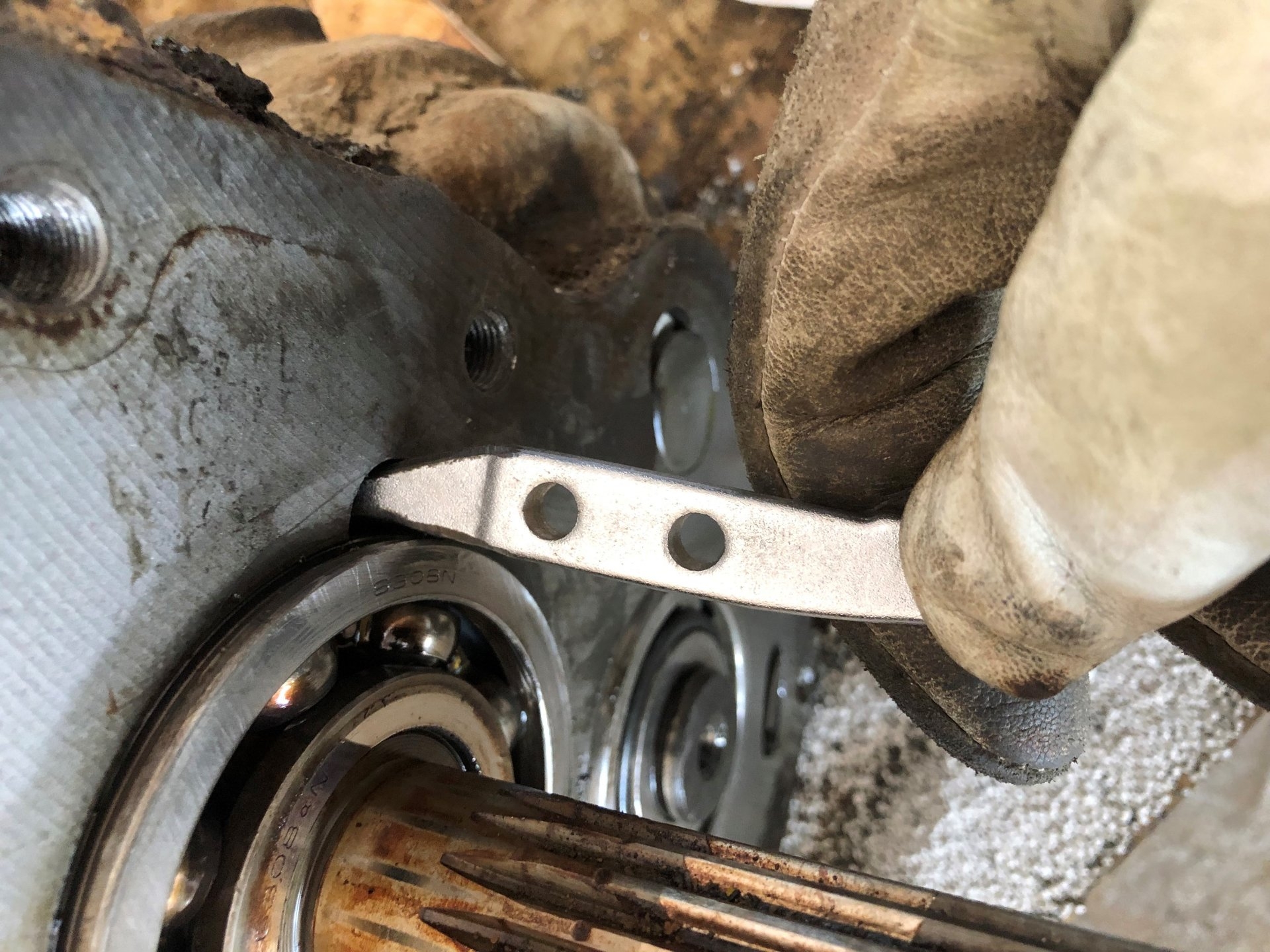

I had a bearing puller set delivered, but every jaw was too large to fit in the holes in the case to get jaws behind the bearing race.
So I ran to NAPA with the Toyota repair manual to show them what I was trying to do. I also took the smallest arm in the kit to show that it has to be smaller to fit in the hole in the case. Well, I came to the conclusion that I would have to modify the jaws to a profile that would go through the holes and get behind the bearings.
COMPARISON OF THE THE JAWS BEFORE AND AFTER GRINDING THE PROFILE TO FIT IN THE CASE HOLES
JAWS BEFORE AND AFTER GRINDING A NEW PROFILE TO FIT IN THE CASE HOLES TO PULL BEARINGS.webp
PROFILE 2
THE FIRST JAW THAT FIT
BOTH JAWS FIT
Will attach to the puller after the last snap ring is removed and start pulling bearings and shafts.
