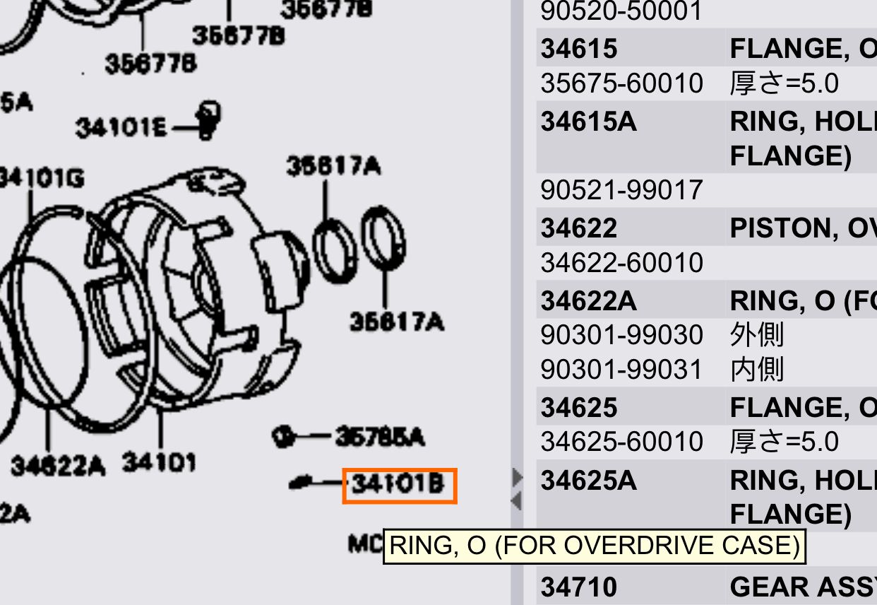

Upon dropping the pan I noticed a small o-ring. Looks to be a o-ring that goes between the cages and the transmission case. There is 6 o-rings in total. 3 orings for the cage that goes where the oil pump connects to and 3 for the cage in the middle.
The o-ring is whole and intact
So possibly it fell out upon sliding the cage in place.

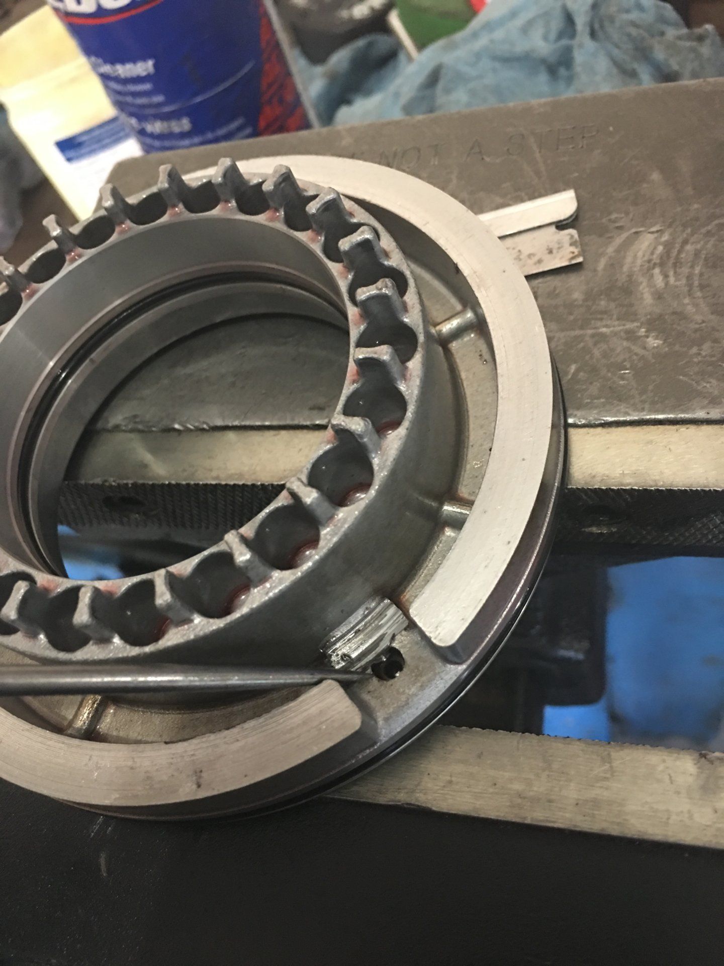

update its been a couple of busy days... and my OCD kicked in could not sleep so I pulled the tranny out inspected it again finished around 4 am. the problem was rear clutch. it was out of spec and the clutches and plates got burned.
all o-rings were in place. and I'm glad I had spare parts kicking around.
The Toyota manual says 5 discs and 5 plates. I was able to get in 6 plates and 6 plates of steel for the rear clutch and all is well.
With 5 plates in there the piston was able to move too far and caused a groove. In the piston.
