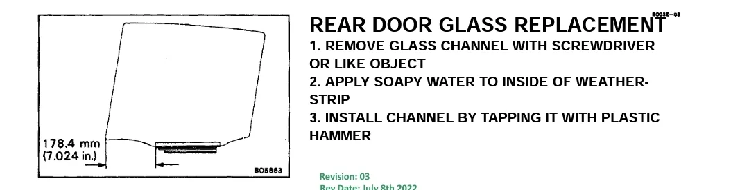

I don't see anyone posting the correct placement from the FSM, so here it is:
I'm looking at this same image in my 1994 Service Manual, but I'm struggling to see how it could work.

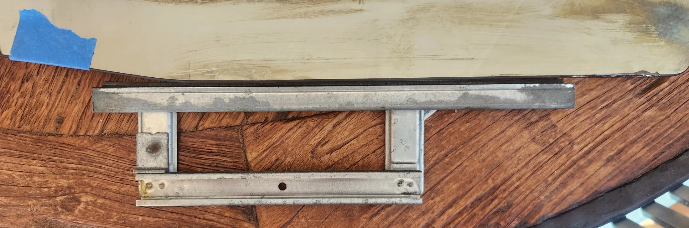

The right edge of the blue tape marks the 7" spot, but this moves the roller to the left when the roller was already falling off the right. It also doesn't fit in with the shape of the glass.
To keep the roller from falling out of the track I need to move it all to the right, to the 9 1/4" spot, as shown here:
This fits with the shape of the glass and aligns with a small vertical line left over from where the old rubber filler was, and moves the track to the right.
This image shows the original problem, where the wheel was coming out the right side of the track after the track appears to have slid left over the rubber. Moving the track 2" left to the specified position clearly wouldn't work. Is the service manual wrong? Am I missing something?
This fits with the shape of the glass and aligns with a small vertical line left over from where the old rubber gasket was, and moves the track to the right.

I found another thread where someone came to the same conclusion. The FSM measurement of 7" from the leading edge is incorrect. I just installed mine with 9-1/4" from the leading edge and the window is working as it should.
