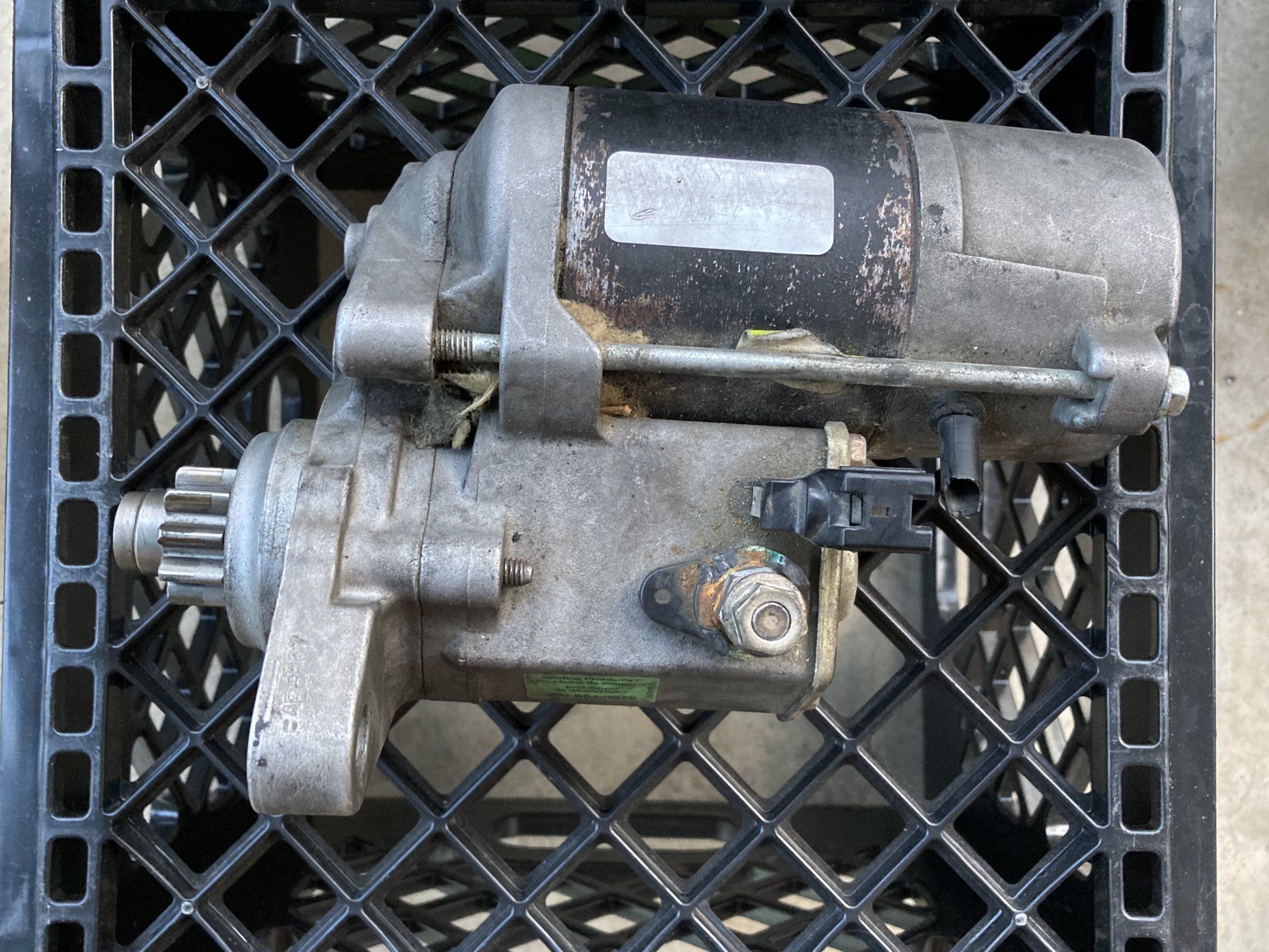

this is a miserable piece of s*** and should go out with the trash yes? or is there anything worth saving in this thing? if it is not denso i am not rebuilding it.

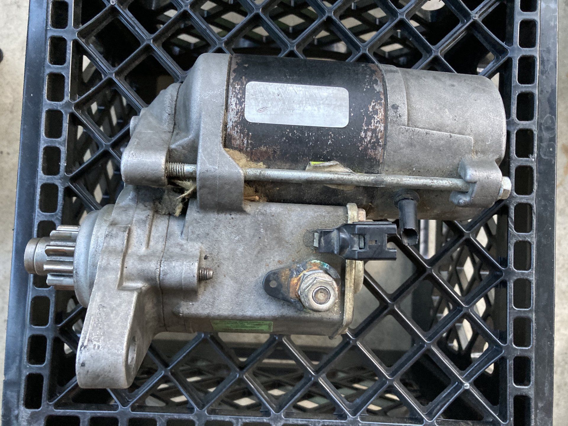

so that starter i pulled is not a denso i guess? or how do i tell? and do i do anything with this one?

That looks like an AC Delco 800 number. Re: the wobble sockets, you can either buy a whole set of wobble sockets or a specific size when you're stuck on something, or buy a 3/8 and 1/2 drive wobble joint/adapter. It's the same thing as your classic universal joint only it's a pinless design that's similar to a CV joint, so it doesn't bind up the same way the pinned ones do. It's more expensive to buy a whole set of sockets with that joint built into them, and I've only encountered a couple of instances where there wasn't enough clearance to fit a socket with a wobble joint stuck into it (just like your universal joint). I think the wobble adapters usually go from one size to another with a wobble joint in the middle. Hence the "adapter" in the name, since they're adapting 3/8 to 1/2 or whatever. Vs the wobble joint is the same size on both ends, i.e. 3/8 to 3/8.

so on the AC delco would someone buy it and rebuild it? or is there value or can i salvage anything from it?

Pull apart the solenoid and see what the contacts and plunger look like (copper parts). They might just need to be replaced. Then you'd have a good backup spare if needed.
