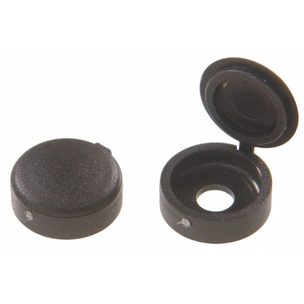

I removed mine on my 98 to work on a leak and decided to keep it off for now. I put screws in the empty holes with rubber washers and black screw-caps, for anyone who might not feel like painting etc. I think it looks fine. Can post photo if anyone wants. Just another way to go. They're an easy pick-up at big box hardware stores:

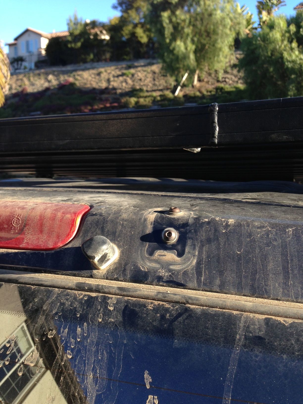

Here's a shot of mine (a 2003) after spoiler removal. No leaks or rust after a couple years. No noticeable impact on how dirty the rear window gets. No change to mileage. No apparent traction/cornering/downforce change. Looks better IMO and allows me to use the space under the rack to store a camp table which would be tricky with the spoiler in place.

Guys, please tell me why my 10mm bolts are just spinning in place. My spoiler was snapped off and I want to remove the brackets. But the 10mm bolts holding it in wont come out! Any ideas?
I have the same problem on two of the four bolts. I’m pretty sure there are some sort of sleeves that the bolts screw into that have come loose on the hatch. The welds holding them in place probably broke loose. No idea how to solve since you can’t access the area inside the hatch. I’ve tried. Hopefully somebody has a solution.
Our 2002 LX470 had the spoiler removed and brackets in place when we purchased it. Nutserts/Rivnuts spun when I tried to remove one side. I split the plastic bracket right down the middle by heating a utility knife, cutting down the center of the top of the bracket then wedging a straight screwdriver in the cut. The bracket split in the middle and came off the bolts. I then was able to grip the top of the rivnuts with a needle nosed vice grip and unscrew the bolts
