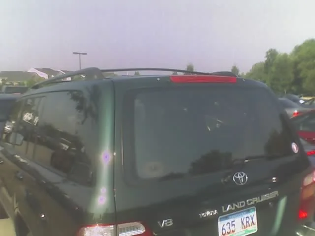

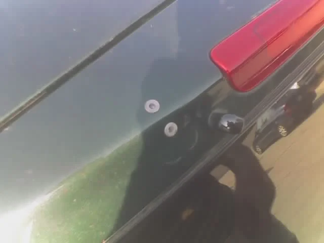

    Last night while messing around with the factory rack, I decided to take off the rear spoiler to see what the holes look like. Since I'm going to remove the rack, I wanted to remove the spoiler too.
    The spoiler was easy to remove. On both the right and left sides are a mount that is attached to the rear door and to the spoiler. To remove the spoiler, first remove the four alan head bolts. They can be removed with a 4mm alan wrench. Once you remove these four bolts, the spoiler will lift from the rear door.
    At this point, you will see the two mounts that are bolted to the rear door. They are held on with two bolts each. They take a 10mm socket to remove them. That's it, the spoiler is gone. The remaining holes are pretty small. I am going to buy some small flat screws to fill the holes and then I am going to paint them with touch up paint. If this doesn't look good enough, I may have the holes filled and painted by the local body shop.
    I have attached two pics, one up-close of the holes (I took the pic standing on the bumper looking down at the holes) and one pic from a few feet away to show the end result. I will add a third pic once I paint the screws.

    Greg, those look like nutserts. If you put a screw in them, water can still get in around the edges. I recommend you use larger rubber washers that cover the nutsert completely. Then put a stainless steel rosette washer over that with an application of silicone sealant between the layers. And finish it off with a stainless steel screw. You can probably paint the hardware though I'm not sure how well it will stick to SS.
    Do a search on the 80's board for roof rack, nutsert or rosette and you'll see plenty of info.

    I'll take a look at the 80's forum, thanks for the advice. If I can't get it to look right, I'm going to have the holes filled and painted at a local body shop that I go to.

    Greg, the first one sounds easy and cheap to do it.But think twice when the rain comes after while maybe month or year it will create rust there.
    If i were you ill go with the second one, which i rather pay lil extra $$$ and choose which body shop be able to match the paint (reccomend one) and close the holes for good.

    I removed it on my 04. I put the allen head bolts from the spoiler back into the nutserts and used Duplicolor touch up paint.
    Looks great, unless you know something should be there you would not notice.
