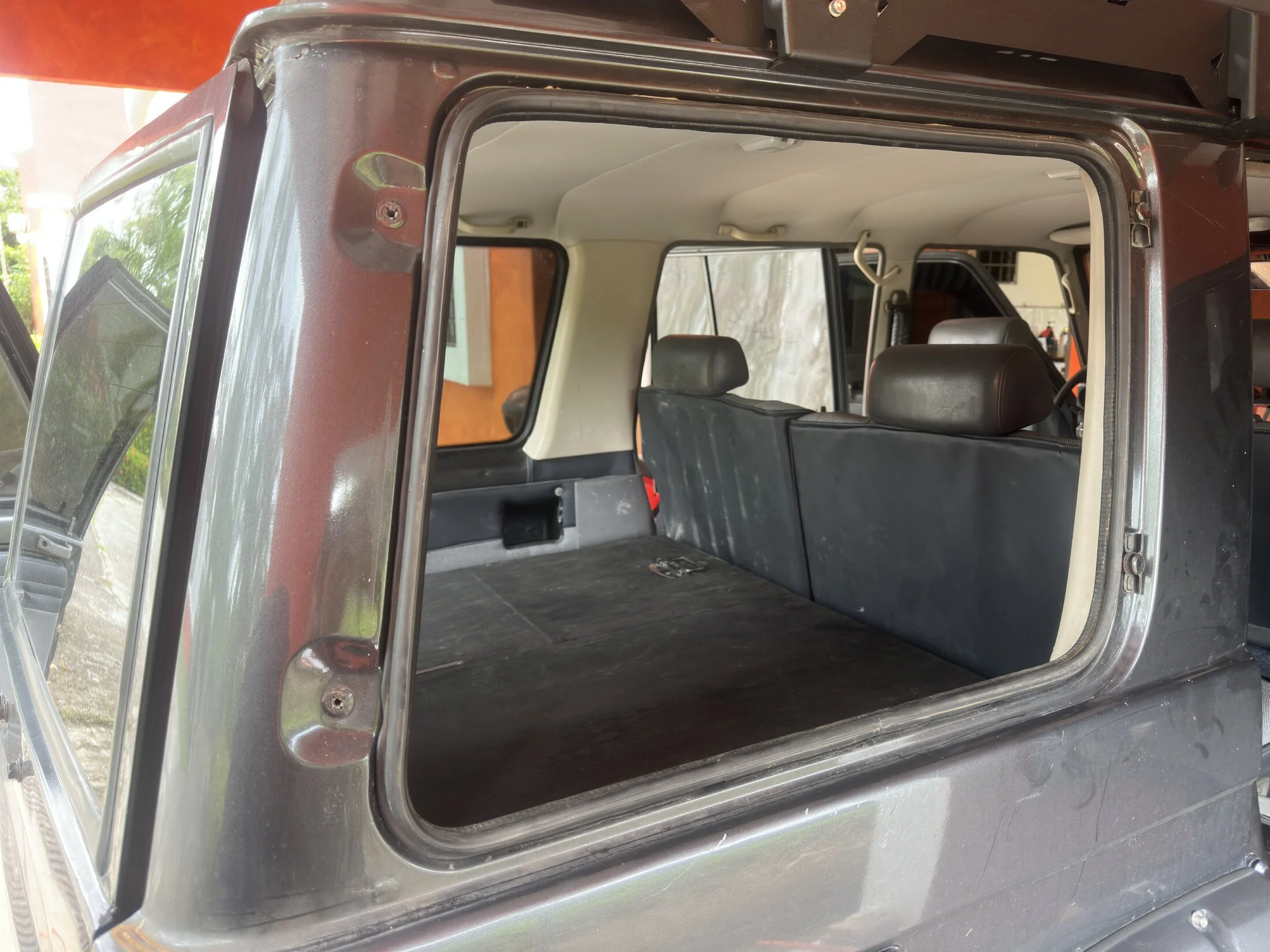

I own a 1991 LJ76 and recently cracked my passenger rear right window. I contacted MegaZip and Amayama for the OEM replacement window but they out of stock. My search then brought me to Front Runner Outfitters 76 Series Gull Wings which have quoted me for the pair. My first choice is to replace with OEM and maybe @joekatana or @Guyute have the right passenger window for sale. Attaching a few photos to help identify the part. I live in the Republic of Panama.

I'm not ready to part with mine.

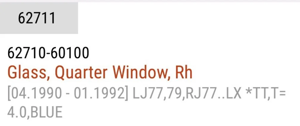

Recently found a few parts on Tosshin that were listed out of stock on Partsouq and Amayama. The shipping is a gamble as they don't quote it up front. But for glass... to Panama you're going to pay dearly anywhere.
Search result by "62710-60100" | Tosshin - https://tosshin.com/en/search.html?partNo=62710-60100
Or check with Japan4x4. Dave is a living legend and master at efficiently shipping stuff - stedman@japan4x4.com

Much appreciated. I will reach out to both.
