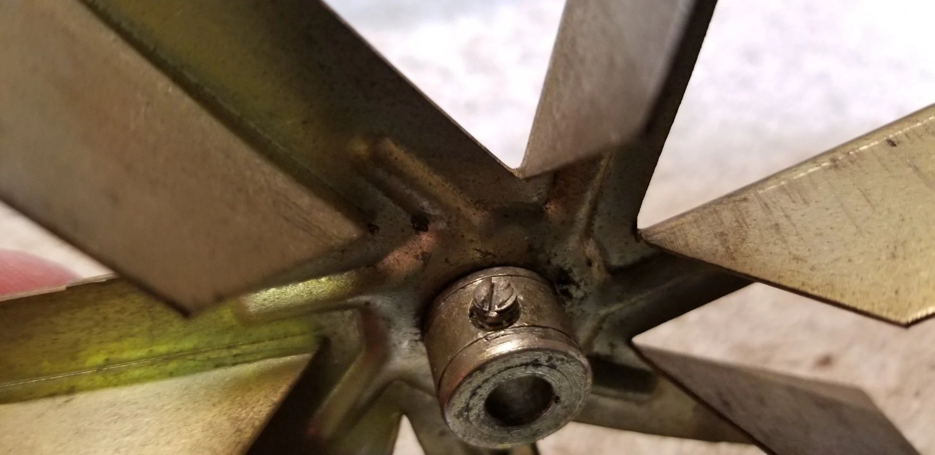

Trying to rebuild a crunched rear heater on my 4/72 Pig and the fan is free spinning on the motor shaft, was there a set screw there? shaft is not drilled thru to pin it. I appreciate the assist.
No idea if it is the same as a 40 series but here is a pic of one I am just now sitting here cleaning up.
Small set screw on fan. Shallow indentation in shaft.
