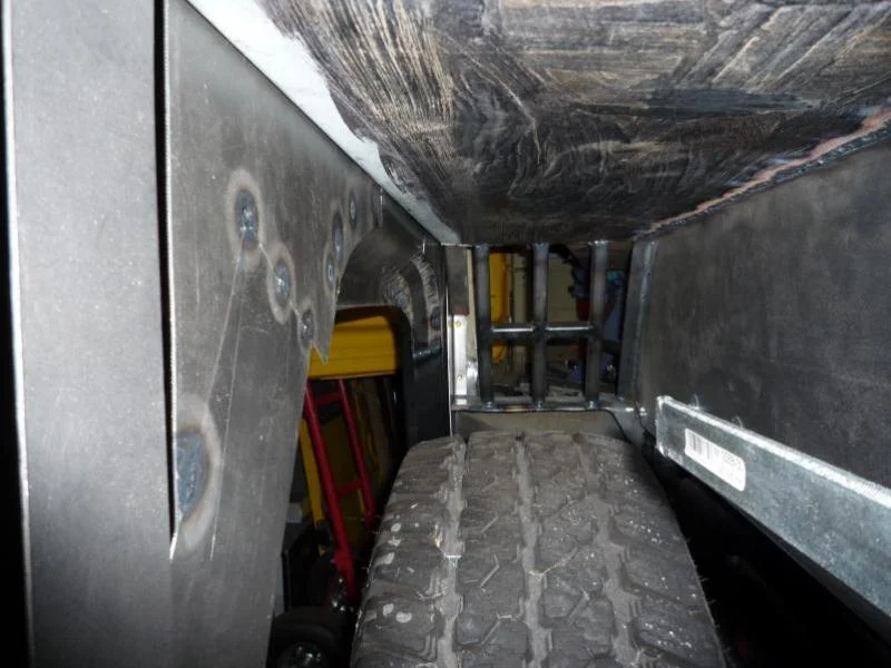

Just curious on this picture:
attachment.php
If you tuck the rear tire in via a rock or bump, it looks like it'd connect with the inner body pretty quickly. Not much room for error. Are you going to be going to narrower tires or a spacer to push the tire out a bit to account for this?

It just looks like that but your looking at a clamp in front of the camera lens. The distance is the same as original.
