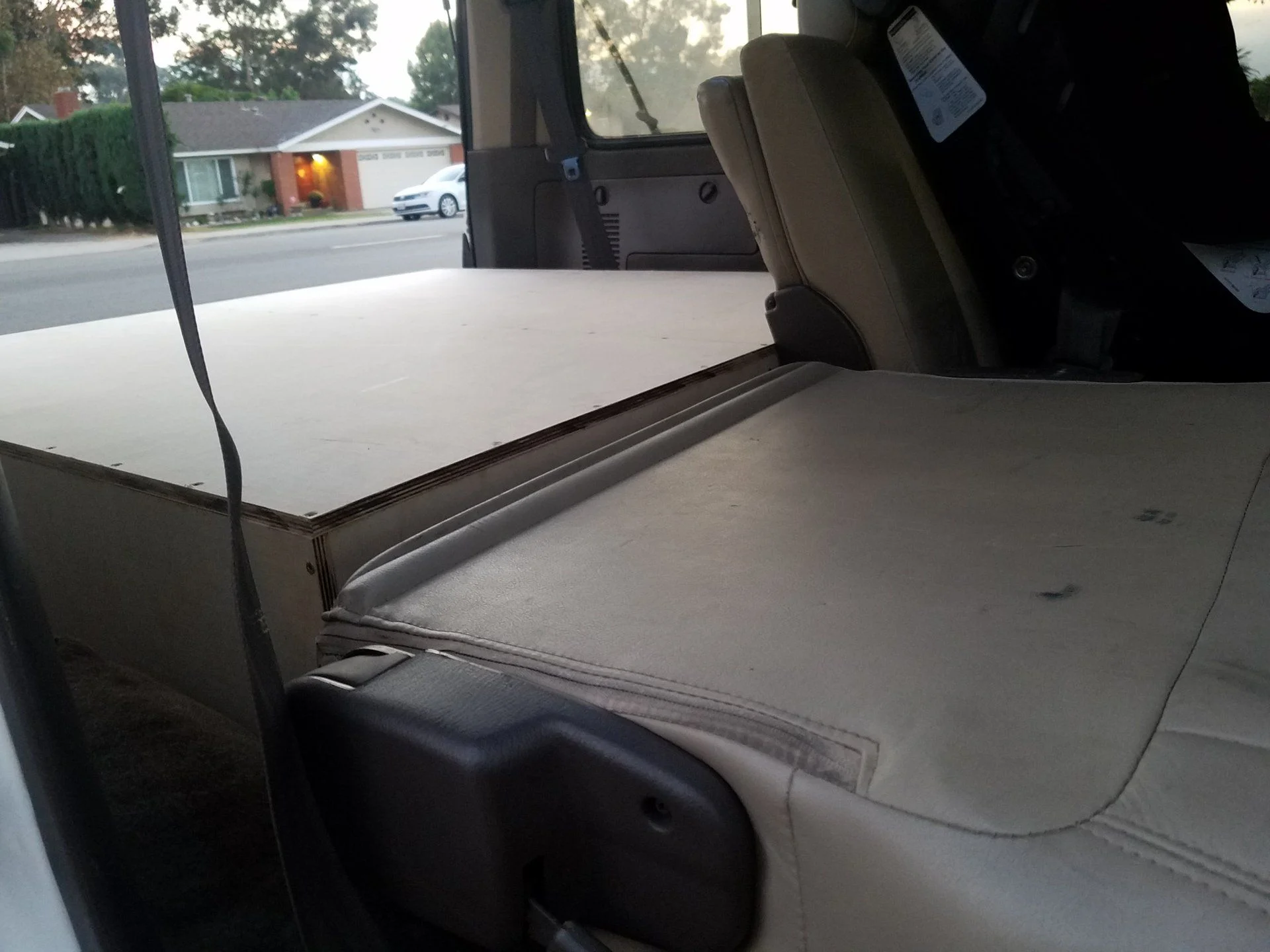

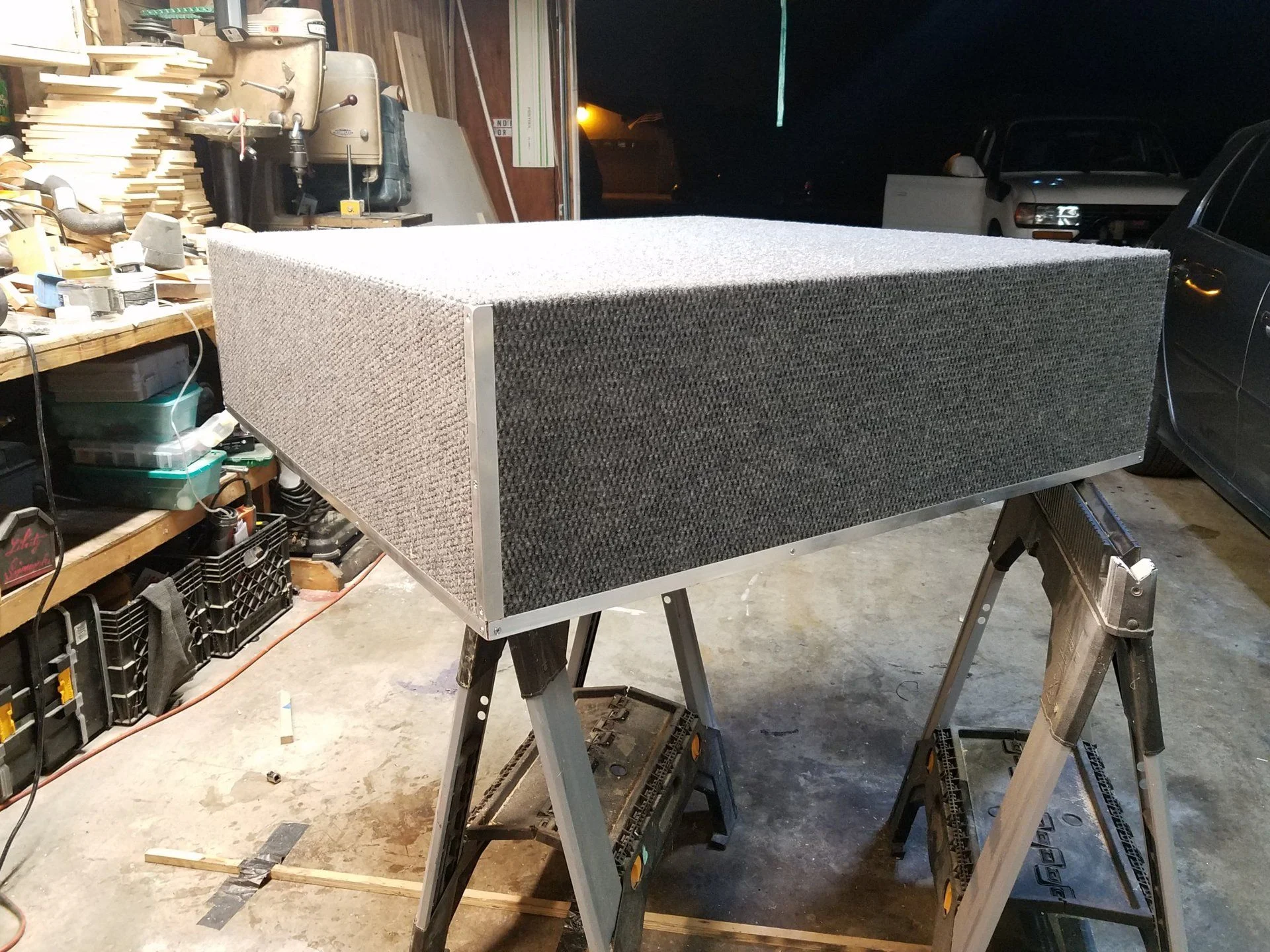

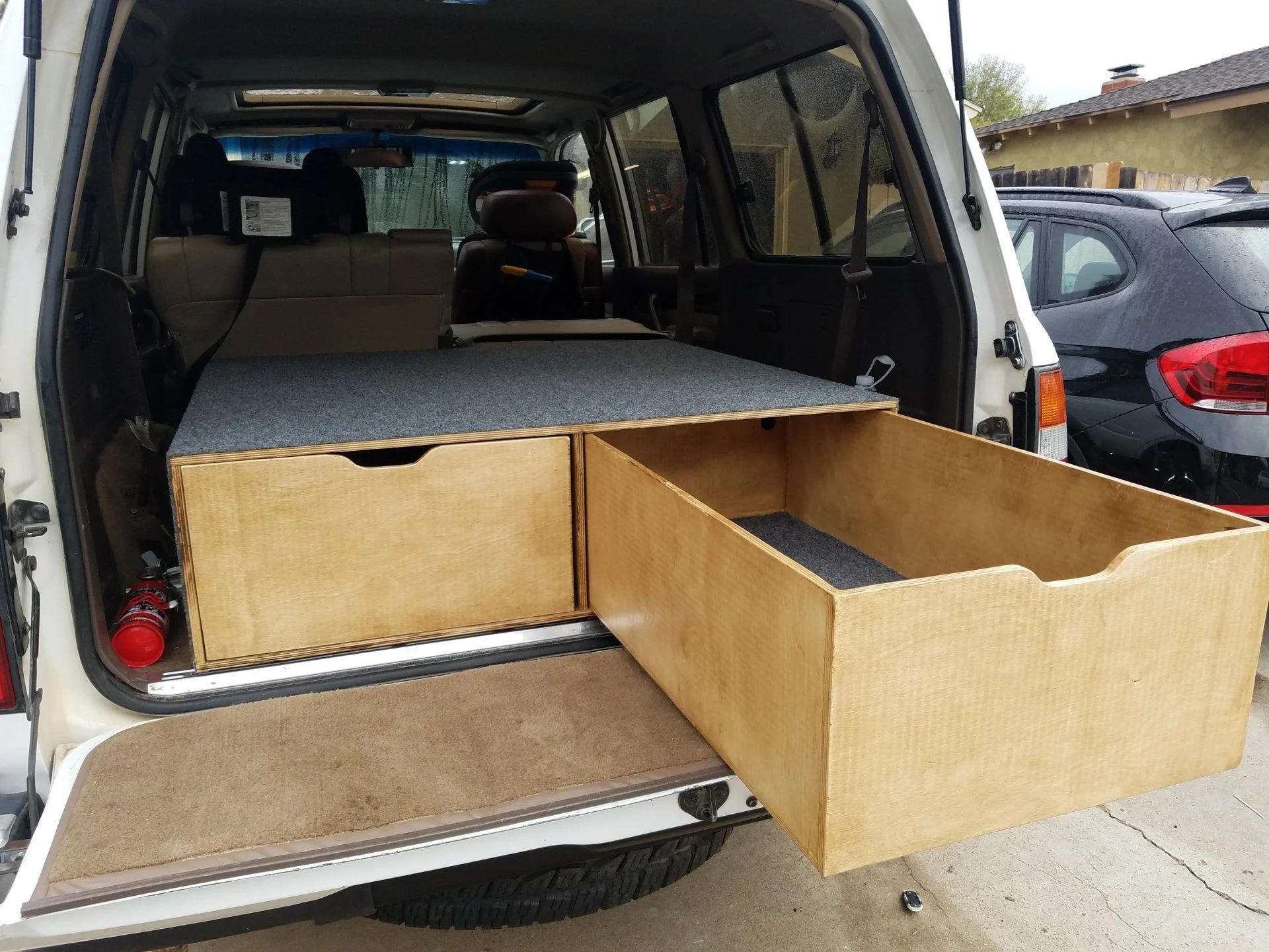

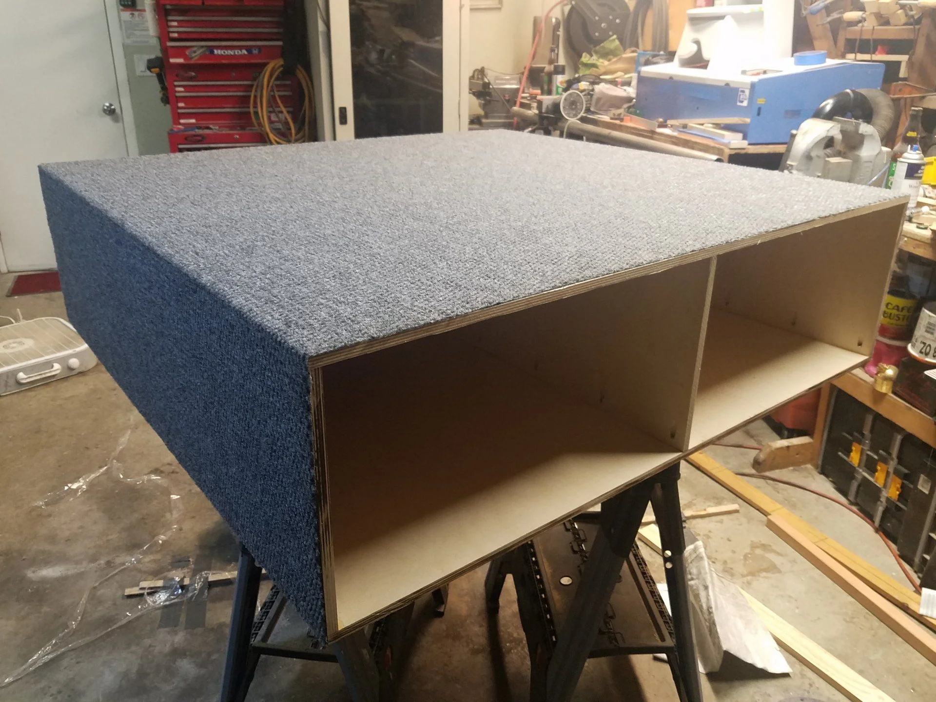

The week of Thanksgiving our family of 4 is doing a trip from San Diego - Las Vegas - Death Valley - Yosemite - San Francisco. The last couple of trips we slept in a tent. I missed sleeping in back of the 4runner. This seemed like a great option. 1/2 birch plywood. Drawers slide great, no rails more storage space. Aluminum edging were needed.

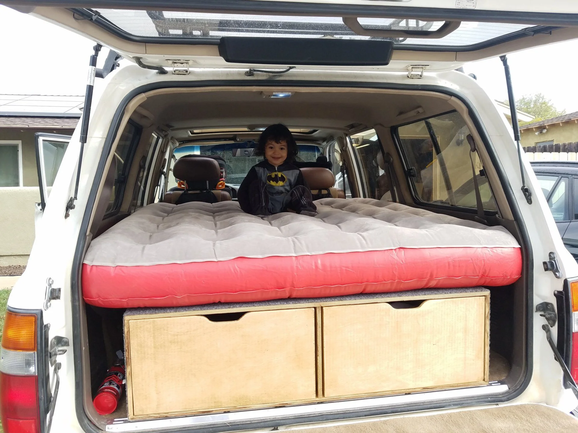

I took a gamble and did not add the wings, we inflated the mattress and tried it out. We don't think the wings are required.

In the last photo, with air mattress, are your 2nd row seats folded forward, or are they removed? Looks good!

Seats are folded forward, going to need them to hold the kids.
What size mattress is that? Sorry for all the questions, but I tried putting a full size in mine, but with rear seats in it was too long. I prefer seats in also. Looks good! Mine is currently in pieces as I’m re-building my framework with aluminum angle to replace all the wood.

No problem, seats are folded from the top half only. It's a Coleman-single Queen. View attachment 1571671

*did you put anything down for the drawers to slide on? I didn’t and I have zero problems opening and closing them..... empty, full, sideways, on a hill, ..... never had a issue.
The Build is pretty much done! maybe some tweaks.
I didn't use anything on the drawers for sliding, I used a paste wax to seal and slide.
I did put a couple of holes in the back, I was getting some air suction, slowing down the movement.
