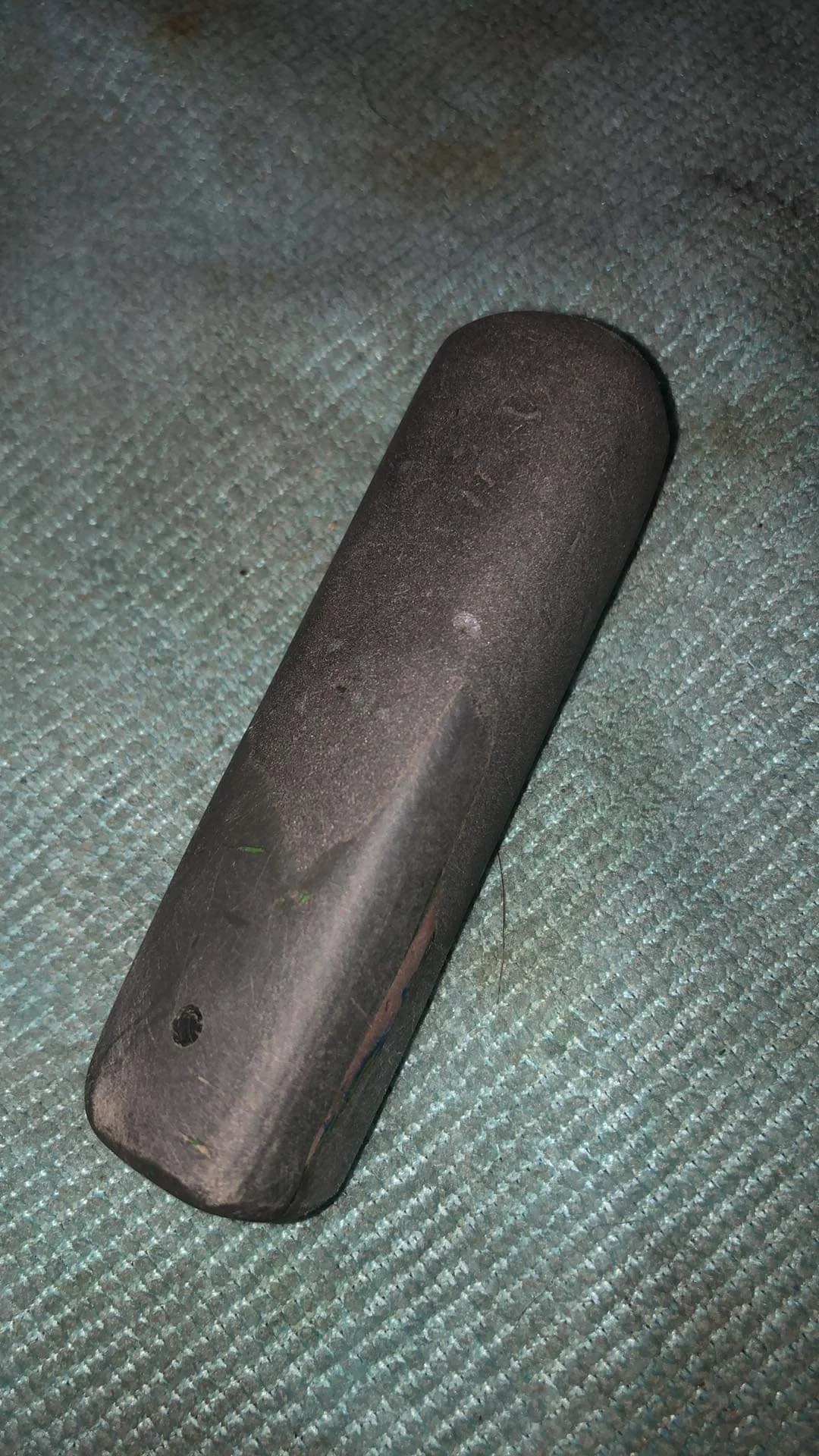

I recently acquired a 1978 BJ40 with a hundred minor issues. I’ve been sorting them out slowly.

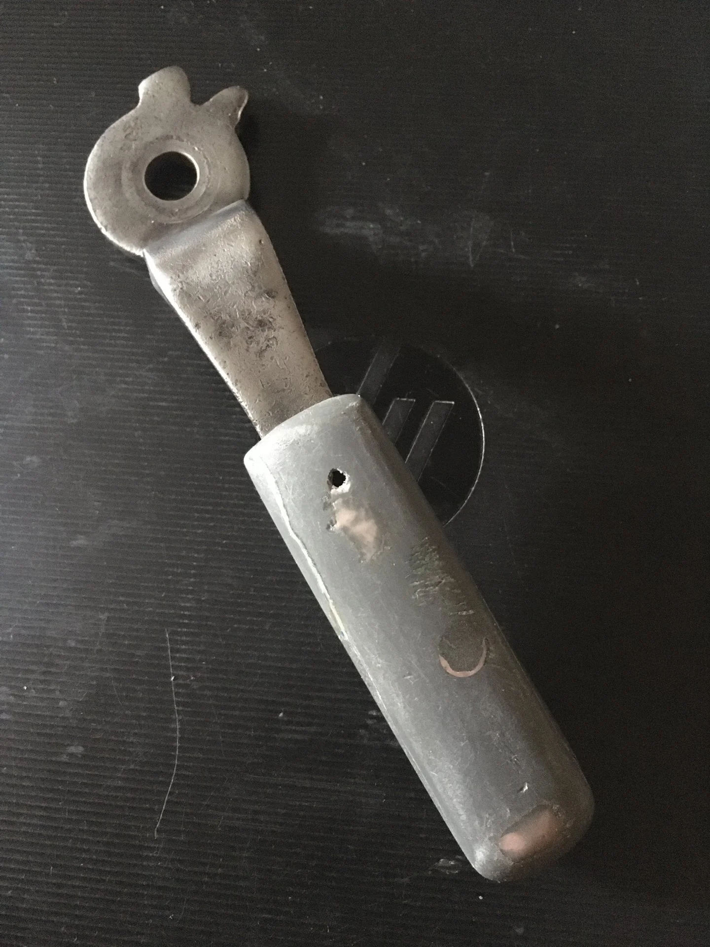

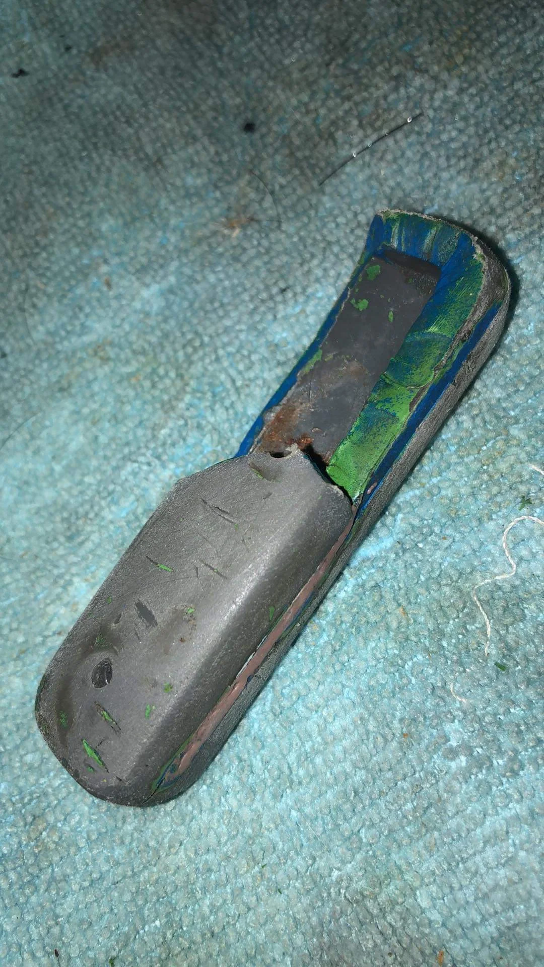

The inner handle of the right rear door was broken. You can’t buy the handle separately from the complete latch assembly. So I bought some epoxy clay for about $4 and fixed it. Now it just needs some primer and gray paint to be good as new!
