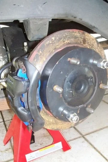

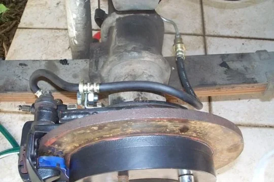

HI,
I did mine ones with toyota starlet caliper and solid rotor out a Isuzu tropperlike 4 years ago and still working great (photos before SOA)
