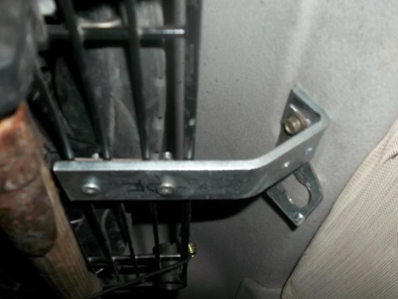

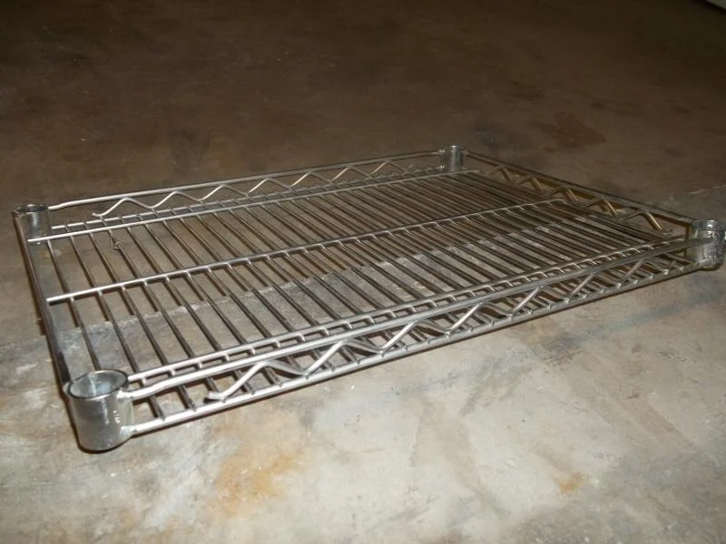

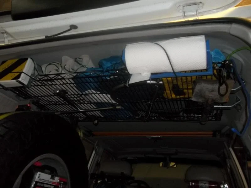

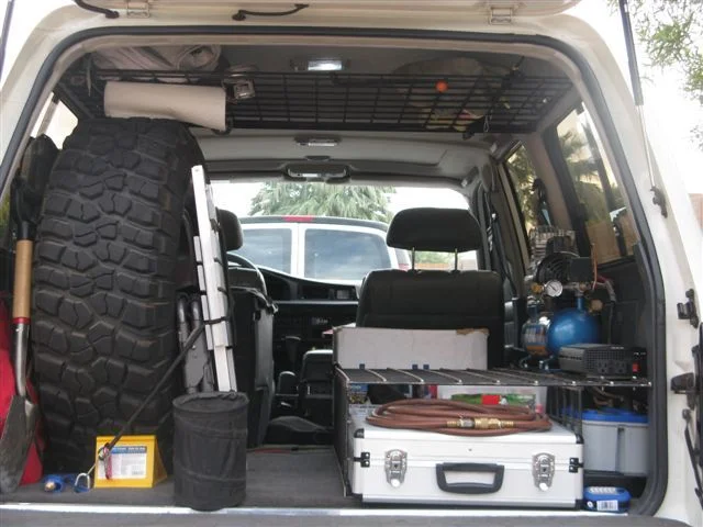

I used a shelf rack as pictured. The one I have is heavy duty as I had gotten these from a past employer as these were industrial brand but can get imitation ones from most places (HD, Lowes, Target etc). They may not be as heavy duty but your not carrying that much weight up there. sell these . The size I used was 24" x 42". I originally had it attached to the grab handles with hose clamps but it would wobble. I removed the grab handles and made some brackets that bolt in, attached shelf and now its sturdy.
Terry is correct mine was a garment display rack prior to the attic. My install started full ghetto with 3M zip ties to the handles above. I have since upgraded the mount hardware to hose clamps (semi-ghetto) but after many hard miles of testing it works well and will remain semi...

I removed the grab handles and made some brackets that bolt in, attached self and now its sturdy.
Excellent upgrade! A must it appears~

I have something very similar. It is a wire rack used in pallet rack shelves. I can get details and a pic for you tomorrow. If it works, you can have it.

I cut up a 4' x 8' section of vinyl coated stock fencing found in the outdoor section of Home Depot or Lowes. I have it on the sides also so I can hang things from them using HD's large caribiner clips. The sides support the top rack and I just put light stuff up there like extra clothes, climbing gear, rope, and a GoLight.
