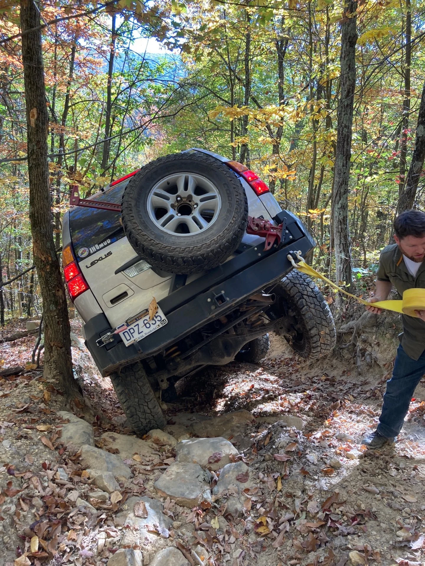

SSO is the only one I know of, they talk about making another run of them sometime. Here a few pics of mine.

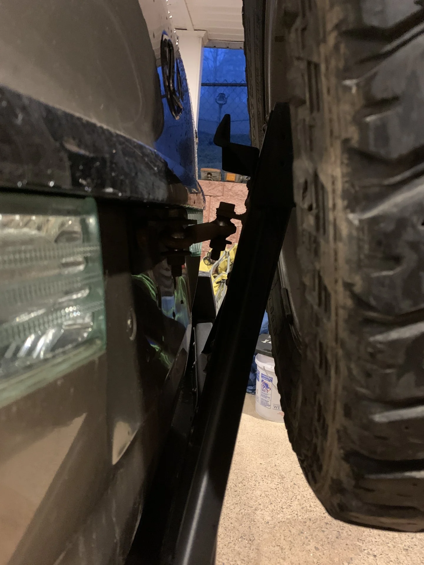

i made a tire carrier and added a linkage to the back door but ended up removing it. the linkage squeaked like crazy.
I also reinforced the door and welded a plate in the door with a nut. linkage bolts to that nut.
IMG_2417 by Alexander Rengifo, on Flickr
