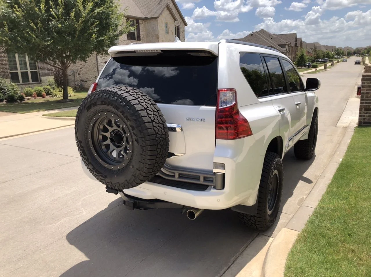

overseas the prados have the tire mounted to the door. theres a couple shops in the USA that make a kit to do this, but i cant remember their name.The door isn’t all that strong so I think this is asking for a ruined door.

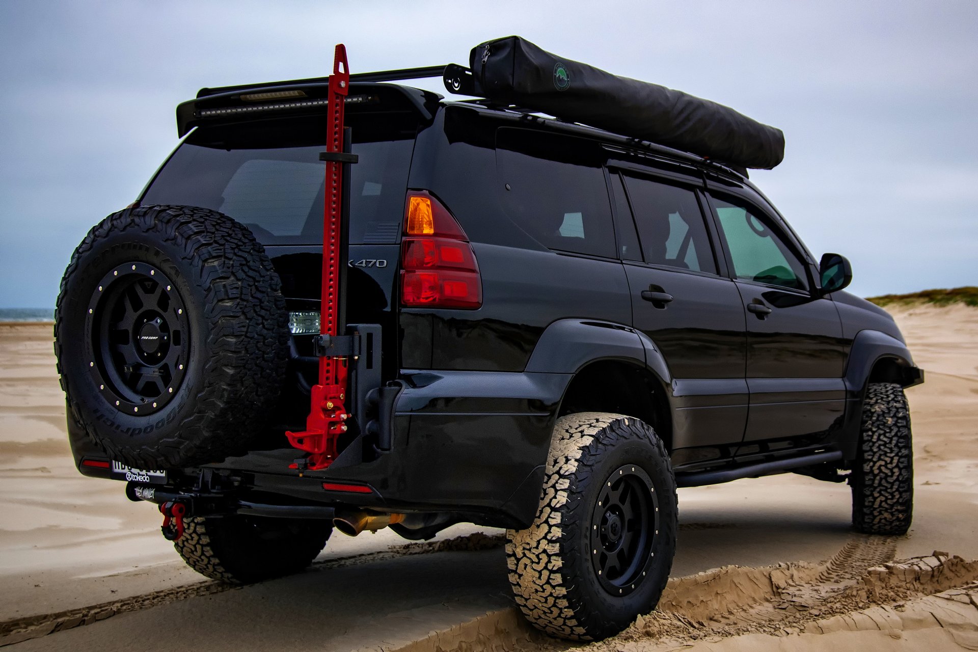

ACC Garage tire carrier. Similar functionality to JW Offroadwhat is becky
How did you get that tire carrier on there? Did u do it yourself, it looks really good.Rampage Offroad Jeep JK single arm over sized tire carrier. One hand operation, opens with the rear door. No issues. Should have the new spacers dialed in during Christmas vacation. Got lucky on a open box at Amazon for around $78.

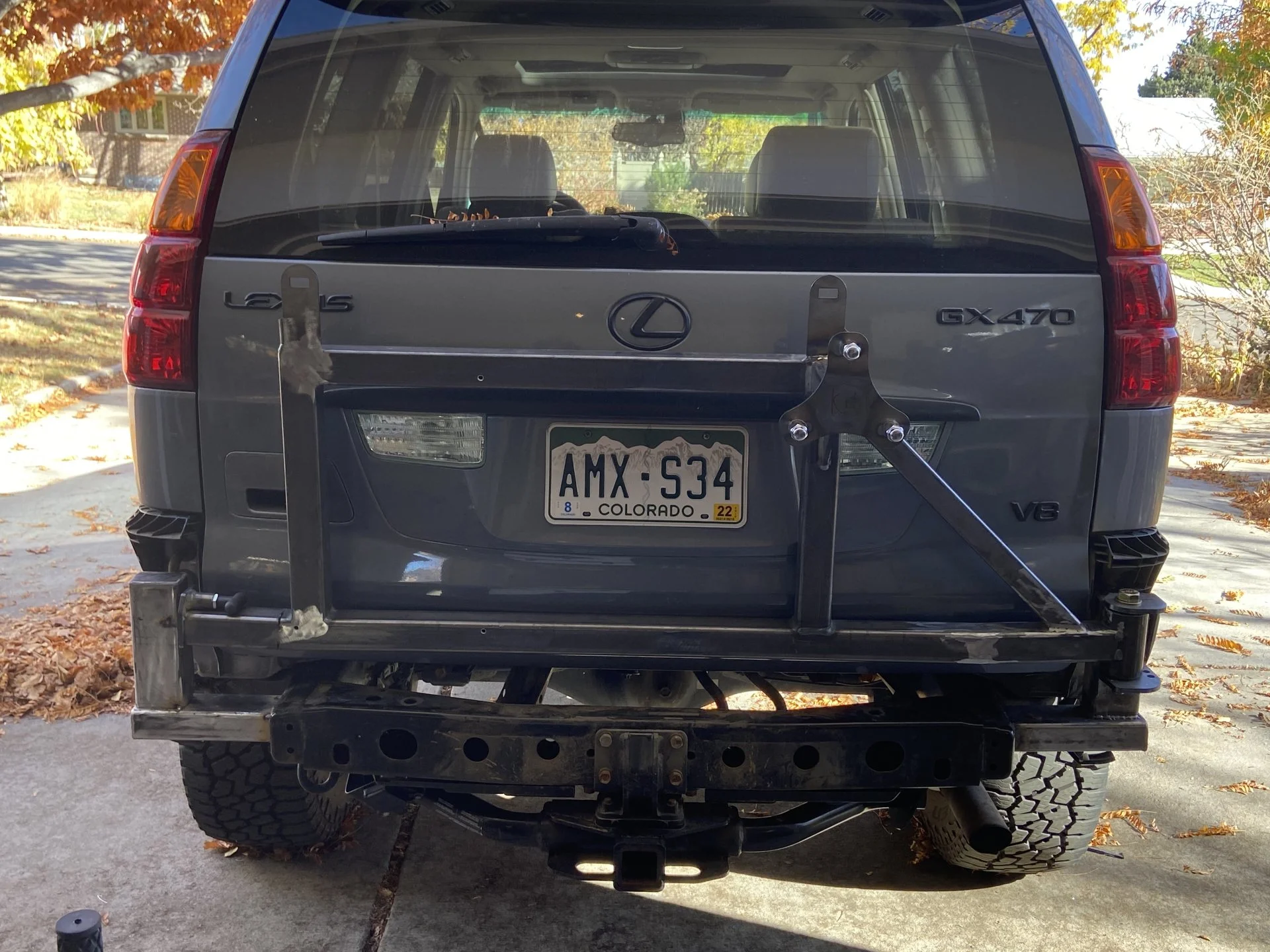

What size tubing did you use for the main member?I made mine, pretty straight forward. I really like the JK one posted though
View attachment 2868366View attachment 2868367

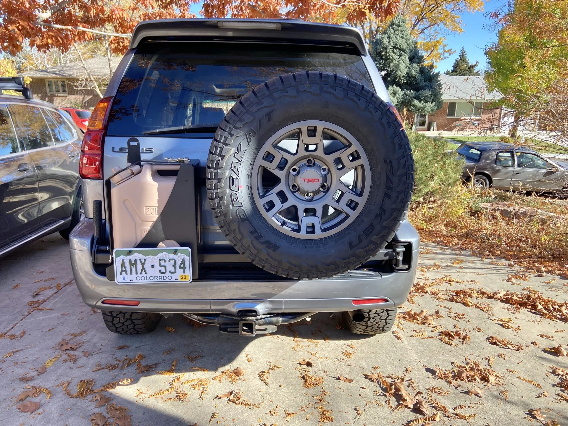

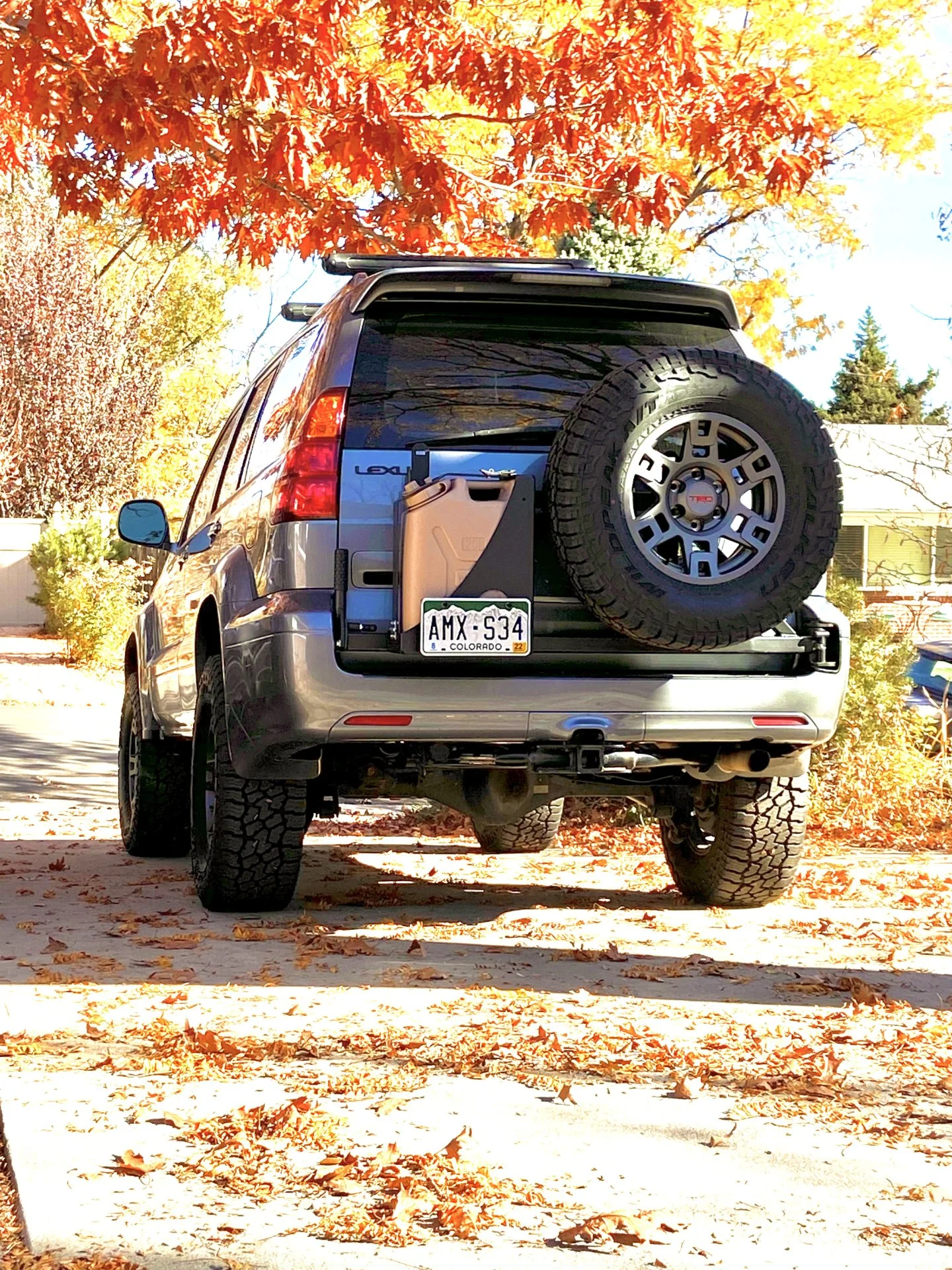

2x2 3/16” for the swing arm, 2x3 1x4” for the frame mounts. Overall it’s pretty solid. I used the 4xinnovations latch and hinge. Here’s a pic of how I set it up if that’s helpfulWhat size tubing did you use for the main member?
i am planning something very similar, same latch, but I am using a single shear pivot.
You definitely get more strength from connecting the tire carrier across the top like that. I was planning on 2x3x3/16 for the main beam and frame mounts. Awesome job2x2 3/16” for the swing arm, 2x3 1x4” for the frame mounts. Overall it’s pretty solid. I used the 4xinnovations latch and hinge. Here’s a pic of how I set it up if that’s helpfulView attachment 2868743
