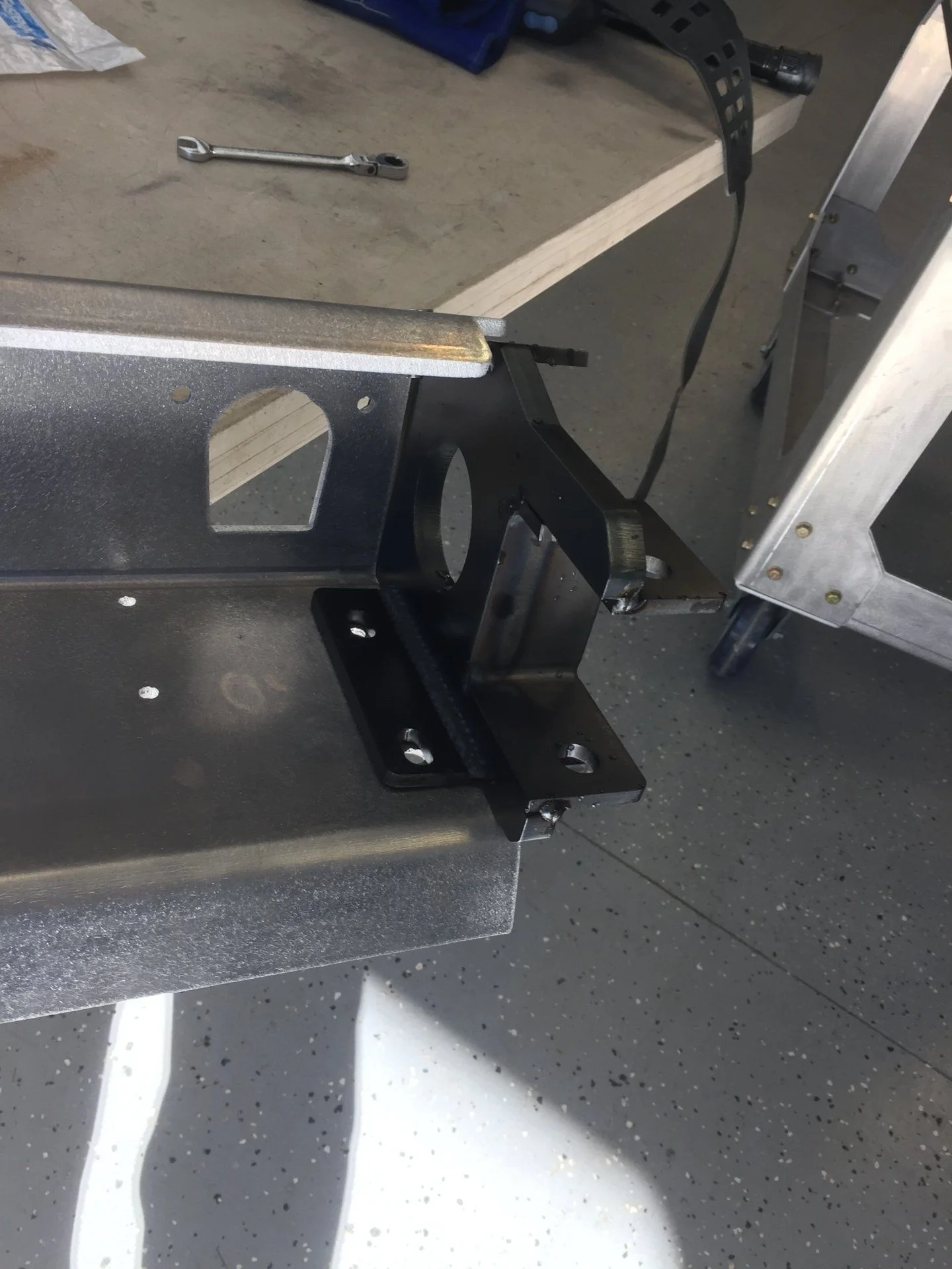

Here are some pics of some of the steel reinforcements that make an aluminum swing out bumper possible.
These 3/16" steel plates hold the captive nuts for the swing out hinge brackets, the bolts to a 1/4" aluminum gusset that runs all the way forward to the end cap. The end cap the bolts to the steel frame mounts that bolt directly to the frame.

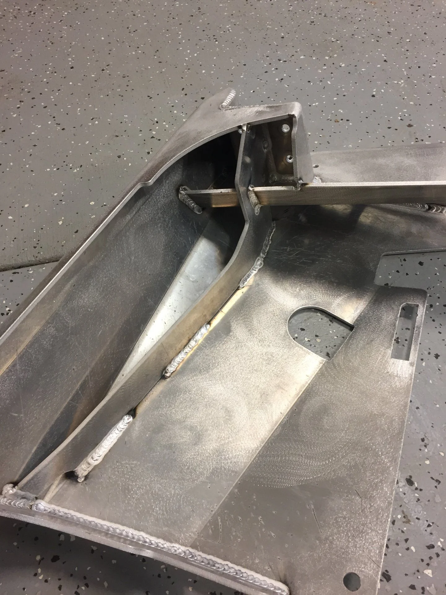

The wings themselves are a full wrap under design that bolts directly to the frame and the steel reinforcement brackets.

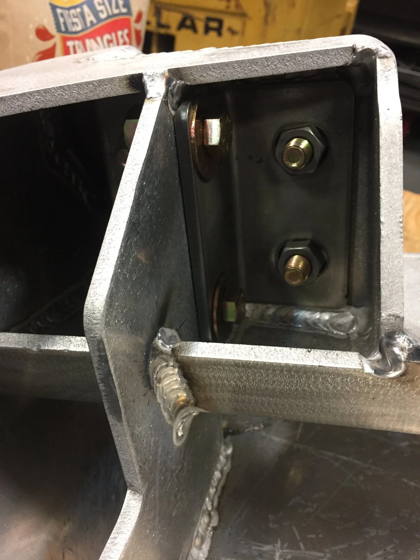

These are the 1/4" steel hinge brackets that sandwich the aluminum bumper and bolts to the steel nut plates.

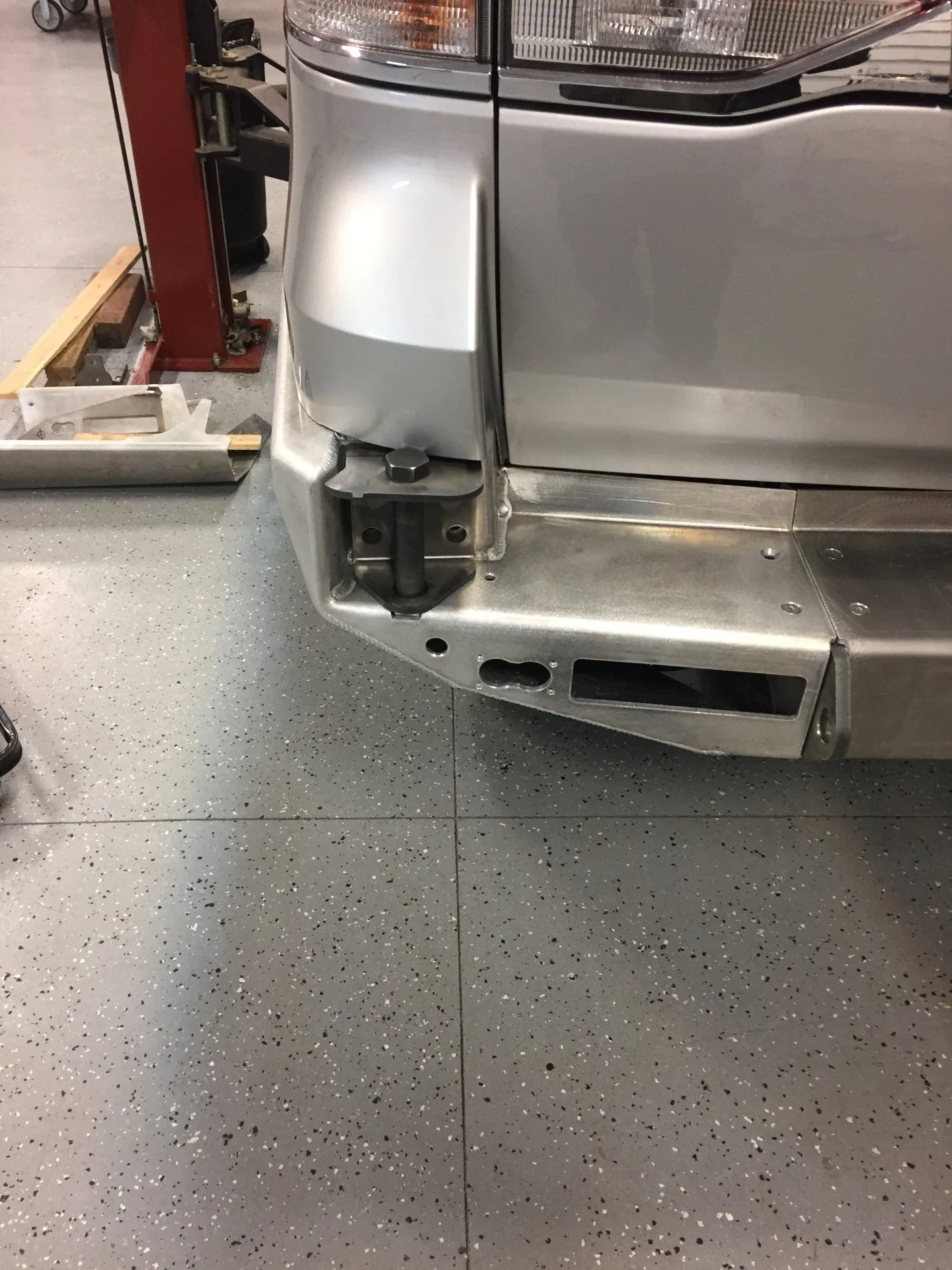

There are the steel recovery points that bolt around the crossmember and tie the 3 main pieces of the bumper together. These have changed a bit from this pic but should give an idea of the thought that has gone into building an extremely strong light weight bumper.
@benc that is metal artwork!! Beautiful!!
That’s an interesting aluminum/steel combo.
Don’t remember seeing one built like that.
Super curious to see one in person.
