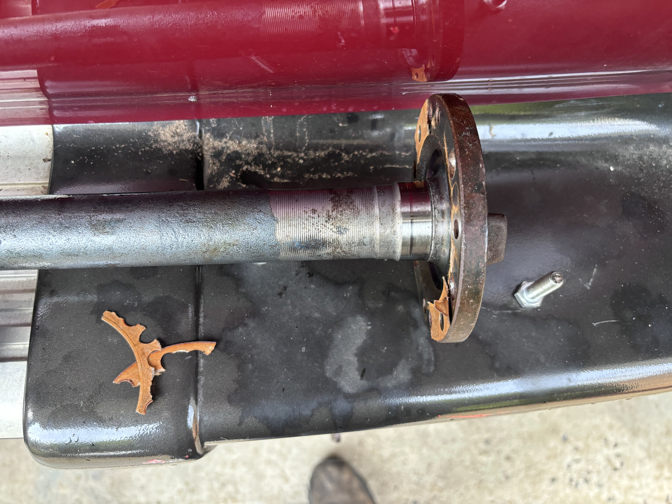

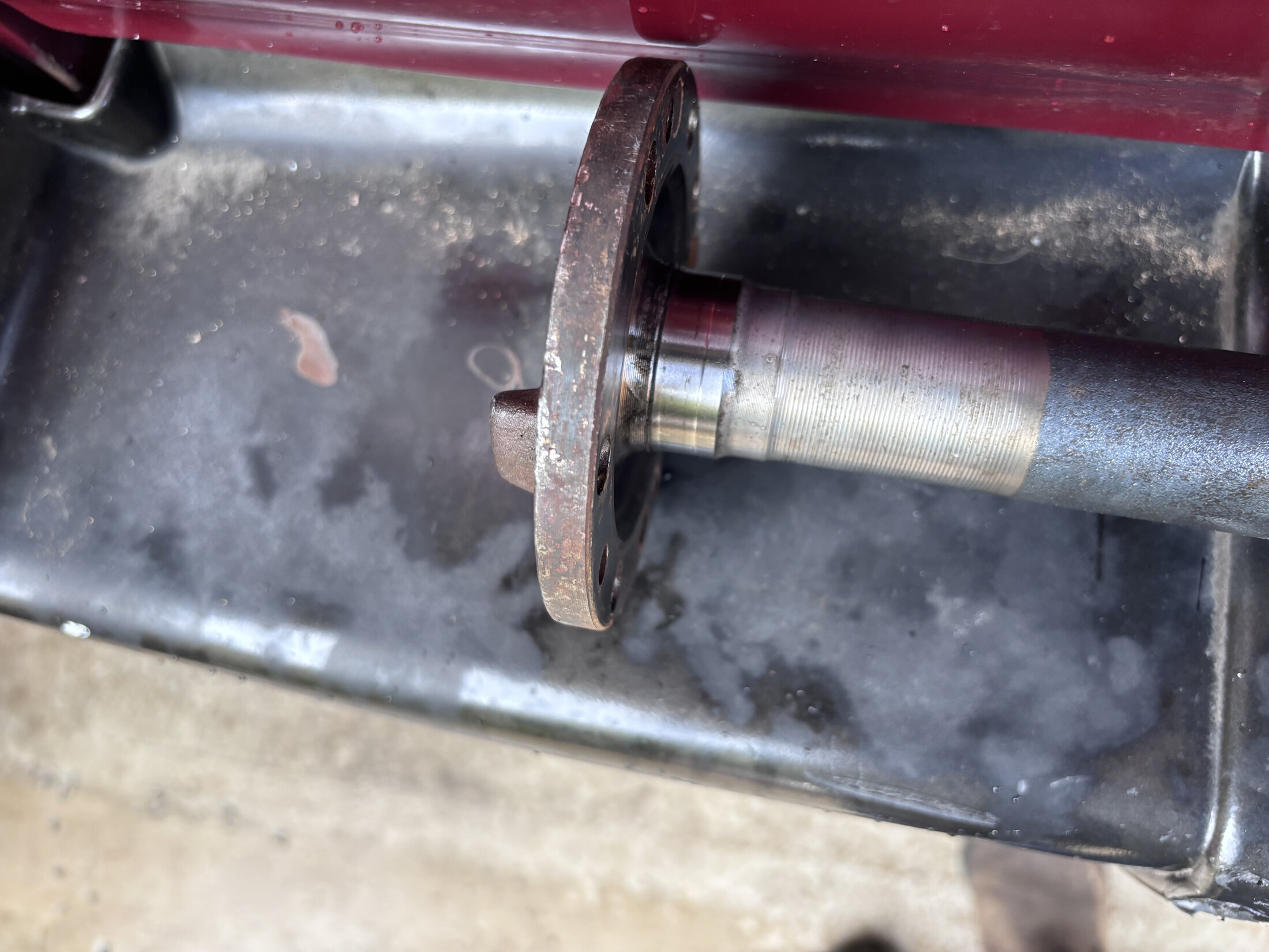

When I freed the shafts, I found they had been running in diff oil for some period and the seal prevented an external leaks. Here is what the axle ends look like:
Both have a clear bright line in the metal, the top (Pax) will slightly catch a thumbnail. Th Driver's side will not, on both sides to my thumbnail the lie marks a transition from a rougher outboard surface to a seemingly polished inner surface.
Is this going to be an issue with the new seal?

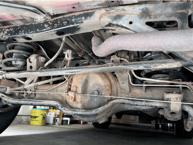

What level of rust does your truck have on the underside? Does the rotor turn freely? If the handbrake is misadjusted it can make removing the rotors difficult to remove however, you would have likely noticed a noise while driving if this was the case. Make sure there is no tension on the handbrake cable and beat the the rotor with an hammer or mallet from all Sides and it should break loose.
I do not know how to gauge the rust. People around here (DC area, think it is rust free), Elsewhere? There is only on spot of body rust on an front inner fender panel which will be addressed when we do the interior.
I have released the hand brake, is there another place to release tension? My father (the owner) always likes the e-brake over tight IMHO and I can easily see the mechanic to something silly to appease him.

It has been cleaned up, but here is what the rear underside looked like in the beginning of this process:
