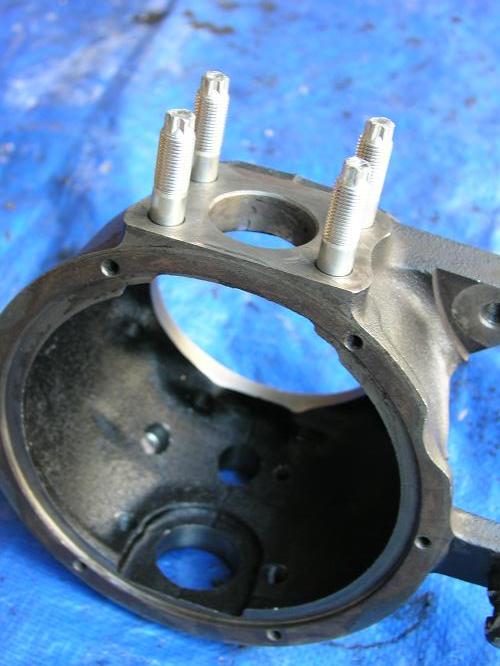

Anything else i should get as opposed to OEM?
Technically it's still OEM but you should upgrade to the new OEM Knuckle Studs.
OLD
NEW

Mark, good point.. NOTED and on the list!

"Rear is done. Ready for the tires to go back on. Front diff is done, parts all clean and painted. Knuckle studs replaced with new Toyota ones. Wheel bearings and birfs are repacked. Marlin front axle seals are in, knuckle bearing races are in. Just need to pack the knuckle bearings, put the front diff in, and put the front end back together. Also need to do the belts and grease the driveshafts."
