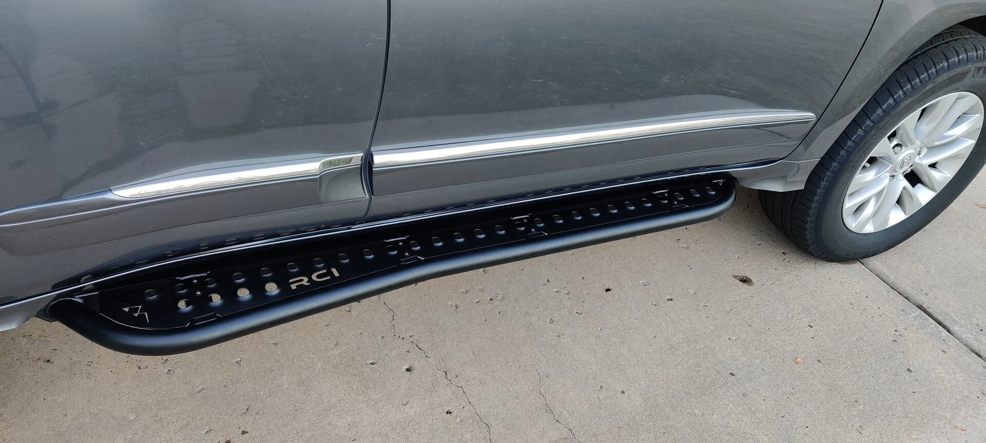

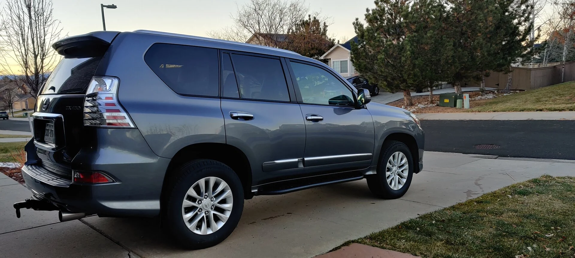

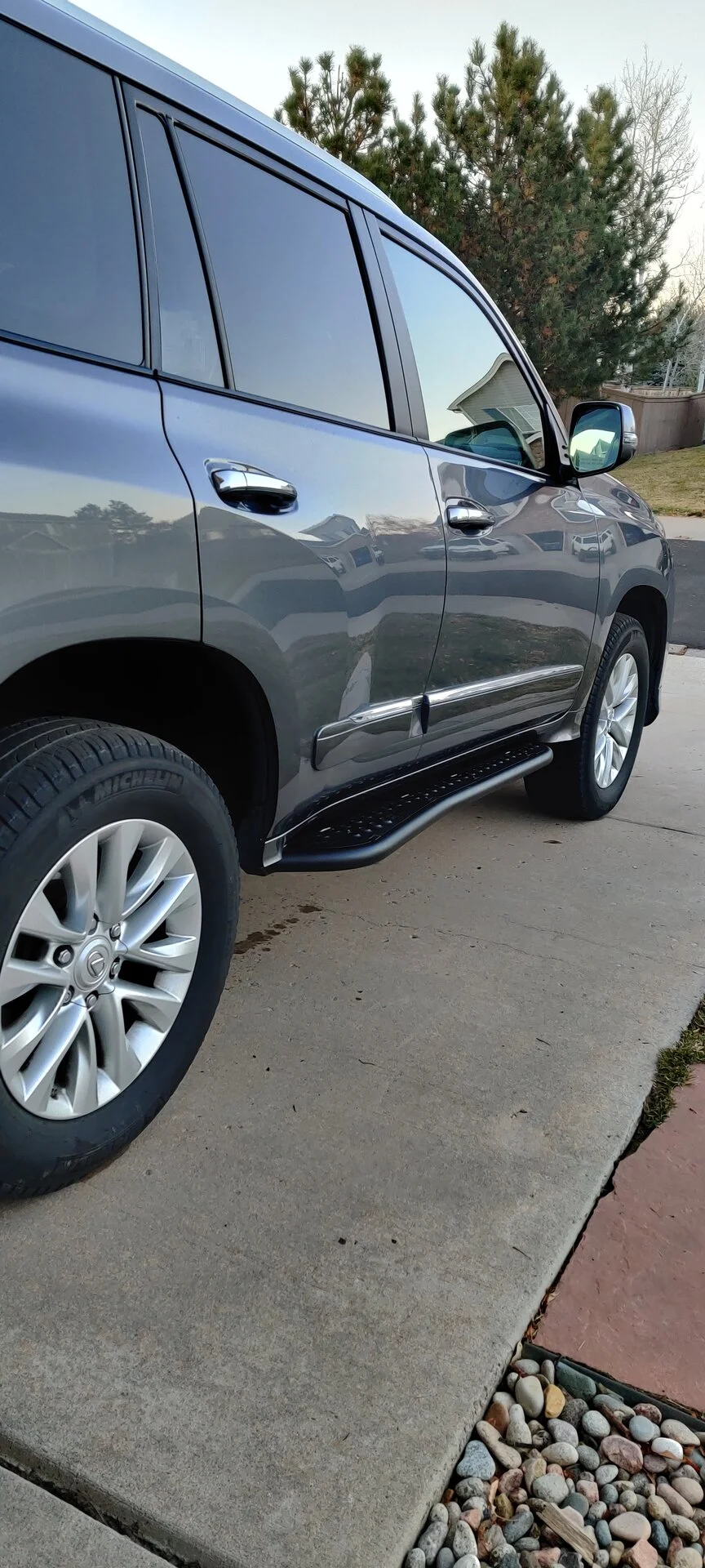

I went a little higher with the trim.. it eliminated some of that flared out look. There is also a little up and down room on the frame with the sliders to keep it away from the trim piece.
I made my initial trim at the referenced 4" and 2.5" but ended up trimming a little more.
Dremel with cutoff wheel and sanding wheel worked awesome for the job. Small rough hand planer worked to straighten the cut after.
That looks just what I'm looking for. Would you have a chance to measure how far down you ended up on the front and rear? That would be very helpful. Also, did you fit the puddle lights or remove them completely? I haven't looked at what it takes to make the lights work just yet.

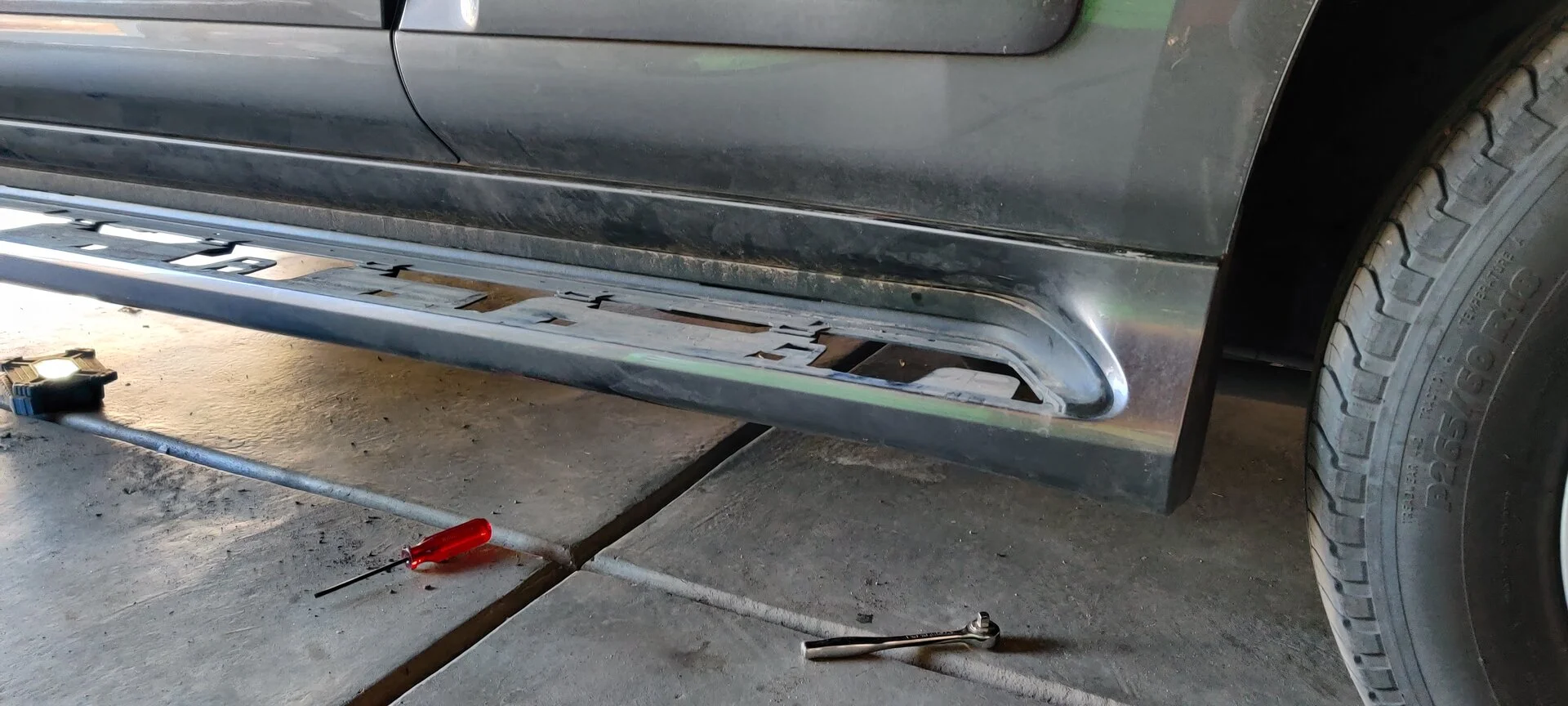

Measured my cuts... 3-3/4" on the front and 2" flat on the rear. It starts getting into a flatter underside piece going much further. You'll see once you start trimming.

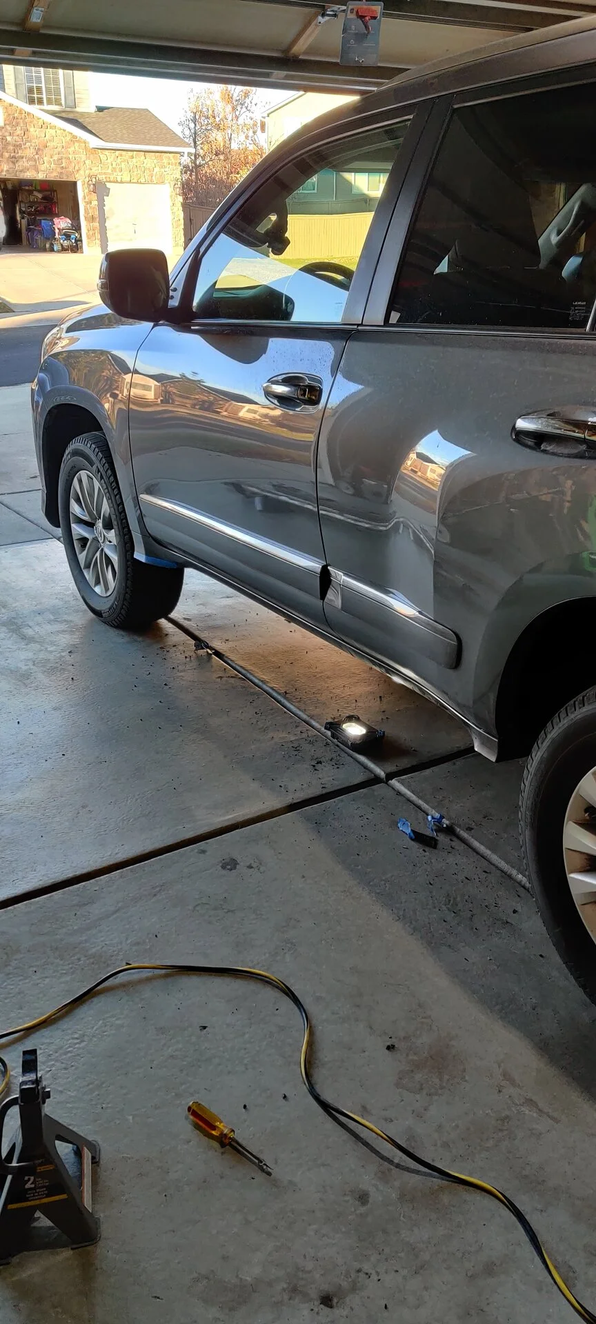

I removed the puddle lights completely at the connector, taped up the connector and zip tied it up. I saved everything for mounting at some point. Future project I guess.
FWIW, i found it easiest to disconnect and remove all the running board pieces while still attached and leave that trim piece attached the whole time. Then cut.
