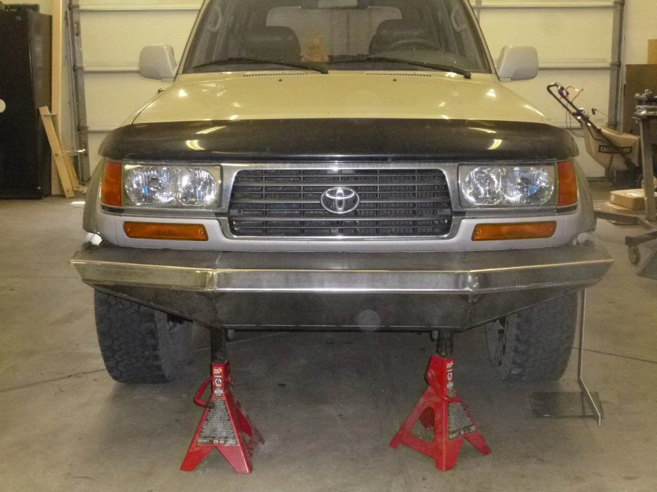

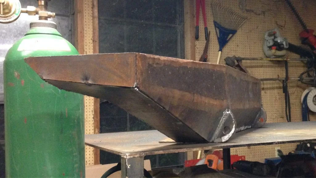

Moar pics with the bumper mounted. I still got some work to do, but here it is.

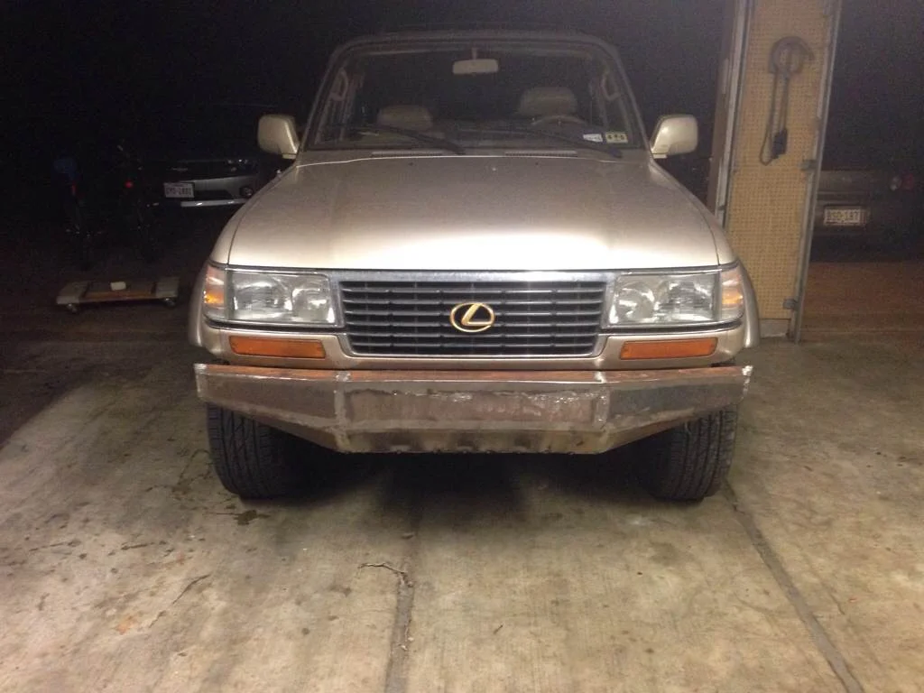

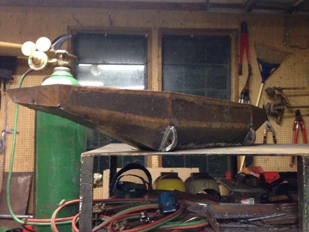

Got another oxygen bottle for my torch, and went to it. I've learned so much from this project; I like the bumper, but I think I can do better. Once I get it sandblasted and painted, I think I'm going to make another one with a more aggressive angle on the wings. It looks sort of boxy for my taste.
If anybody wants this one, let me know. If not, I'll probably scrap it.

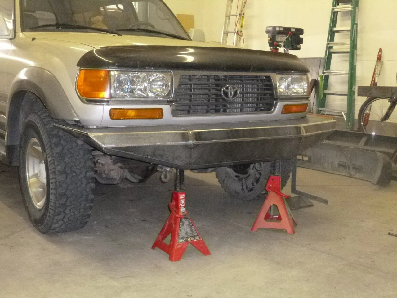

Welded the top part of the front face.

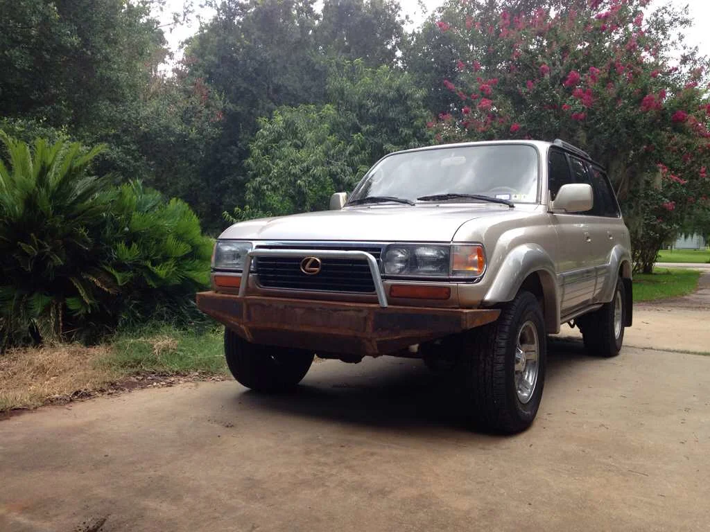

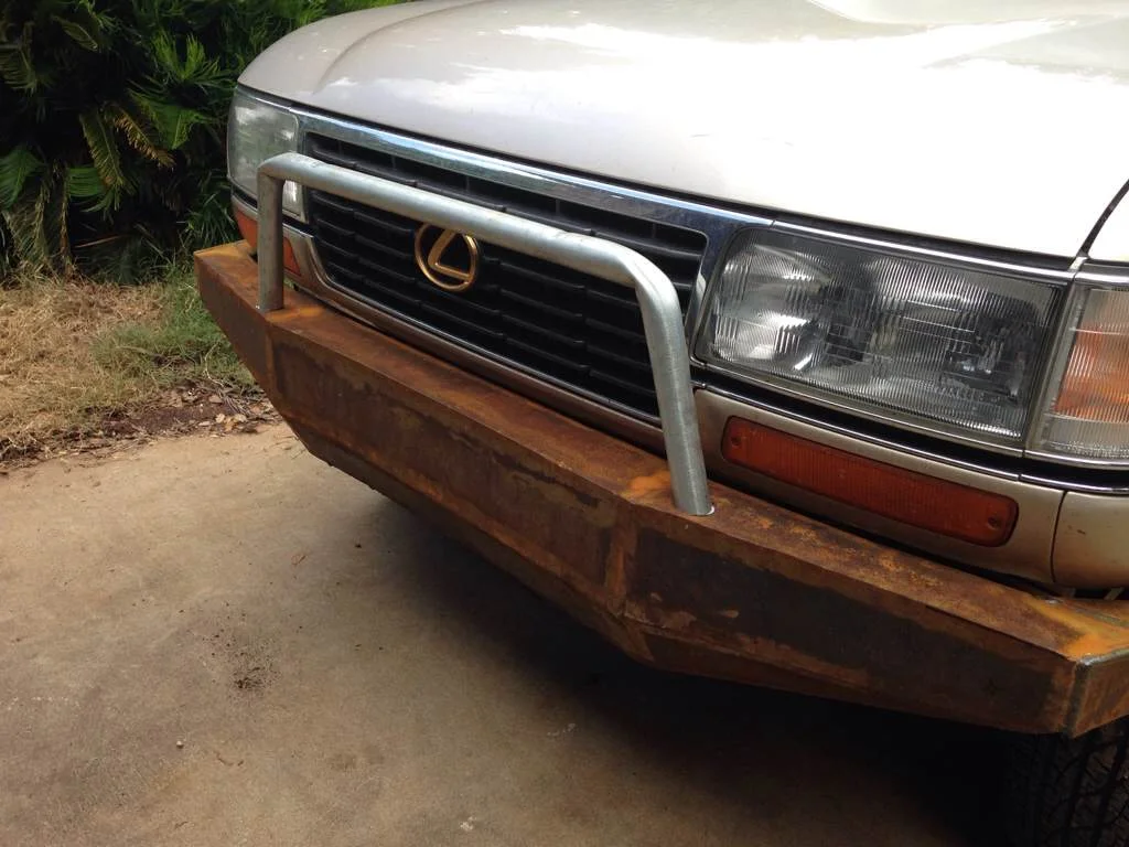

I have a pipe bender and some schedule 40 pipe to bend for the grill guard. Say what you want about schedule 40 pipe, and how you think drawn over mandrel .120 wall is better. I'm using pipe. :flipoff2:

I could use some help with the grill guard. I want something to protect my grill from other cars when i ram them off the road, and I need your help.
Here's the blank.
And here is me brainstorming.
Looking good. I see you ground all the welds smooth so it won't have that oil field look to it. I say don't reinvent the wheel. Take a look at other bumpers out there and pick the style you like.

I just welded up the corner pieces just now, but I'll be grinding everything smooth. The oil rig look gets old quick, and the grinding got easier when one has a 7" grinder with a few stones. :D
I wasn't sure that I was going to like stick welding when I started, but now it's my favorite.
The pictures skipped an integral part of my trial and error. I ended up taking a bit off here and there, adding some things, and working with the design. I haven't weighed the bumper yet, but I don't think it weighs more than 70 lbs. I also measured my approach angle with the stock 265/70/16's, and saggy 18 year old suspension, and it's still impressive by my standards.

Yesterday, I came to the conclusion that 1" pipe isn't going to be a large enough diameter. I need to go back and get 1 1/4" pipe for the center grill guard, and I'll use 1" for the support pieces that protect the headlight/blinker area.

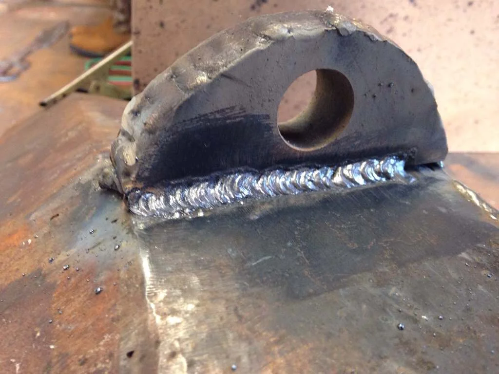

Update: Welded up the new winch plate, the tow points, and added the bottom pieces to the sides, because it just didn't look complete with out it.

This was done with 6010 for penetration. I beveled the edges before I made a pass. I'm thinking about running a bead of 7018 over it.

And my rig on 35's now. I also had a chance to test the integrity of the welds on the D-rings the shackles are on. I yanked out a 3/4 ton Chevy with the left one. :D
