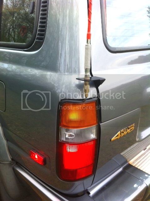

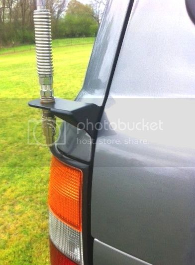

Anyway...I have the 'yodaTEQ' mount which situates the antenna base just above the rear tail-light.
With this arrangement...it looked simple enough to run the Coax from inside the Vehicle's Jack/Tool compartment, through the tail-light bucket and then notch the very top of the tail-light bezel to give the Coax a straight shot to the antenna mount.

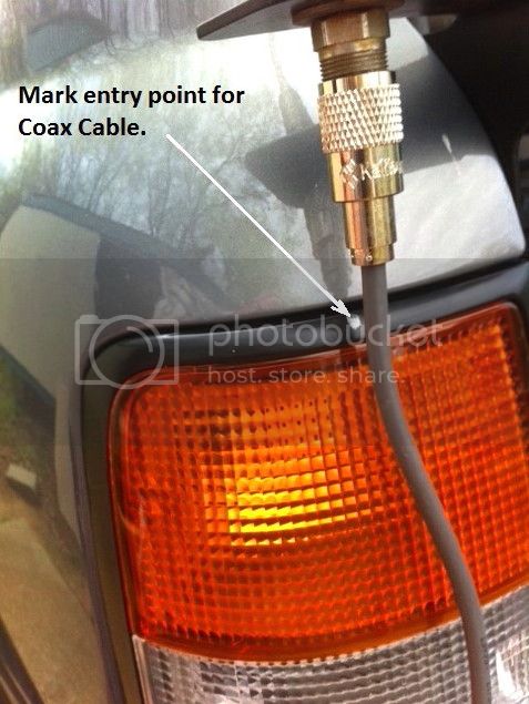

  • Mark the spot on the tail-light bezel for the cable to pass through. It needs be high enough to miss the sealed portion of the tail-light fixture.

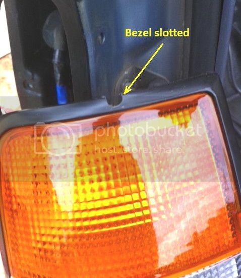

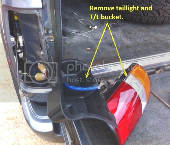

  • Remove the tail-light and fashion a small slot in the bezel (about 5/16” should be plenty).

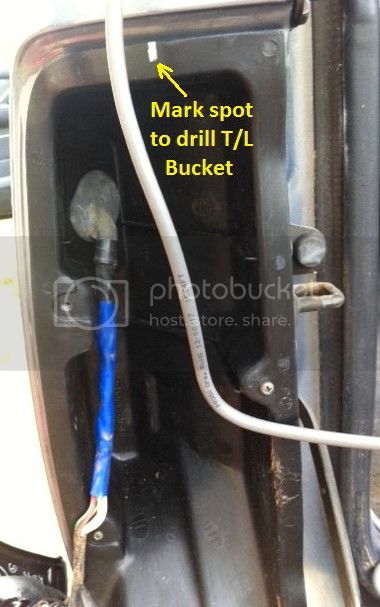

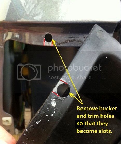

  • Hold the tail-light up in place and mark the tail-light bucket using the slot you cut in the tail-light bezel.
  • Remove the tail-light bucket and check to be sure there are no wires, connectors or other items in the way for the hole you are about to drill.

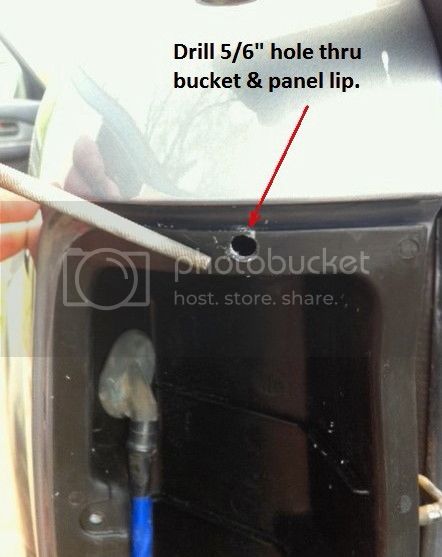

  • Reinstall T/L bucket and drill a 5/16” hole through the bucket and the panel lip behind it.
Continued next post:

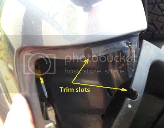

Next...remove T/L bucket and make 'slots' out of the holes you have drilled. This way you can remove the items (tail-light, bucket) individually. I found that a pair of diagonal cutters easily removed the material from the bucket as well as the panel lip (the metal is thin there). Dress the edges with a file.

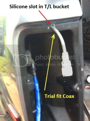

Reinstall tail-light bucket and check Coax for fitment. Then seal over the top portion of the T/L bucket and the slot with silicone to prevent water/dust/dirt from entering.
Replace tail-light. You can put a dab of black silicone around the slot if you like (I did not), as I don't see it being necessary and I did not want to have to peel the Coax away from the light fixture if I ever need to replace a bulb.

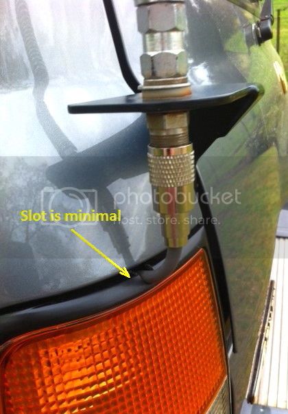

The slot in the T/L bezel does not affect the strength of it and frankly is barely noticeable. It makes for a very clean installation of Coax if you are willing to go to the small trouble of doing so.

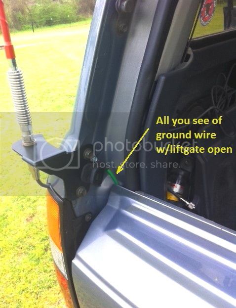

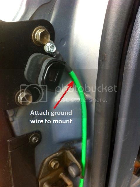

Lastly...IF you need/prefer to run a ground wire from your antenna mount (if like mine), then you can conceal it fairly well also. I attached mine to a spot where the mount replaces the tailgate latch. Then ran the wire straight down to the frame. It barely shows at all when the lift-gate is raised and doesn't get in the way or interfere with the closing of the tailgate.
How do you prevent cable chaffing at your penetrations?
I put a few wraps of electrical tape around the Coax where it passes through the Tail-light bucket and panel lip. But the silicone sealant I put around the slot in the T/L bucket holds the cable firmly in place. You could also make the slot in the bucket a bit larger if you wanted and install a small rubber grommet but I am confident the silicone will hold it nicely and prevent any rubbing/chaffing.
