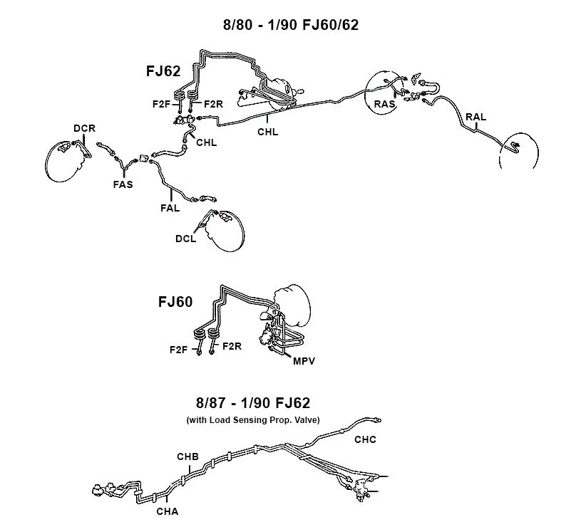

OKay. Make sure when you send these to label them somehow. Give me a clue of where they're mounted. I've started a diagram for them. I'm using the same nomenclature as the others with the 60/62 marker with them. Here's the image:

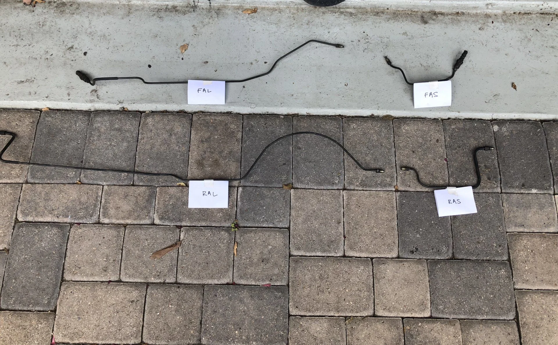

I’ll be sure to label them. The two I have pulled right now are FAL and FAS. I’ll try to pull RAL and RAS and see if I can box them up in the same batch.
I've learned the hard way that the SOR diagrams aren't necessarily correct. It's the only source I've found for Toyota diagrams though. After all this time, I got a 12/77 FJ40 with a unique chassis line. Nothing like any line I've sent or received. I've done a number of right around '78s and never came across this one. So I'd REALLY like to know what SOR got wrong assuming the 60/62s have almost all lines the same.
Well, let me see if I can pull them off the 60 soon so you can have them all side-by-side. The front lines are visibly different on my 1985 FJ60 than they are from my 1990 FJ62 and 1989 HJ61. The 61 and 62 are the same.

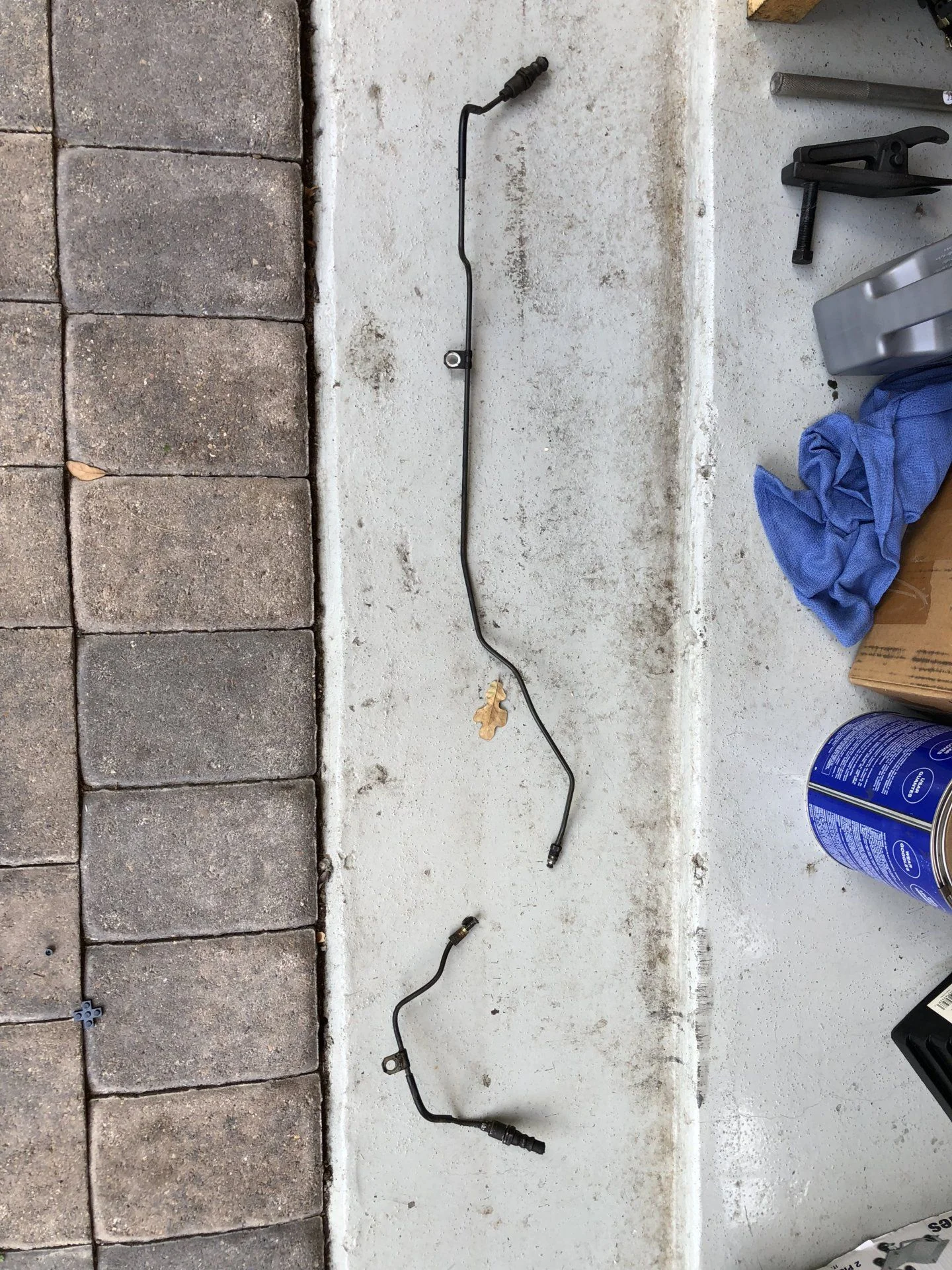

Here are the hard lines from my 1989 LHD semi-float rear axle HJ61. They are visually identical to the lines off of my 1990 FJ62.
They are in the mail to @Rainman as we speak.

If it wasn't confusing enough before, now it's even more confusing. That sight shows date changes different from what I've known these past several years. It also doesn't include all the different changes for the different lines. For instance; it gives a part number for my CHL that covers 9/71 thru 8/75. That's a legit span. But that's it. No other time periods. The other years had the line only a little different. Where are they?
Granted, SOR's list of diagrams aren't completely correct. We've proven that but I'm not sure this will fix their problems. Honestly, thanks anyway. I'll study it some more.
