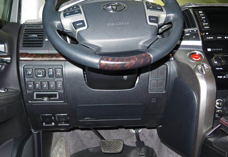

The buttons to the left of the wheel are just silly. The good thing is, the right side is completely empty for auxiliary switches. My Tundra had a few on the left and a few on right.
They seem to be fickle with where they put buttons... My 2008 uses two of the right-side spots...

I know this is off topic but does anyone know what the slot is below all the buttons on the left hand side It looks like it would hold a credit card or something...I didn't look in the manual yet...
I keep my fishing license, coffee punch cards, and the occasional parking garage ticket in that little slot.
I heard it was for an electronic toll dealeo in Japan?!?!
Is that a retractable cubby? I don't have that in my 2011.
that's just a random pic I found on the interwebs, not a 200 series:) But I heard that Etc dealeo is what goes in our smaller slot I think? @gaijin I'm sure can shed some light on this?!?!
The manual has it listed as a card holder. The card holder in the LX is located in the driver visor.

Could totally be a card holder and I'm just making stuff up, getting old:)
Well maybe I'm not totally crazy:) Someone on this thread says it's for the ETC in Japan but they converted the spot to a card holder for the USA, who knows:) What is this piece of the dash?
this vid shows what is located in that spot in Japan...
