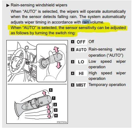

You can adjust the sensitivity of the rain sensing feature with the inner intermittent wiper dial. The more you want it to wipe in auto mode you rotate the knob up. If you want less wiping in auto mode turn the knob back. Not sure how many people knew this since there were a lot of complaints of inconsistent wiping.
Also make sure there are no air pockets between the glass and the sensor. Usually from a windshield change.

I'm about to disable the sensor on mine, probably will for the winter. The dial on the stalk has NO effect on how they work for me in Auto mode.
