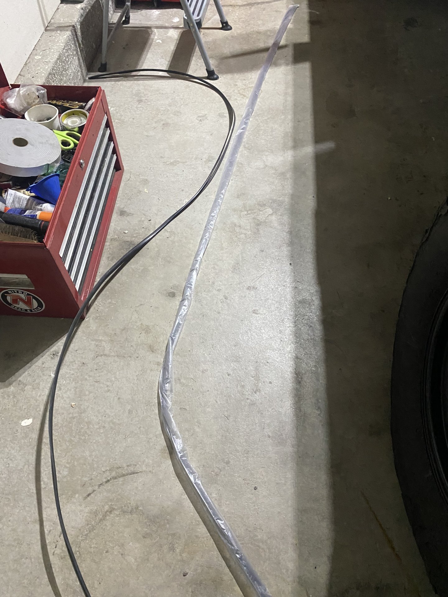

The used one I put on my wife’s was not even close to being straight I believed I just started near the front put the top in place and just rolled down the bottom, then worked my way back, piping it with my palm where it was stubborn. Same way to take them off.

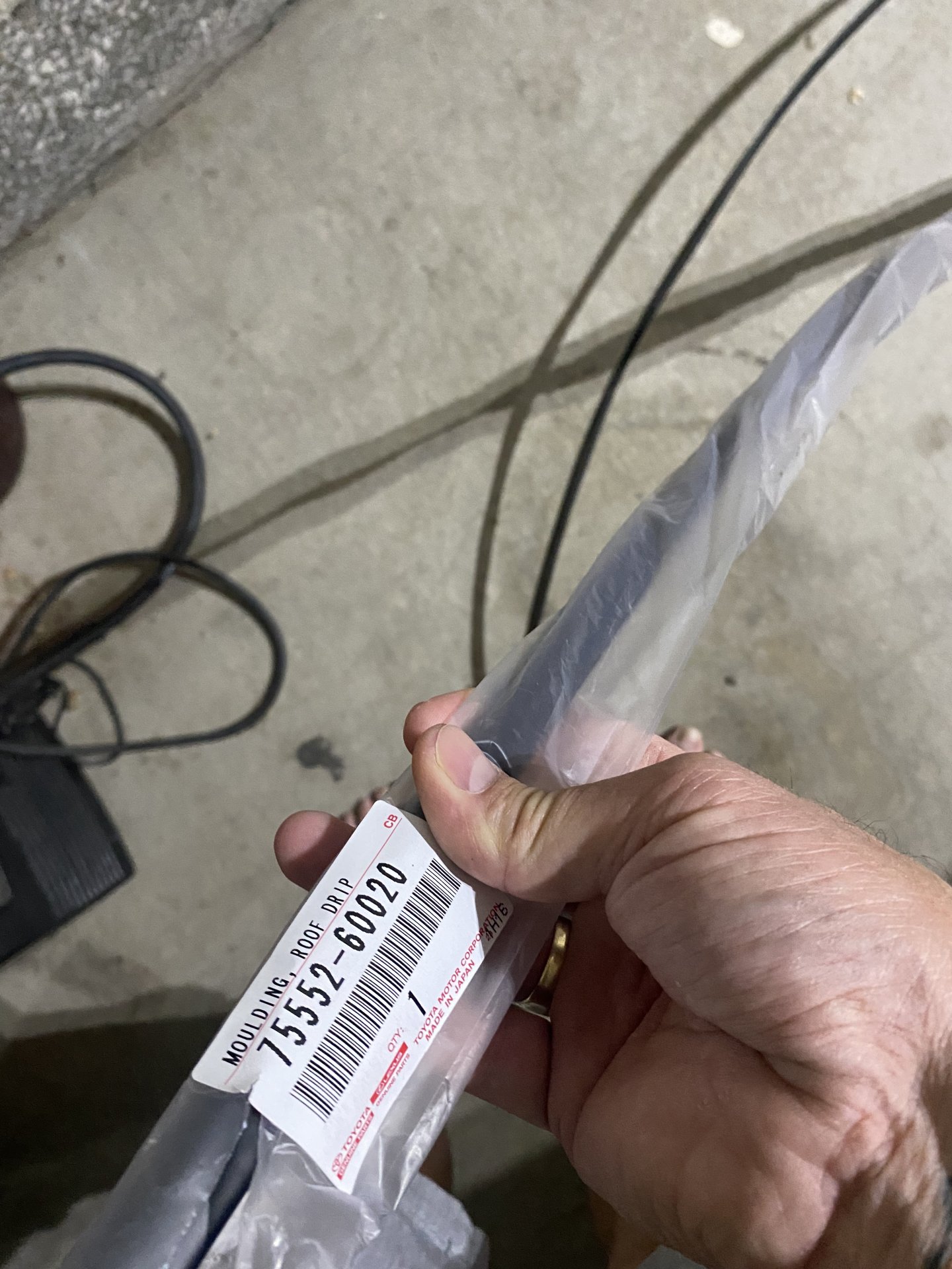

I have a new one as well it is perfectly straight. I’ll post couple pics and p/n.
You just have to be patient once it starts pretty easy
Here is p/n for driver and my used one compared to new. I was able to put my other used on with little effort and it was same shape.
pass side is 75551-60020

I missed post #13 above when it was originally written; the photos show how a new drip rail molding (in the bag) is straight (except for the A pillar section and at the very end by the hatch which are formed sections). The S curved of the used molding is typical of what happens when anyone tries to move one of these by themselves.
FWIW, I have four new drip rail moldings that are bent like in the photo above, and two others that are straight. The dealership parts dept was frustrated themselves as they tried asking the warehouse (SET) to not take them out of their original boxes before shipping them, but no luck.
