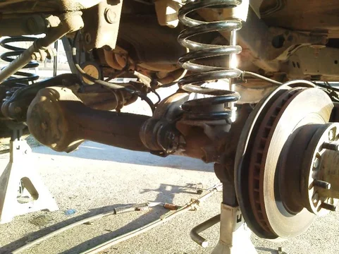

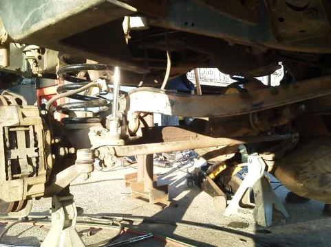

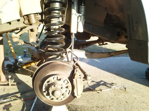

Teaser pics from cell phone.

Brunt Force Trauma said:
NICE! Did you reuse the OEM mounts? I dont think that going to be an option for me since i dont have a cutting torch.
Yep, used same mounts. Worked great.
Just did first road test. PERFECT.
Caster is set to stock, and no wondering on road anymore.
Tires rubbed control arms before, now they clear by an inch.
Write up and pics later tonight.
