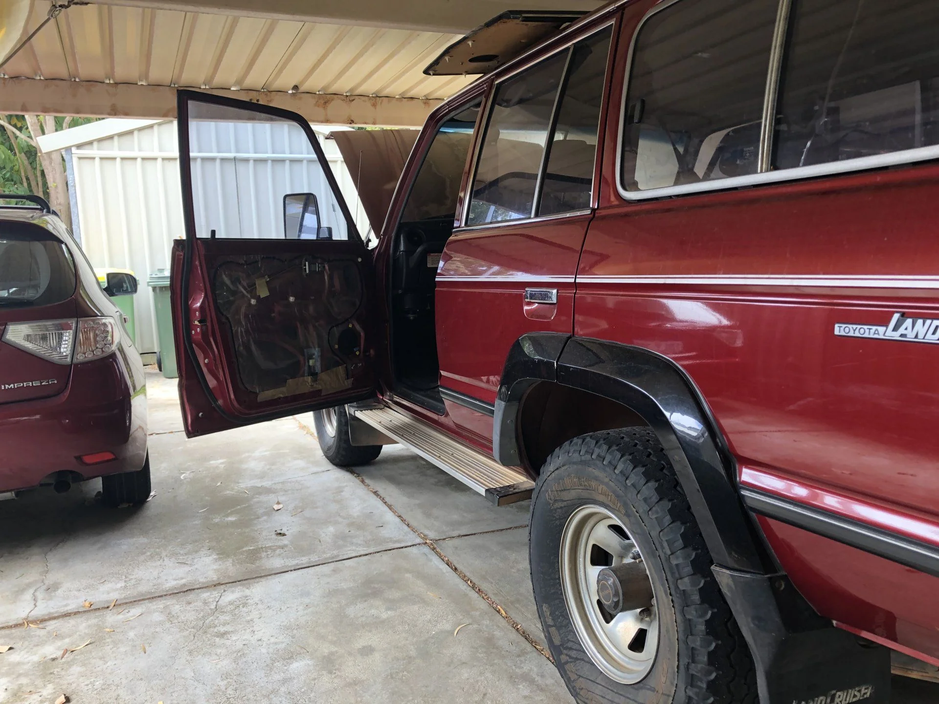

I have no sound to all but one speaker ( rear ) drivers side
have checked all fuses, continuity etc e
volume all the way up = very weak muffled sound from drivers side rear
static when radio turned on and power up pop from I think all speakers

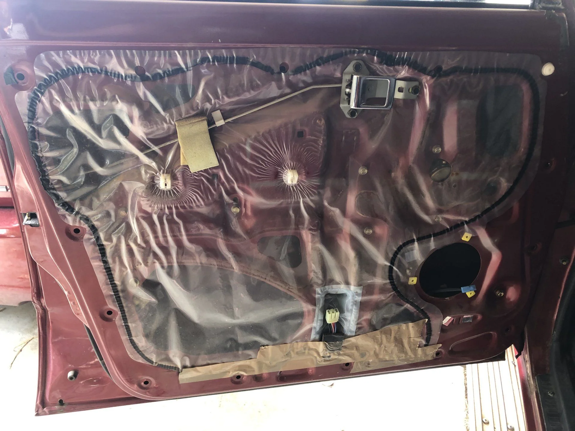

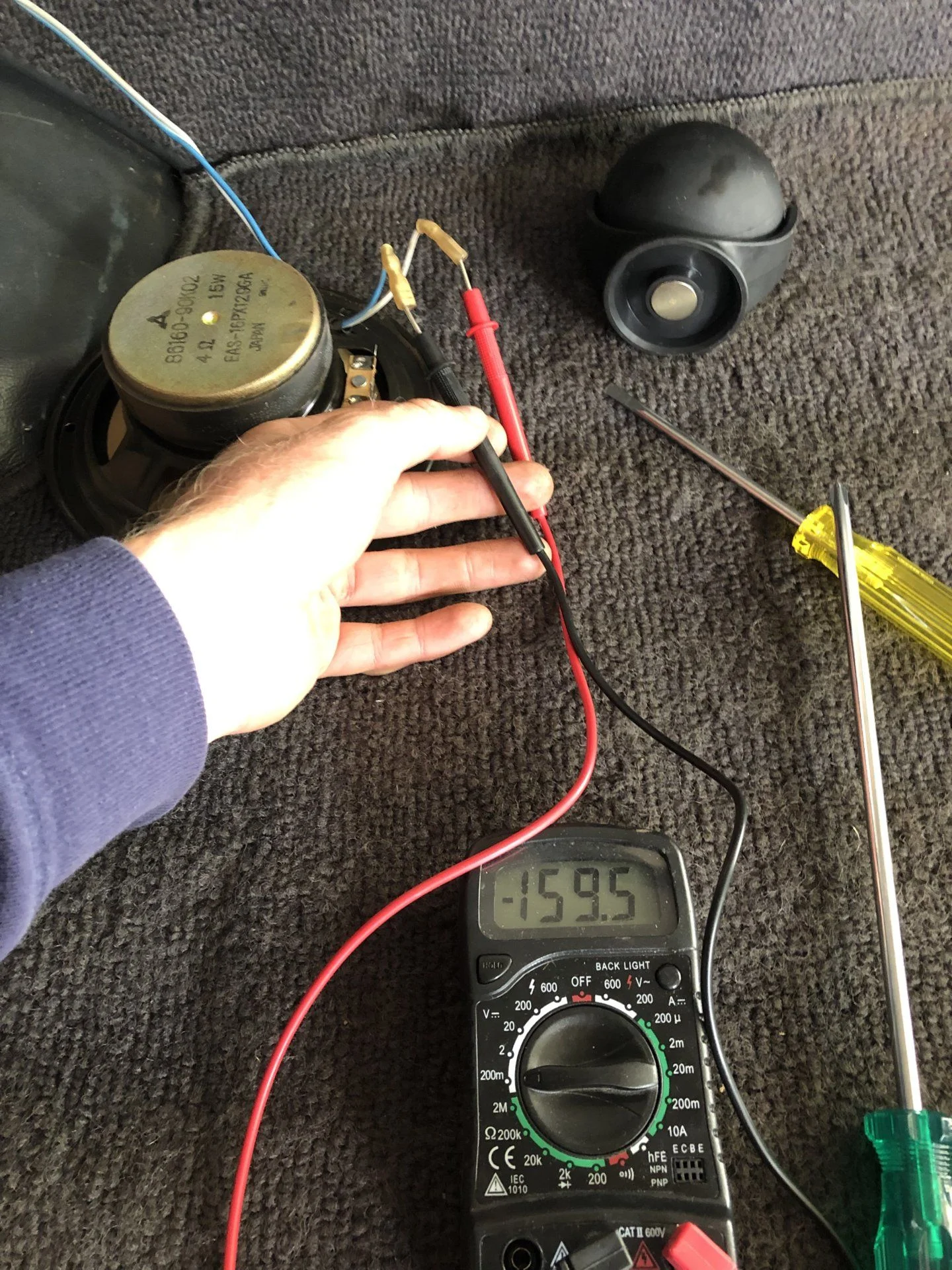

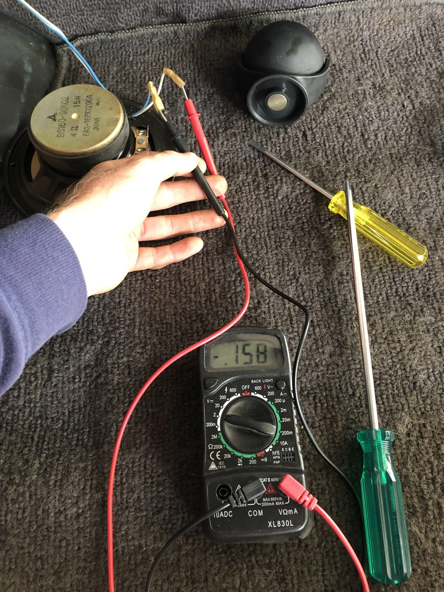

ripped all out and tested with 9v battery they pulsate, connections fine although a little corroded

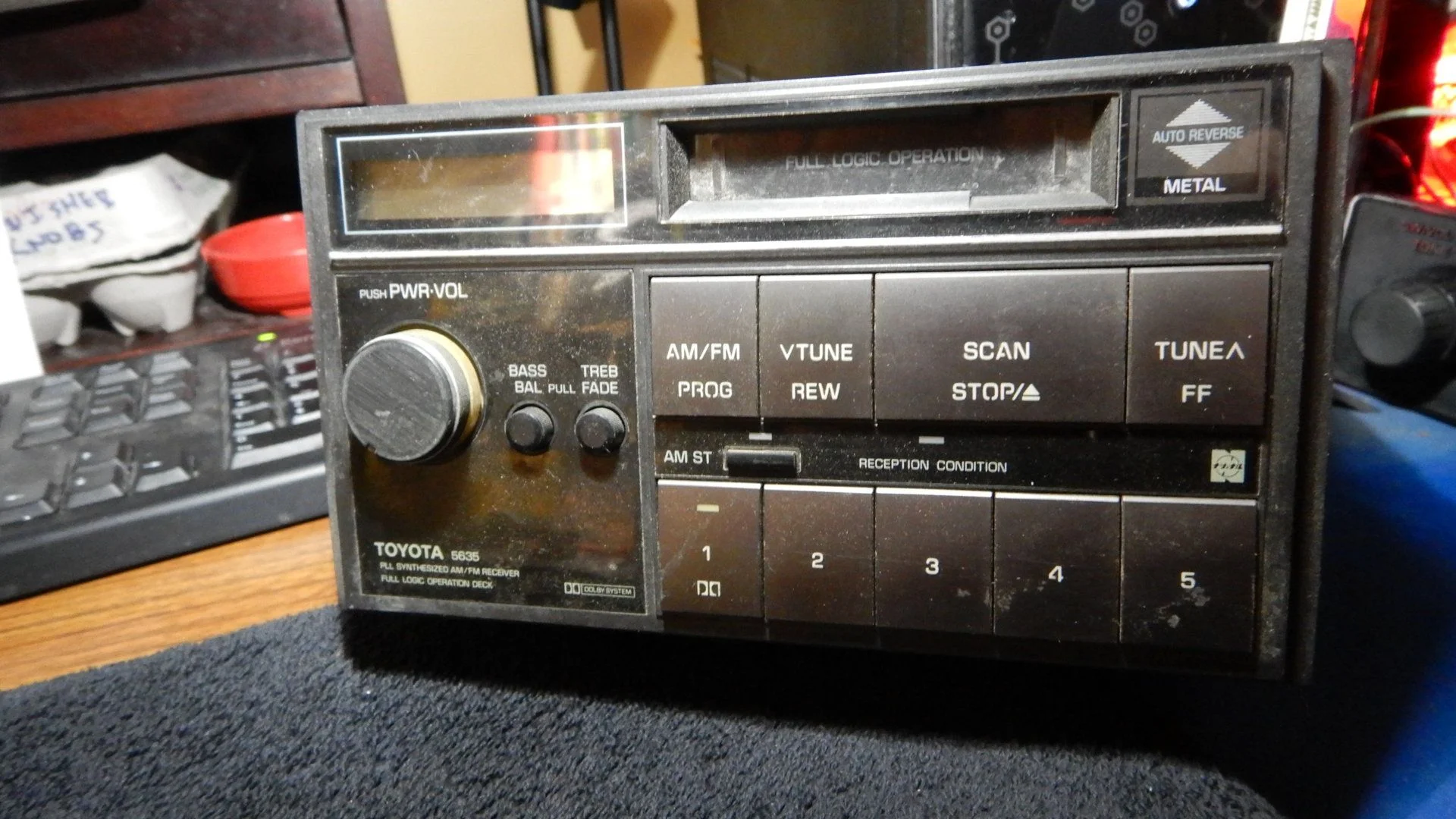

are u still running the Factory Toyota Radio like this ?

Chased an issue similar where I got normal sound in front speakers, next to nothing rear.
Turned out to be the radio.
I wanted to keep my unit stock but ended up replacing with modern.
Haven’t regretted it,
