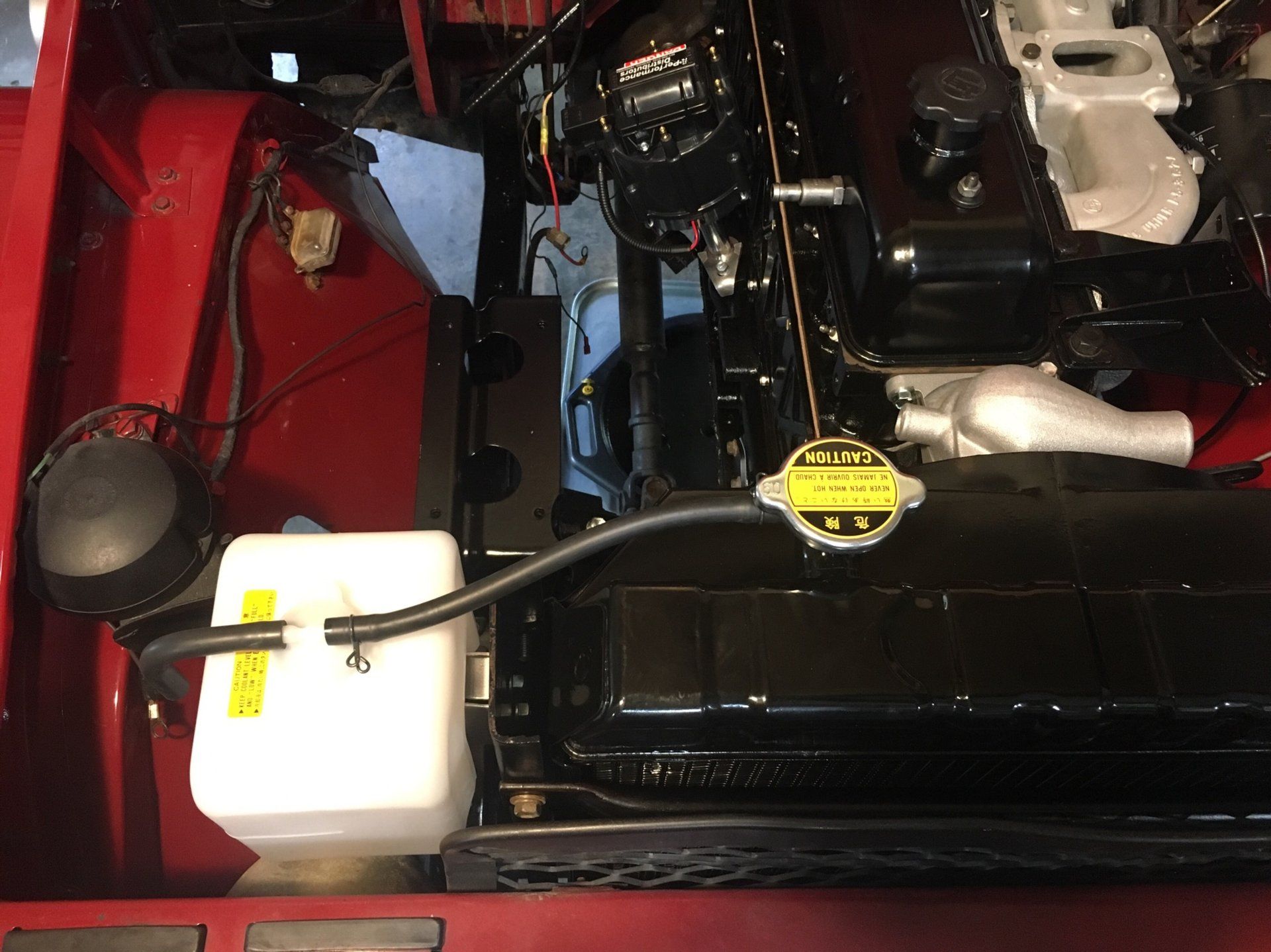

Just put a new Toyota radiator in a ‘69 with a new FJ60 radiator overflow bottle & cap. (nothing present before)
It’s so satisfying to look at a new radiator!
