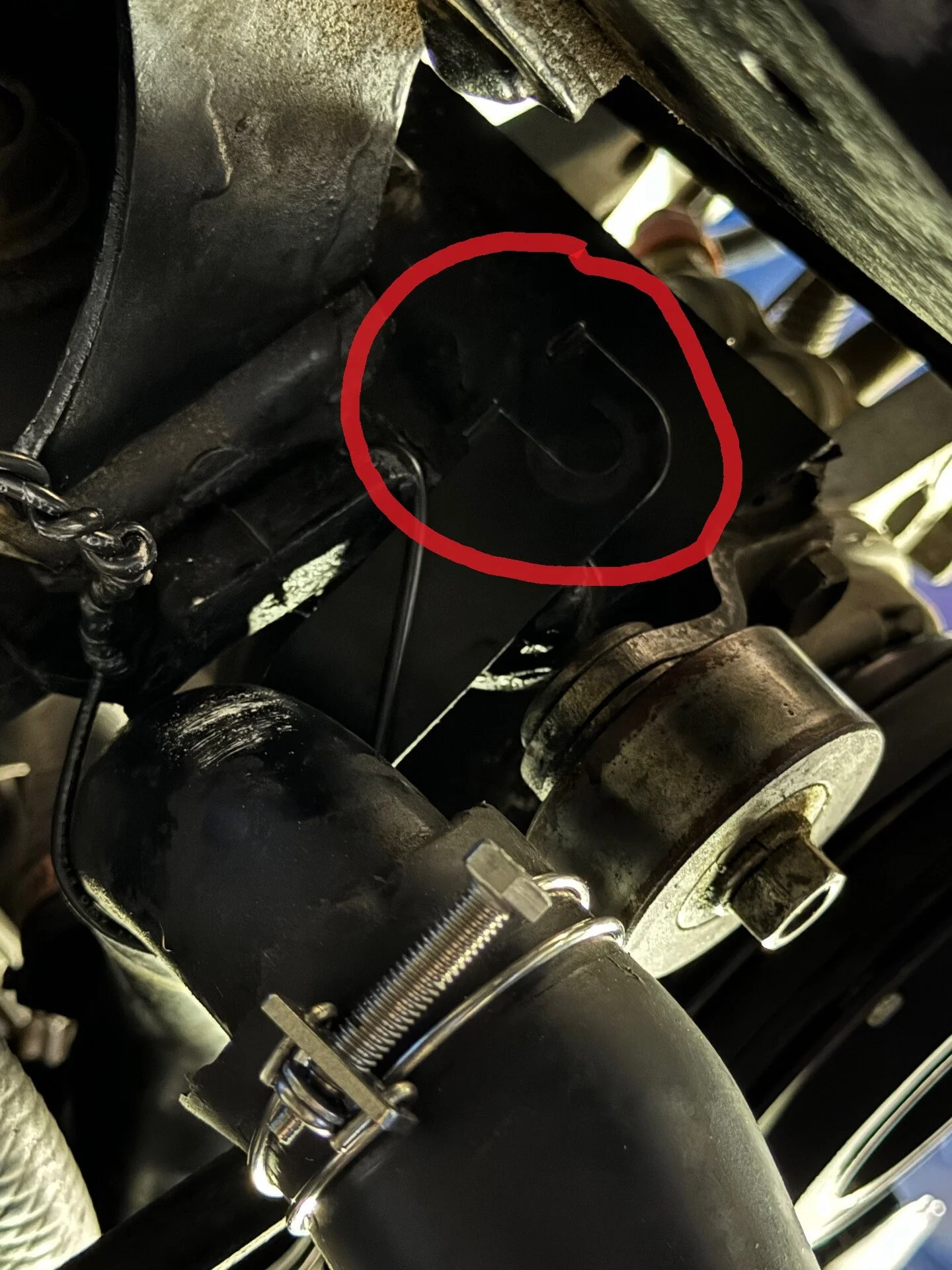

1983 FJ40 with AC. The union pipe has a bracket that looks like it's attached to the motor mount. There looks to be a rubber fitting pressed in to maybe the motor mount that the bracket mounts to. The attachment broke. What part or parts would I be looking for?

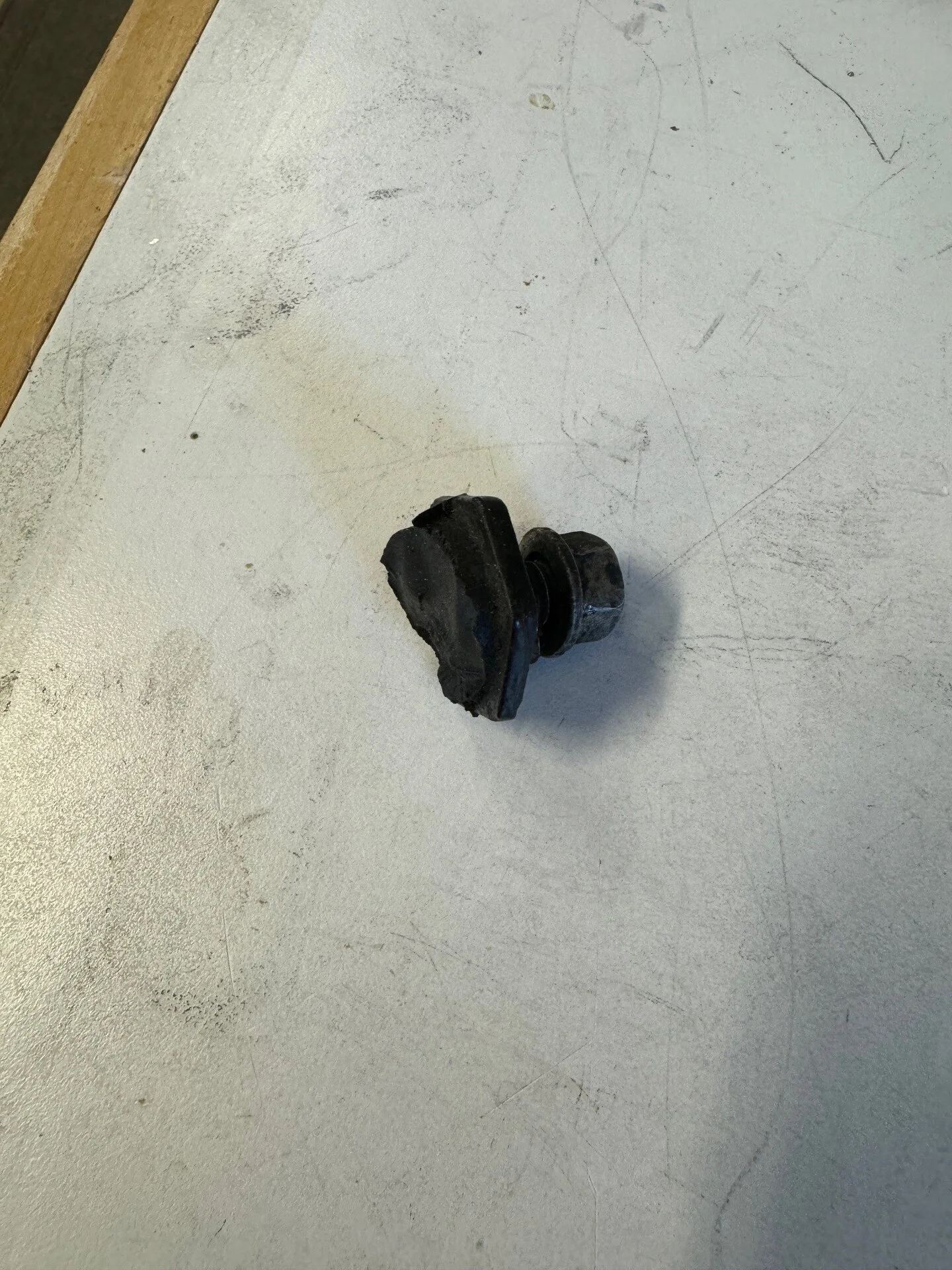

The bracket is circled in the pic. The post it was mounted to looks like it was a bolt mounted in rubber and pressed into maybe the motor mount.

Myself I would just fix what you have. Looks like you could pop rivet a larger piece of rubber in place using the existing cleaned off bolt.

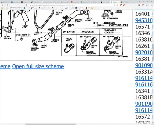

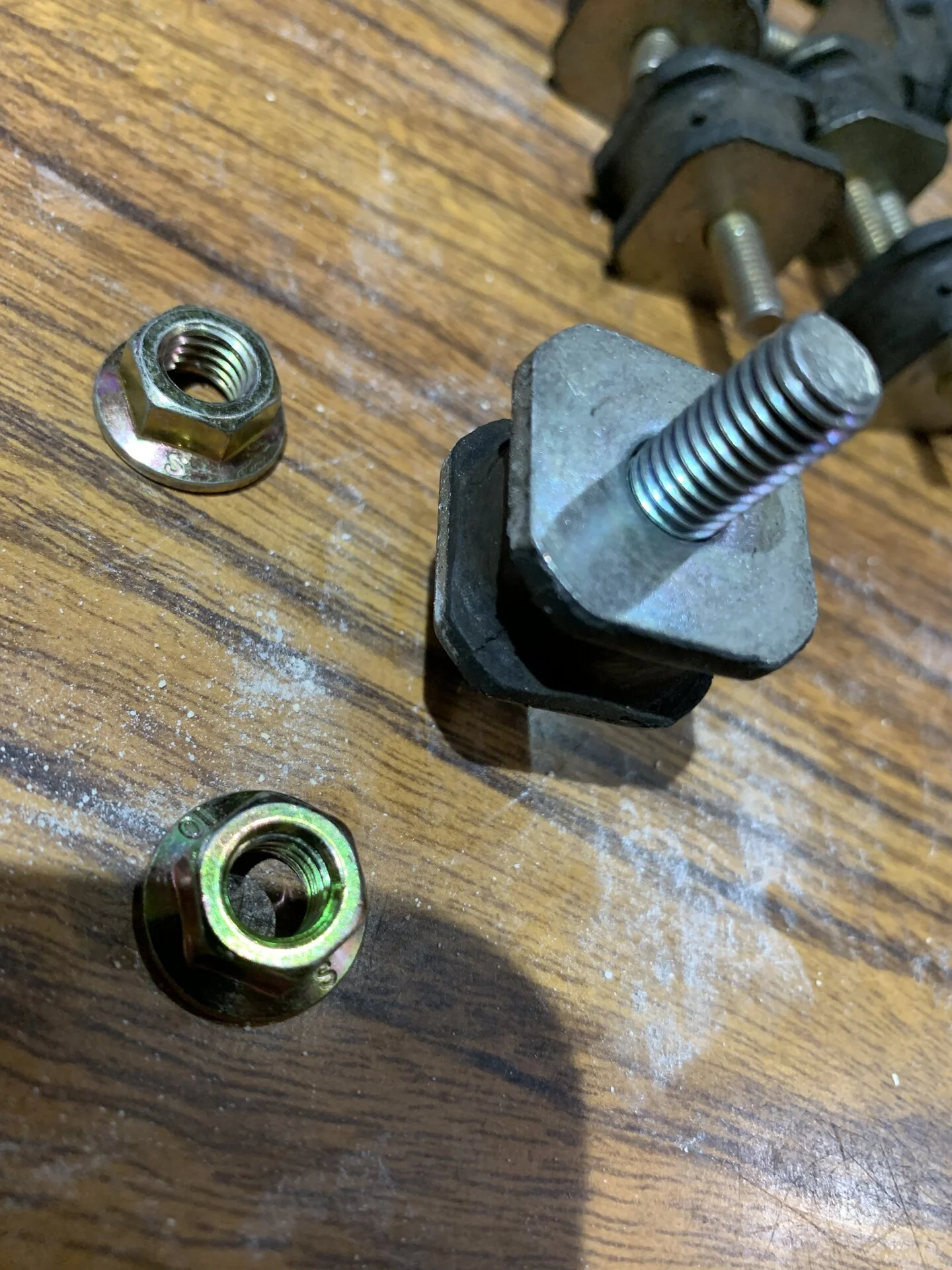

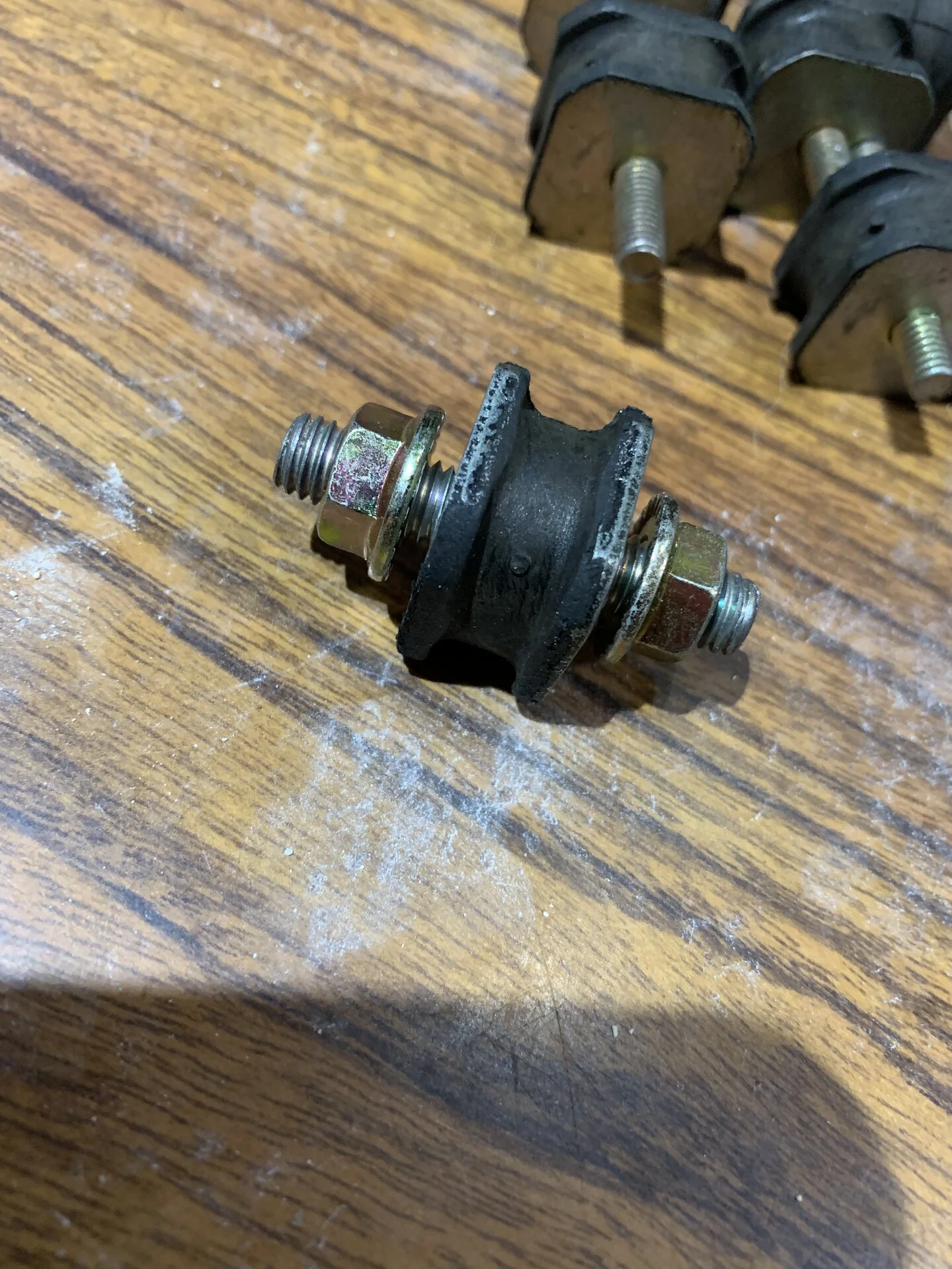

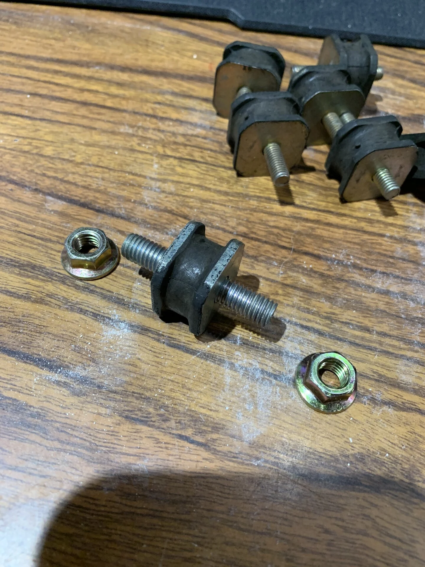

your looking for this NOS insulator & its 2 nuts also ....
